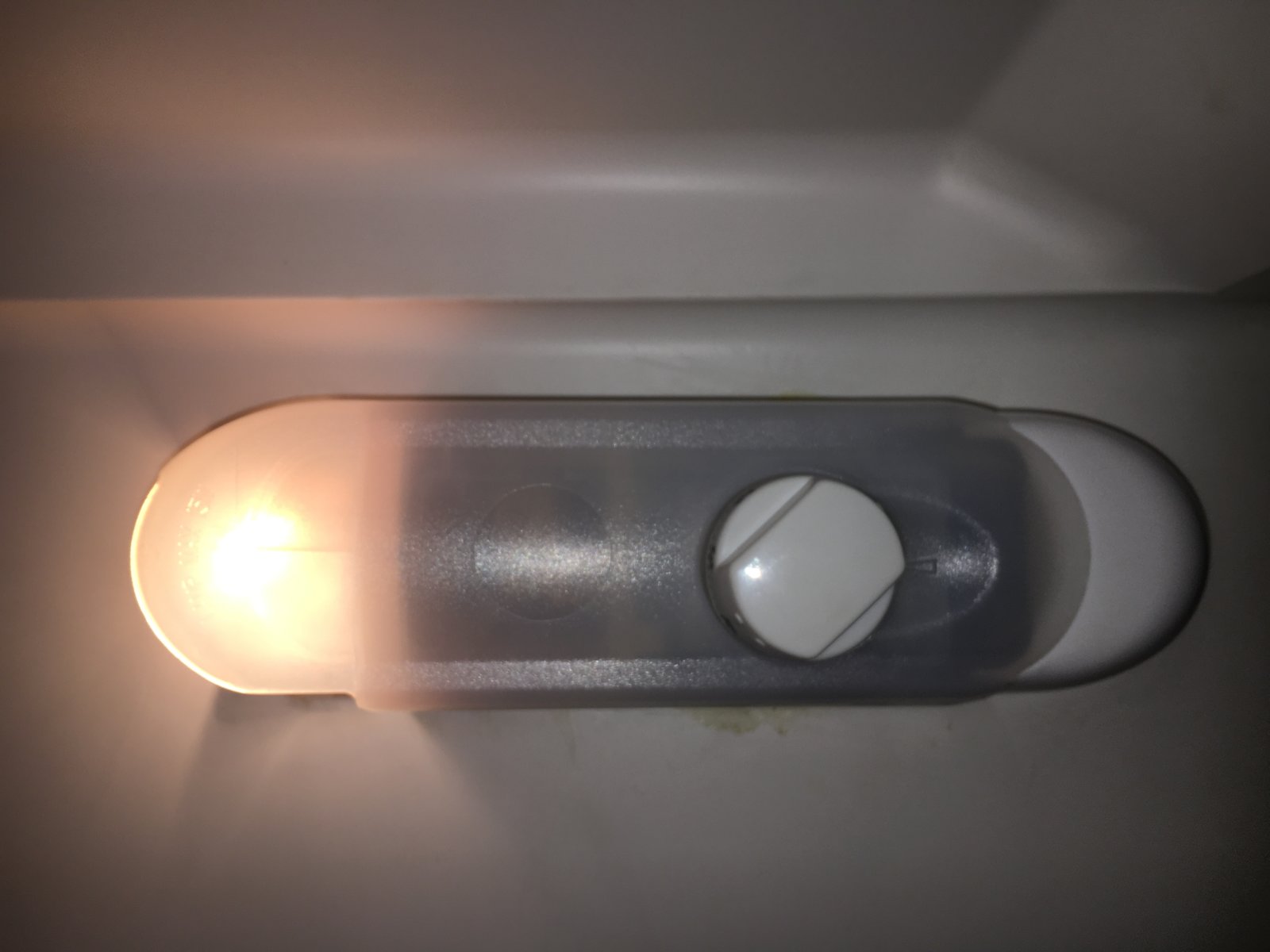

Yes the knob comes off (although it took some forcing off!). It reveals a nut which is very difficult to undo. Here is a picture of the unit itself:
Have you tried squeezing it top to bottom? Maybe it just clicks in with plastic tabs.
Maybe it's not the nut after all. It ought to be pretty easy, seeing as how that's how to replace the lamp also.
Yes. To no avail. Tried to prize it off with a flat-head screw-driver all around the edges of it but it just doesn't budge. Tried pinching and sliding one way or another too.
From my research on the Ignis website... I know you can replace the light switch, the bulb, the bulb housing and the thermostat housing but I just have no idea how all these components come apart from one another without snapping something. Very frustrating as you can imagine...

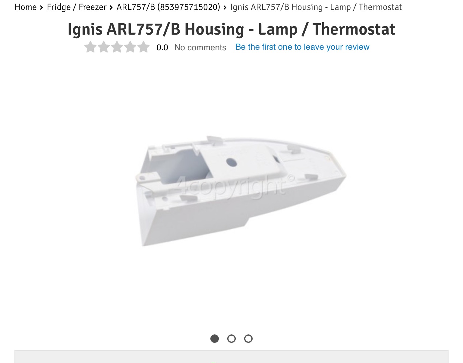

I found this online, which has given me the thought that it must just be held by those 4 plastic tabs which click into the side of the fridge unit.... but there must be a screw also but I have no idea how to get to the screw!
