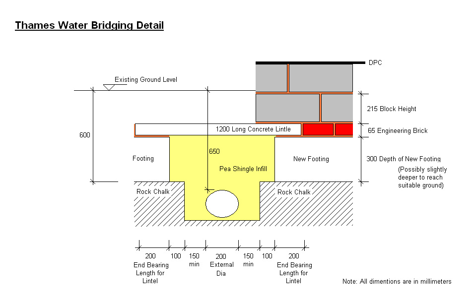

We've got to lintel over a sewer at foundation level, so one lintel under each skin. How do you close the bottom of the cavity?
We haven't dug out around the sewer so it will be sitting just above the earth unless we do anything else. Surely over time it would just fill up with rubbish and start touching the cavity insulation, leading to damp?
What do people normally do with this? Couldn't seem to find any info

Thanks but that's not really my situation, the pipe is buried 1.5m below the ground! We're lintelling over the gap we left (and didn't dig out) for it, so the question is how to seal the bottom of the cavity over the gap.
Wondering if it might be easiest to put another lintel in-between the two lintels for the skins... a 100x65 lintel will hardly cost much. Think we only need 75mm of cavity fill at the bottom but would make it easy to do so

I'm clearly not explaining this very well... my problem is that there won't be a bottom to the cavity as we lintel over the two foundations either side of the sewer. There will be a lintel under each skin of wall obviously but nothing between them, and I'm assuming I should do something to stop stuff getting up inside the cavity from below, as the opening sits below the external ground level because it's right on top of the foundations. Any clearer?

That's how I read it now - Chris has effectively created two pad foundations and is asking how to build a wall between the two? How wide is the gap? can you use three lintels?
I'd have dug down and done it at a lower level so that you have a continuous run of foundation so that theres no chance if differential movement in the two sides of wall.
Yea that's basically it. I just pulled this image from the internet but it's similar to what we're doing.
I have seen people question movement between the two foundations so did wonder, but BCO didn't have a problem with it so that's what we went with.
I think an extra lintel is going to be the easiest way.

When I built my cavity wall over my drains, I bridged the gap with 3 65x100 lintels next to each other. 1 for each skin and 1 for the middle. Then my lean mix below DPC sat all nicely on this middle lintel.
