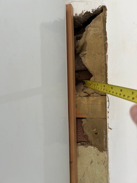

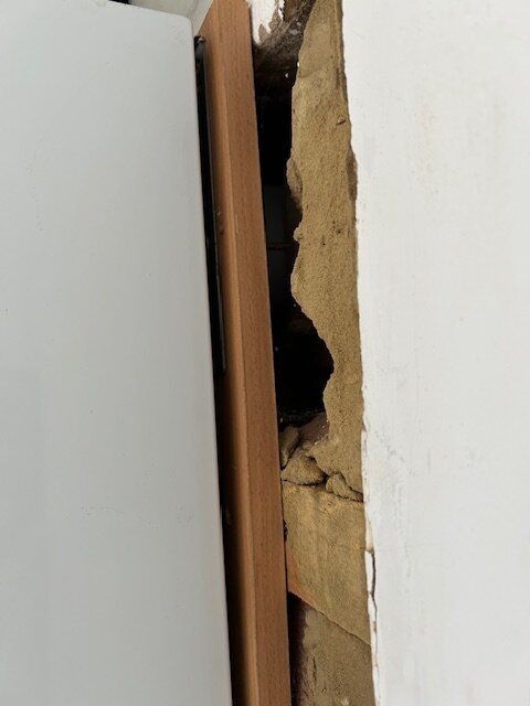

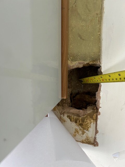

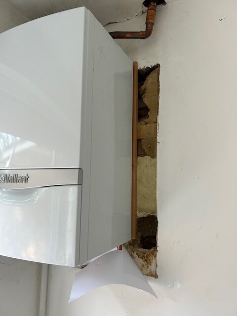

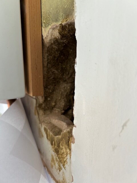

Hi,
I want to plaster over a rather deep hole by the new boiler.
What's the best practice / building material I do need to use?
The two holes are quite deep (see pictures) and wondering whether / how I can procure some rubble and stick on the wall with rapid cement, let it dry and plaster over the next day?
What type of cement / plaster shall I use?
Many Thanks
Postcrete. Mix it up stiff and fill the hole with it
thanks, do you mean no rubbles / stones in the mix?
I can only find postcrete being used for fence holes in the ground rather than on vertical interior wall?
It's "just add water" concrete, suitable for filling holes. It's an easy option for filling holes if you've only limited experience working with/mixing cementitious substances. You could get any similar product
Had similar problem in bedroom of ours when we moved in. Got a tub of Wickes Plaster Skim and Repair (it does not slump), had two goes with it as hole was a bit deep - sorted!
