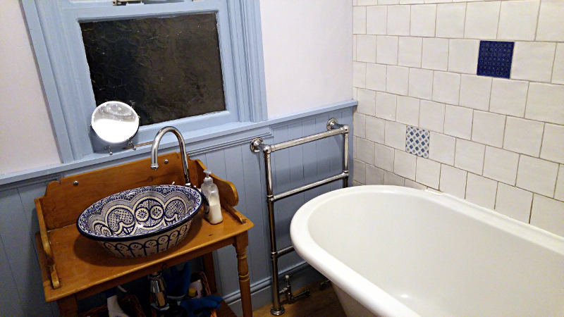

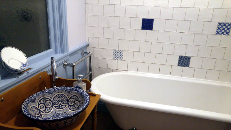

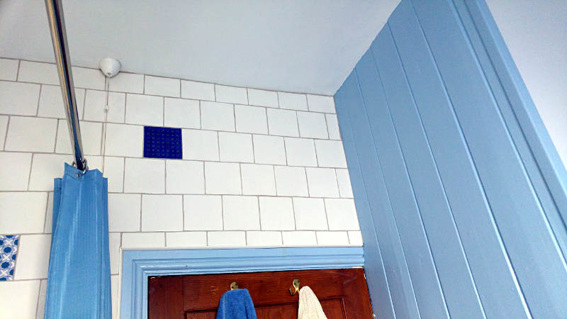

I'm aware this is a resurrection of an old thread but having had questions from forum members about what the bathroom renovation looked like in the end I thought I'd share a few pictures. In the end we went for tiles on walls A and B (referring to the floorplan in the first post) going as far as the hinge of the door. We decided in the end to go for square tiles rather than hexagons and the budget wouldn't allow for the entire wall to have hand-finished tiles so we added a few randomly selected in a repeating pattern against a white background. I rather like the result:
