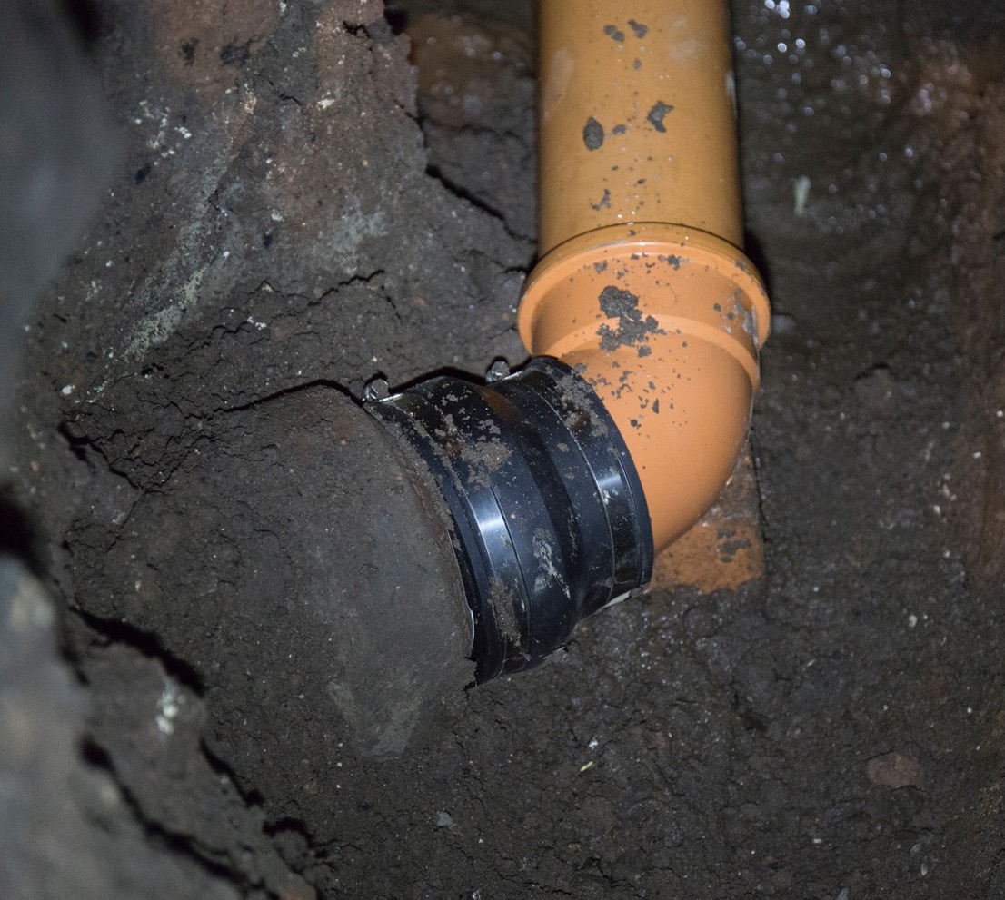

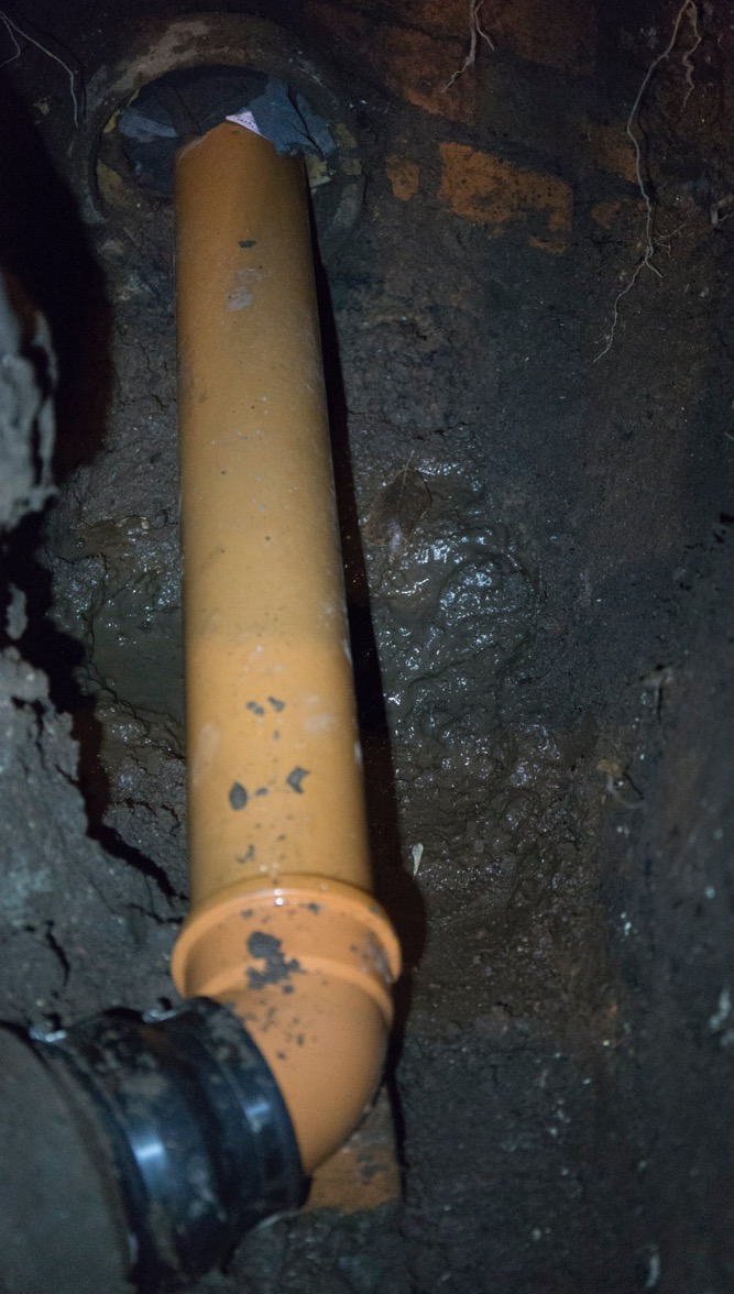

We've rigged up a very temporary solution for now until we can sort something out properly :

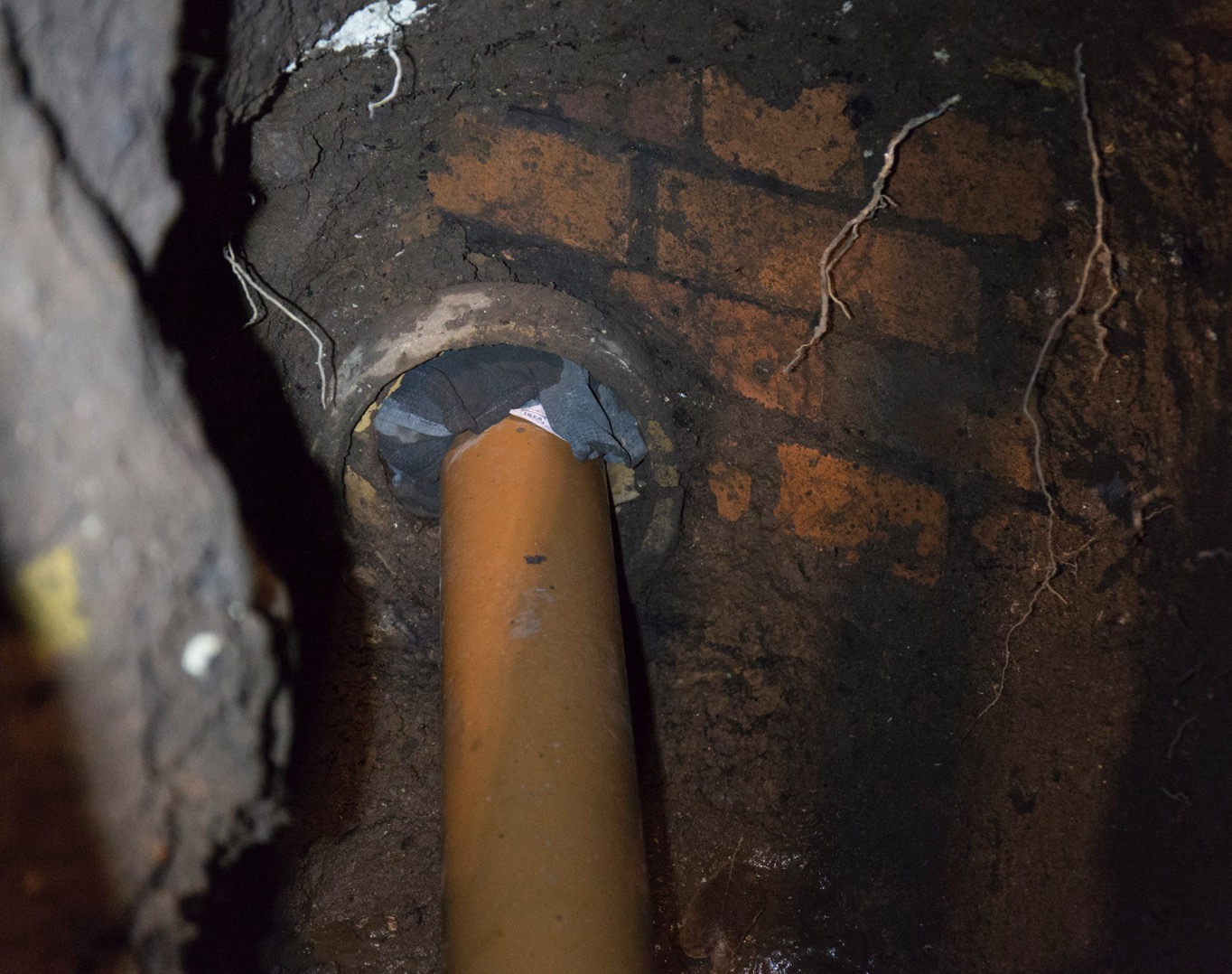

You can see the 6" clay pipe collar here more clearly :
These band seal connectors from Toolstation are a bit rubbish - they don't have fins on the inside to grip & create a seal like other manufacturers have. The clay pipe we had to connect onto was not ideal (the end of a y-junction, with a slight bend, with some chips on the underside creating a leak etc)
...we totally didn't end up wrapping duck tape around it in desperation at 1am last night.... *ahem* >_<
Obviously we should have dug more out and found a better bit of clay pipe, but we were already angle grinding at 11pm (the neighbours no doubt love us!) and we had no idea if what we uncovered would be any better. That clay section all needs to be dug out and replaced anyway (we suspect that is leaking too) once we have the inspection chamber in.

You can push the 4" a bit further in if you like so it passes the ridges.
You could mortar a plastic 6-4 reducer into the clay collar. I do it on awkward ones where I can't use a bandseal. I'd just use the Extra Rapid cement, big blob under it first to get it lined up then fill the rest of the collar. It's not worth getting anyone in now you have done the hard bit.

Good point about pushing the pipe past the ridges. There seems to be a good length of the clay pipe behind the brick wall... maybe around 1m or so? (we will likely be sticking a go-pro on a stick with a torch attached down there tomorrow because we are sufficiently odd/intrigued to want to know what lies beyond!)
Couple of questions :
How far to insert plastic pipe?
I'm of the opinion that the plastic 4"/110mm should only be pushed in enough over the lip of the bandseal to avoid the ridges... however the guy in the photo thinks we might as well push it a good bit further inside - almost to where we think the clay pipe stops and drops off into the sewer.
He thinks this would avoid any possible backflow towards the seal, whereas I think it would provide a nice, dry little cosy alcove for rodents to nest... (I had a massive, intractable problem with rats in my last house, so I am super keen to make things as inhospitable nearby for them as possible!)
Should we cut collar off as best we can with angle grinder?
We were both thinking that when backfilling or over time, the unsupported collar could be knocked, damaged or crushed sending cracks along the clay pipe buried in the brick wall eventually causing a leak. On the flip side, leaving the collar would allow it to be changed to a mortared joint at some point in future if needed/wanted.
I definitely prefer the idea of the bandseal rather than mortaring if possible... I am aware that every joint we have found that has been mortared - even if we were very careful in chipping it off - has fractured the attached pipe when doing so. If theres any problem with this joint years down the line, I'd rather make some other poor sod's life a little bit easier by making the joint removable, rather than making them chip cement mortar off a pipe that is likely to crack, in the wall of a sewer! I'm of the mindset do it once, do it right - try and make it last as long as possible, whilst also ensuring it can be 'undone' as easily as possible with minimum waste/damage.

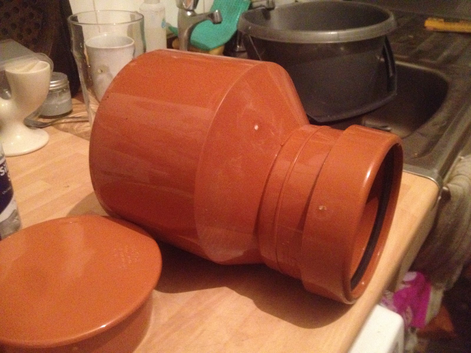

Do you mean one of these when you say 6-4 reducer? (that's all I could find - a level invert reducer)
I'm possibly overly concerned, but this wouldn't have any kind of rubber seal between it and the inside of the clay pipe like the bandseal right? My faith in mortar joints remaining waterproof (particularly in this area which is prone to movement) especially when made by novices like ourselves, isn't high!

That's the same reducer I was on about, no rubber seal, just mortar into the collar. If you mortar the reducer in before connecting any 4" to it you can simply wipe any excess mortar that might enter the pipe and you will be able to see that you have made a good joint.

The 160mm OD (outer diameter) of the level invert reducer, means it would not be able to slot fully inside the clay pipe unfortunately - only into the clay collar, which would mean there would likely be a leak through the crack in the clay.

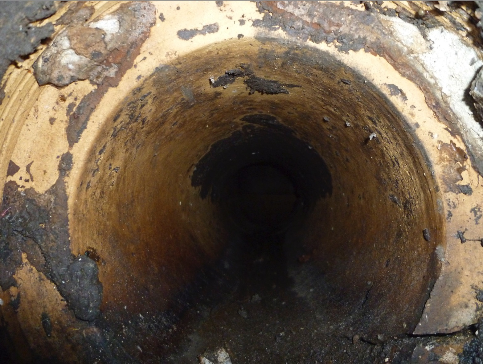

Could you take a picture inside the clay pipe to see how long it is on the inside?
Thanks Ian - we've measured that it projects around 70cm through the wall (its on an angle) before dropping off the ledge into main sewer run.

Photos as requested from inside the clay pipe pointing down into the sewer :
Sorry... he'd taken those photos before I'd had chance to tell him to chuck a bucket of clean water down first!
