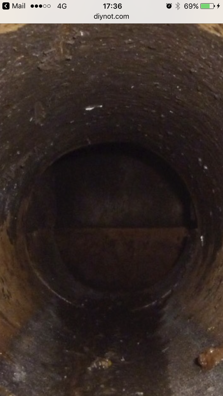

Not sure its a manhole... I suppose its possible & the top was covered in concrete. Seems like an old brick built sewer to me, but I am new to all of this. I get the impression you might be suggesting this is just a pipe that serves a couple of houses upstream of me & joins a 'common lateral' downstream of me? We have put an endoscope camera down - its hard to tell, but we think the ID of the brick structure is around 2ft - much more than the 12" the dynorod guy predicted it would be when we picked his brains! Externally - when I dug down to expose the stone/concrete cap previously - I found it was around 1.5m wide.

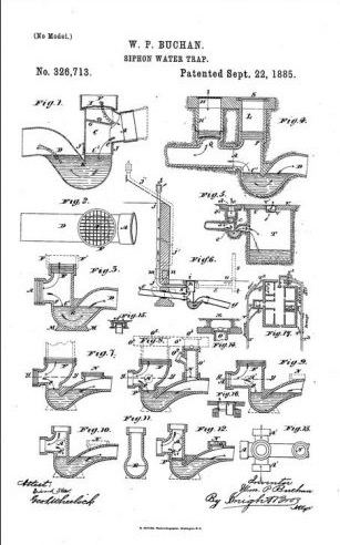

I think you may well be right about a brick sewer - I've never seen a weird Trap like you started with ( a buchan is usually at the end of a channel in a manhole) anyway you are going to be useful to Wessex water, and interesting to us guys;) P.S Ian - I can't see a channel - but that's my eyes

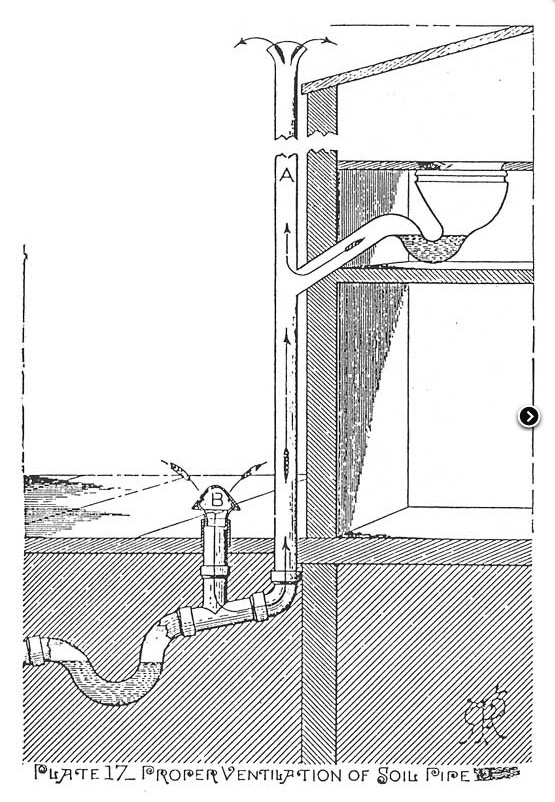

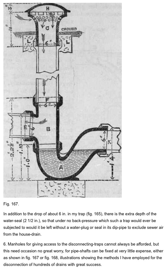

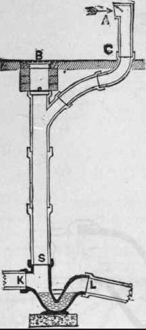

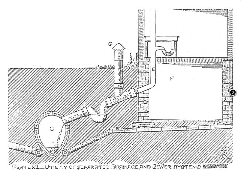

I've found a few references of traps just before they enter the sewer - as it mentions manholes cannot always be afforded (these houses were built on a terribly tight budget - there is barely any lime or sand in the mortar, it is almost all coal/ash scraped from the inside of blast furnaces!) :

Presumably mine would have had a lid at some point like the one shown here :https://www.diynot.com/diy/threads/...rainage-interceptor-trap-plunge-shaft.439804/ ... although mine was long since buried under a foot of soil (with a clay roof tile covering the top)
We noted that the clay was *very* thin on the areas of the trap where it was broken, so there were clearly problems with the manufacturing of them.
There seem to be quite a few different types of historical interceptor traps - mine definitely seems to looks like the Buchan patent... although more common near manholes seems to be the 'Beancliff' or 'Kenon' intercepting traps shown here : http://chestofbooks.com/architecture/House-Construction/The-Trapping-Of-Drain-Inlets-Part-5.html
It is a manhole, you can see the 1/2 channel.
There is definitely a ledge part way up. From the endoscope video (terrible quality) the 'roof' looks somewhat curved. I just can't understand why there would be a manhole here, in the middle of the tiny garden, covered over with some serious layer of stone/concrete. The channel inside seems to be really quite large - much more than in any manhole I've ever seen! However, there wasn't constant running water, like you would expect if it was a larger main shared sewer.

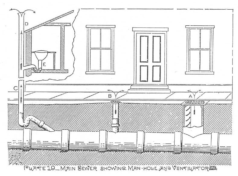

Nice diagrams!!! Did you come accross any for a 'Tippler'?

Thats a new one to me... how fascinating! Never heard of such a thing (no diagrams found yet either) but several accounts of people describing them. Glad we don't have one! I find all those diagrams so interesting - the care and attention, the problem solving engineering... the Victorians did some incredible things, even if they didn't always make the right assumptions... its amazing to see that process and progress in this hidden world beneath our feet.
