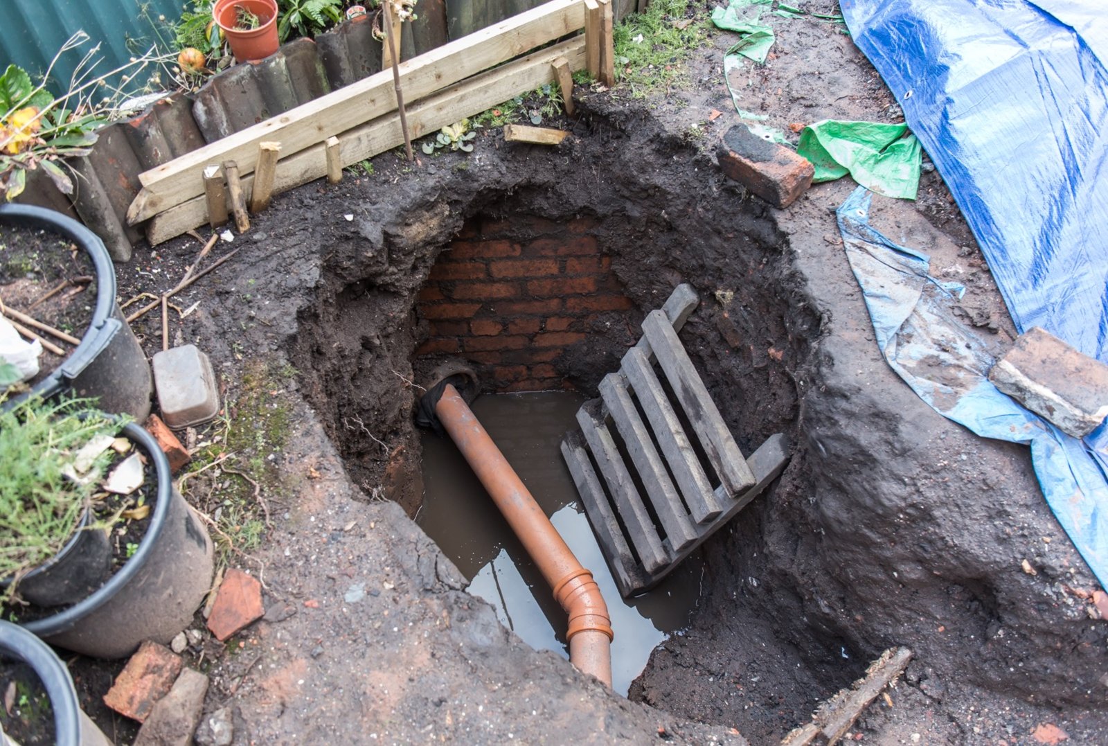

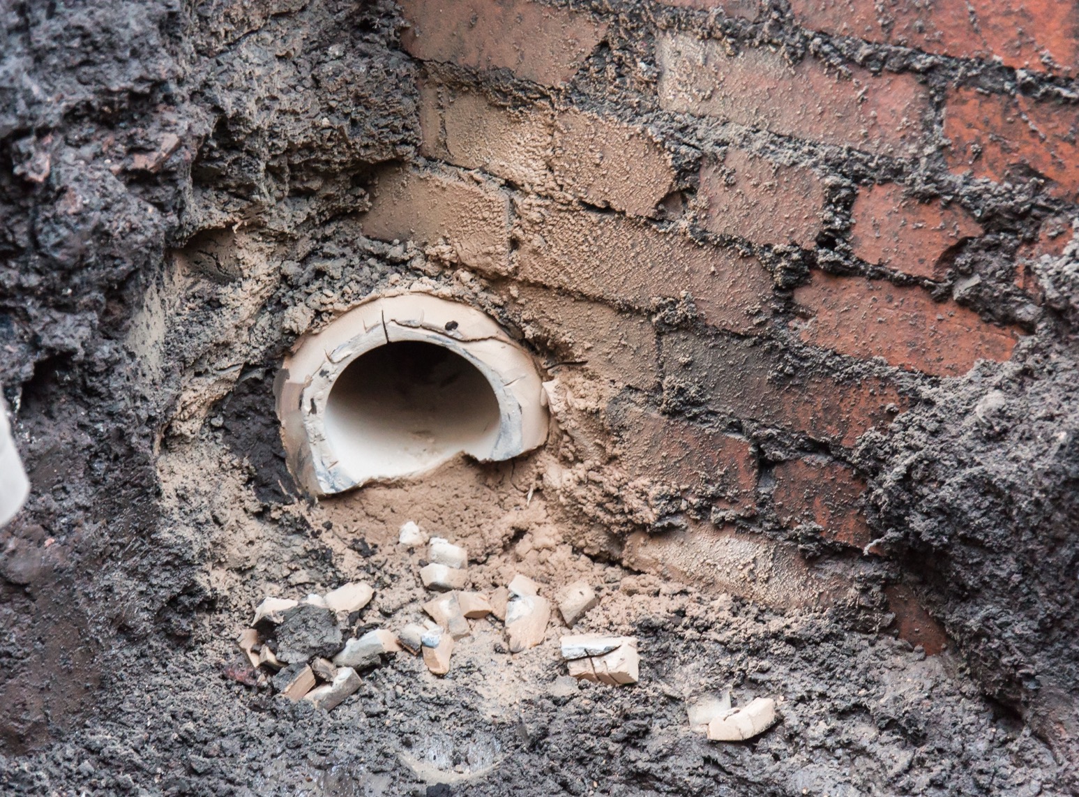

Finally managed to get the IC installed yesterday.
Bailed out few inches of rainwater from trench...

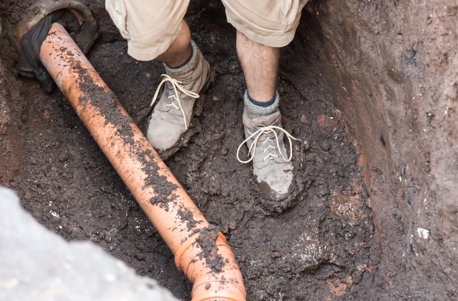

Squidgy clay... the kind that pulls your boots off...

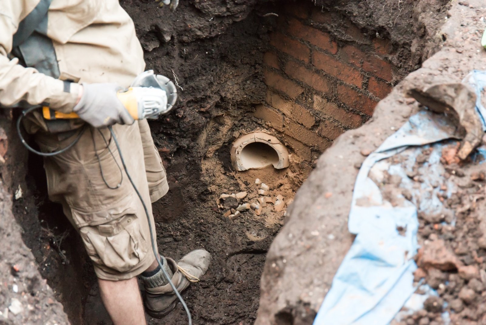

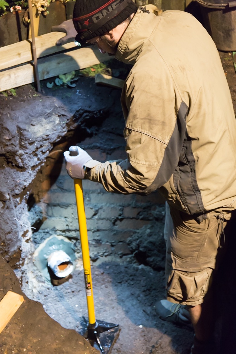

Cut collar off & removed cracked section...

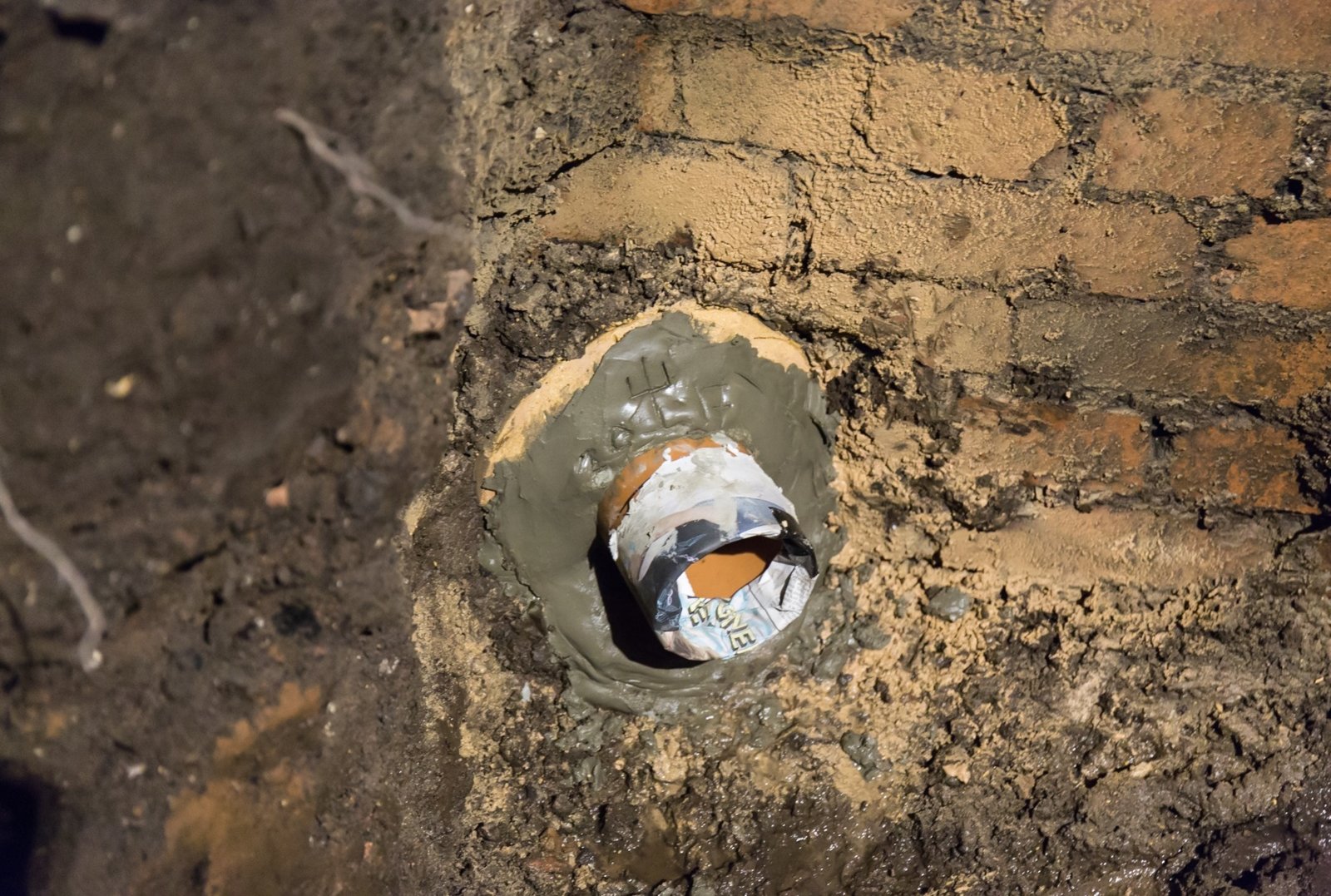

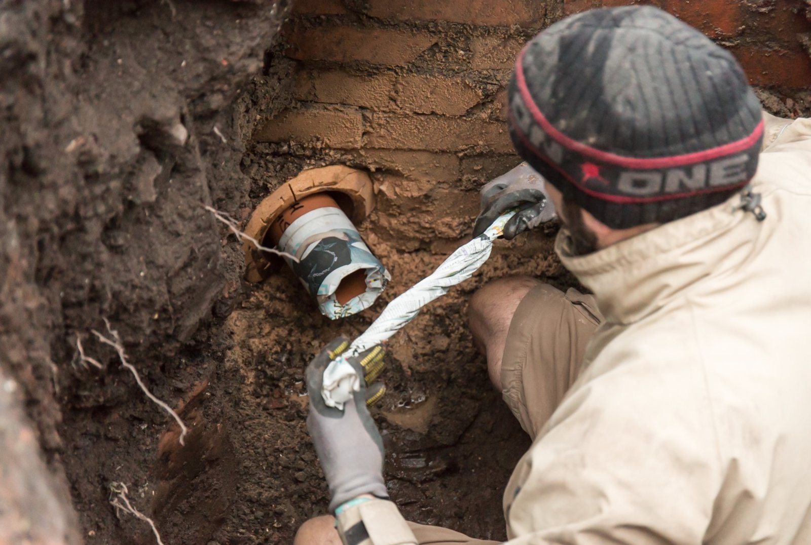

Covered end to protect joint surface & packed with newspaper to support pipe whilst mortaring (as suggested by wessex inspector - said that it should rot away harmlessly over time)..
Mixed up Cementone Rapid cement (waterproof) - was a completely wet slurry with suggested amount of water, so had to add more powder to make it useable as a mortar (it seemed to indicate it wasn't advised to add sand)

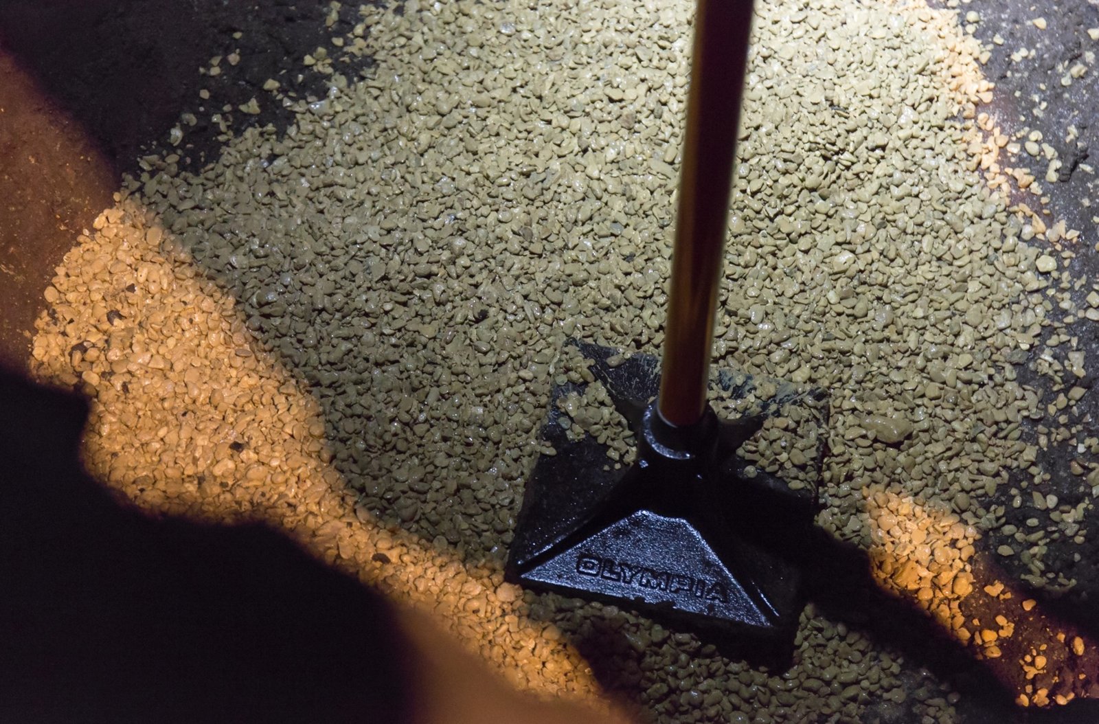

Tamped base of trench after putting some drier soil in to 'absorb' some of the clay sludge moisture. Tamped down 2 bags of 25kg 10mm gravel & created roughly level surface. Allowed us to step on it with boards without sinking in.

We struggled to get the mortar around pipe to set ...possibly due to the low temperatures (?) - after an hour, we set up a heat gun on a low setting to raise the temp in the trench a few degrees!

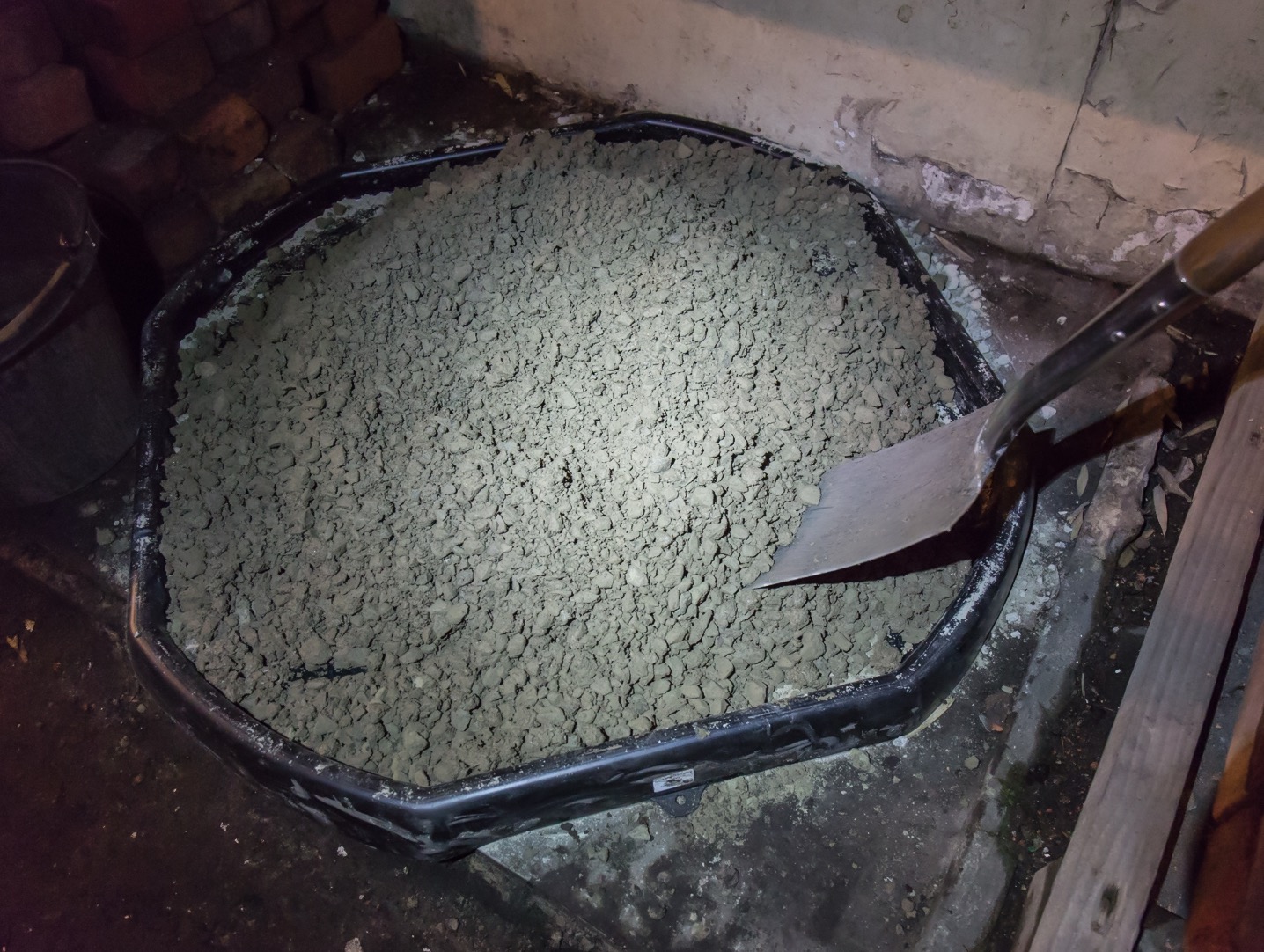

Hand mixed a semi-dry (?) concrete mix : 3 x 25kg bags wickes ballast, 1/2 bag of 25kg of blue circle cement (so 12.5kg) with 4L of water - this (hopefully) was roughly a 1:2:4 (cement/sand/aggregate) mix.

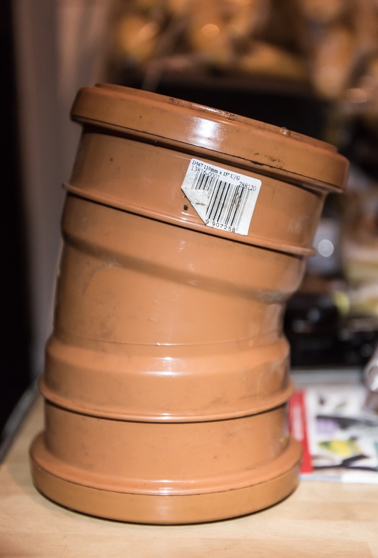

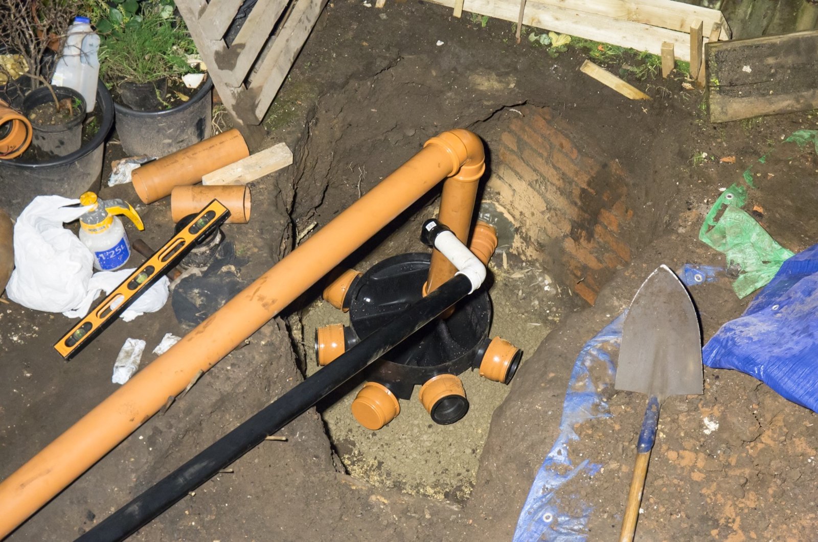

Then we connected a 15° bend to the spigot of the pipe inserted in the >6" clay pipe in the manhole wall. This was a bit awkward, since the mortar was still not very well set & we wanted to avoid disturbing it by pushing the plastic pipe inwards & breaking the bond/seal between plastic & mortar. We considered using a Floplast/Flexseal bandseal coupling to remove the need to exert pressure in that direction (I made a last minute trip to B&Q to grab one just in case) ... however with trying to conserve space and get the IC as close to the manhole wall as possible, we decided to risk it and carefully ease the 15° bend on using plenty of silicone spray whilst holding the pipe spigot as tightly as possible with the other hand.

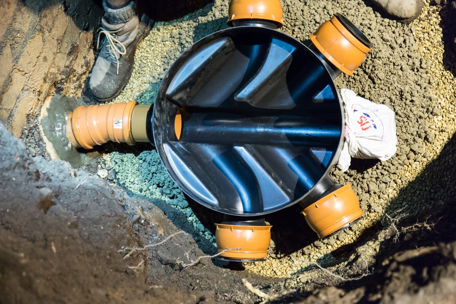

We inserted a short 'rocker' pipe into the outlet of the inspection chamber, then slotted that into the 15° bend. We left a 10mm gap, so that when we inevitably slipped, the force would be taken up by that gap mostly, rather than the force being transferred straight into the pipe embedded in the mortar. We then bedded and levelled the IC on the concrete, packing in extra concrete in the voids around the edges - being careful to retain access to the inlets.

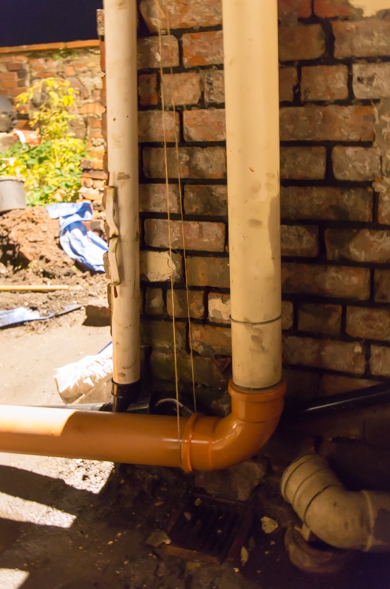

It was getting very late by this point & so we've ended up with this amusing temporary drainage so we could have showers & use the loo!
