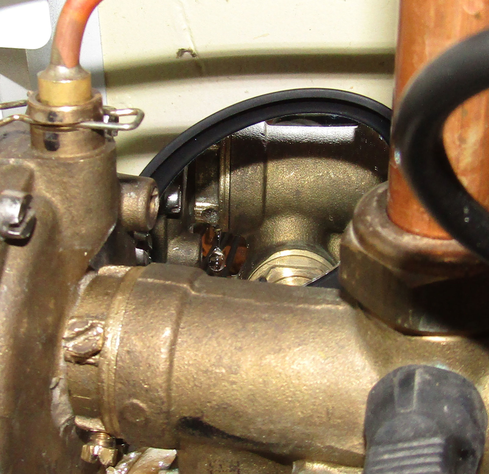

The diverter valve controls your system water to the rads or the plate heat exchanger whereas the water in the diaphragm section (364) is mains water, the two never mix.
If your system pressure is dropping as a result of the leak then the leak is from the diverter valve.
The pressure does drop due to the leak.
So there should be no water coming out of the 'brass bush with screws' (the unumbered part)?
I have managed to take a photo of where the leak is and it shows the water is coming out of one of the thread holes that could contain a tightening screw.....
Does this eliminate certain suggestions please?

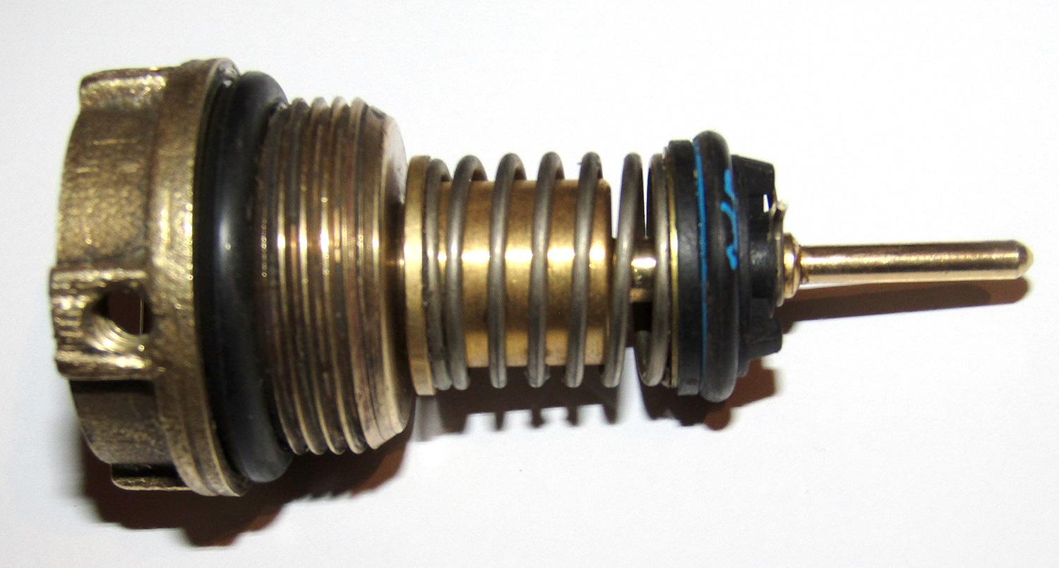

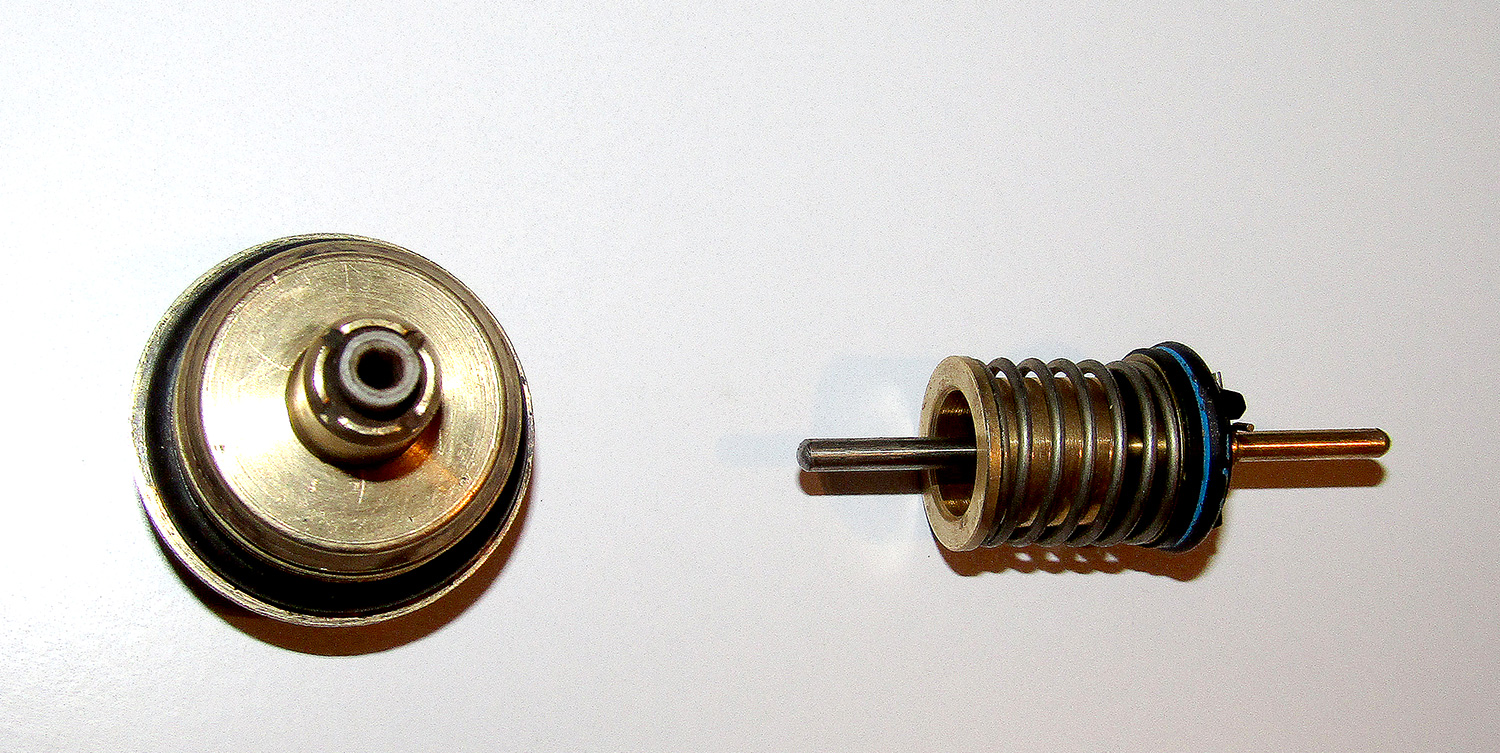

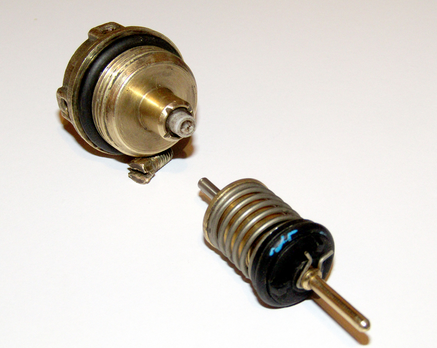

I have taken out the brass bush and taken some images with it's spring valve.
Is there anything untoward with the parts please?
The white plastic tubing/housing that is located in the brass bush, should this be tight fitting around the spindle of the spring valve when it slides into it? There is some side to side movement.
Just wondering if the water is escaping through this plastic sheath?

I have cleaned the brass bush and around the area it sits in. I then experimented putting some PTFE around the spindle of the spring valve that sits in the brass bush and so far there is little or no leaks! :D
Hopefully I have found the problem. It's the white plastic insert that sits in the brass bush that holds the spindle of the spring valve. Worn over the years, allowing water do push through, under the high pressure.
I will do some more testing then hopefully purchase a new brass bush.

Looks llike it what we thought all along but I expected there to be a small O ring, good luck with everything.
