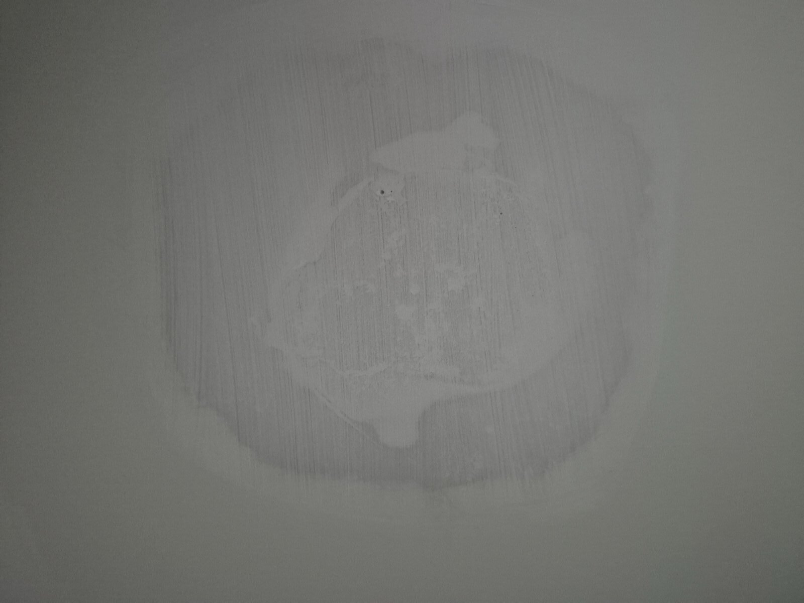

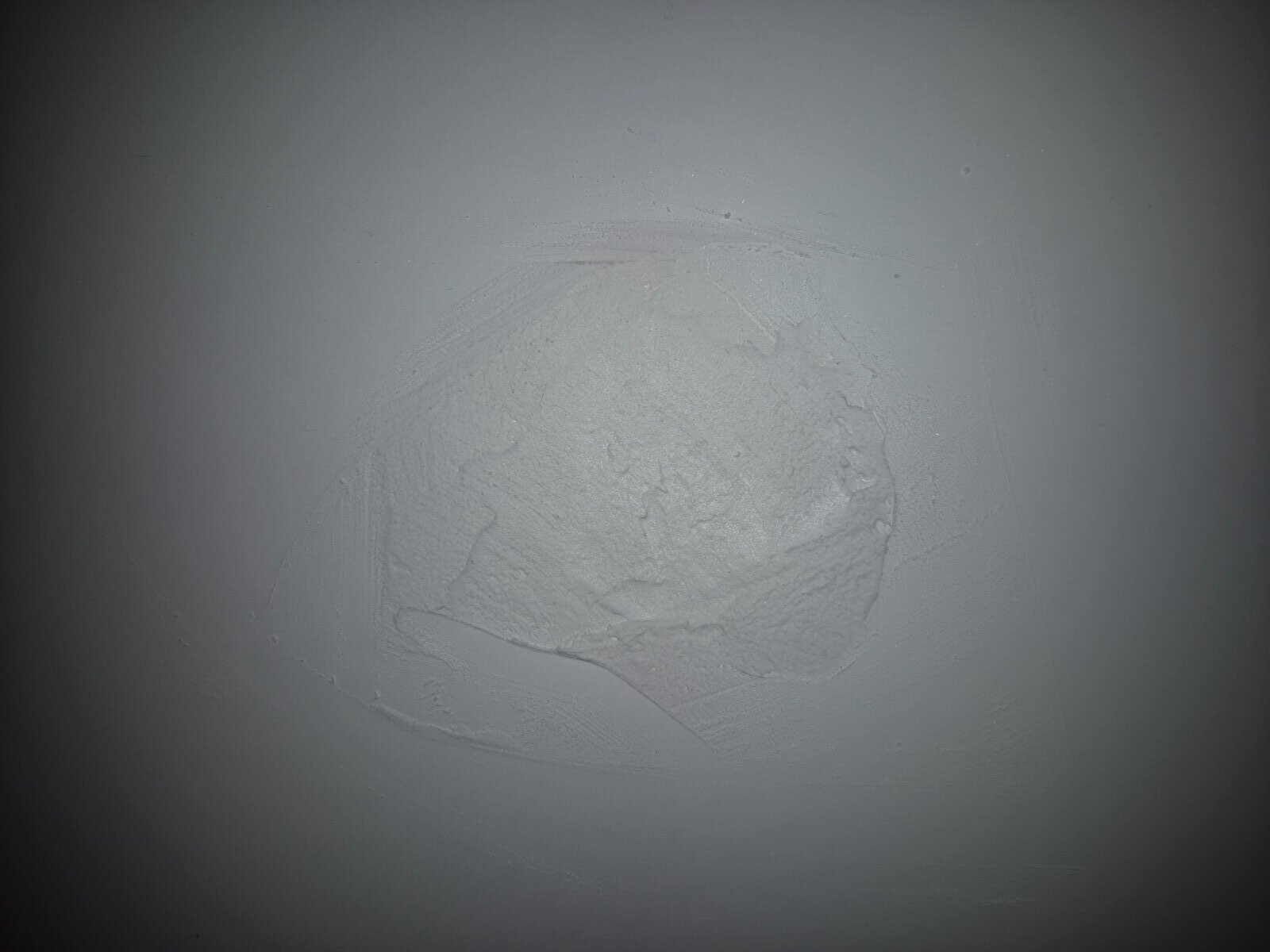

Hi all
Anyone know how and what I need to fill in this hole in this table? And how I make it smoothe?
Its a hollow table mostly and I have filled the hole in with filler but it still keeps dipping in and can't get it level and its not smoothe.
What should I do or use to get it level and smoothe?
Should I reapply anither layer of filler once that first one has dried but then how do I make it smoothe. I was using one of those smoother scraper things but it kept going in as ofcourse its a bit hollow the table.
Did you use 2 pack wood filler?
No I just used all purpose filler. But I have bought some wood filler today and will try that. As when I press it now it presses in and ofcourse it's uneven.
Dig out.
Maybe put something inside to firm up.
I guess it depends if it's hollow.
2 pack wood filler is very hard so you need to be tidy with your filling

I normally use waterbased artist paints mixed into 2 pack filler . Getting the colour right can take ages though.
If it is a lighter colour I use the "clear" Tetrosil StoneFill 2 pack filler. It isn't clear, it looks more like honey but it requires less in the way of artist paint. It was first recommended to me by a tiler who was filling holes in tiles.
It the requisite final colour is darker, I used the regular grey coloured 2 pack filler.
