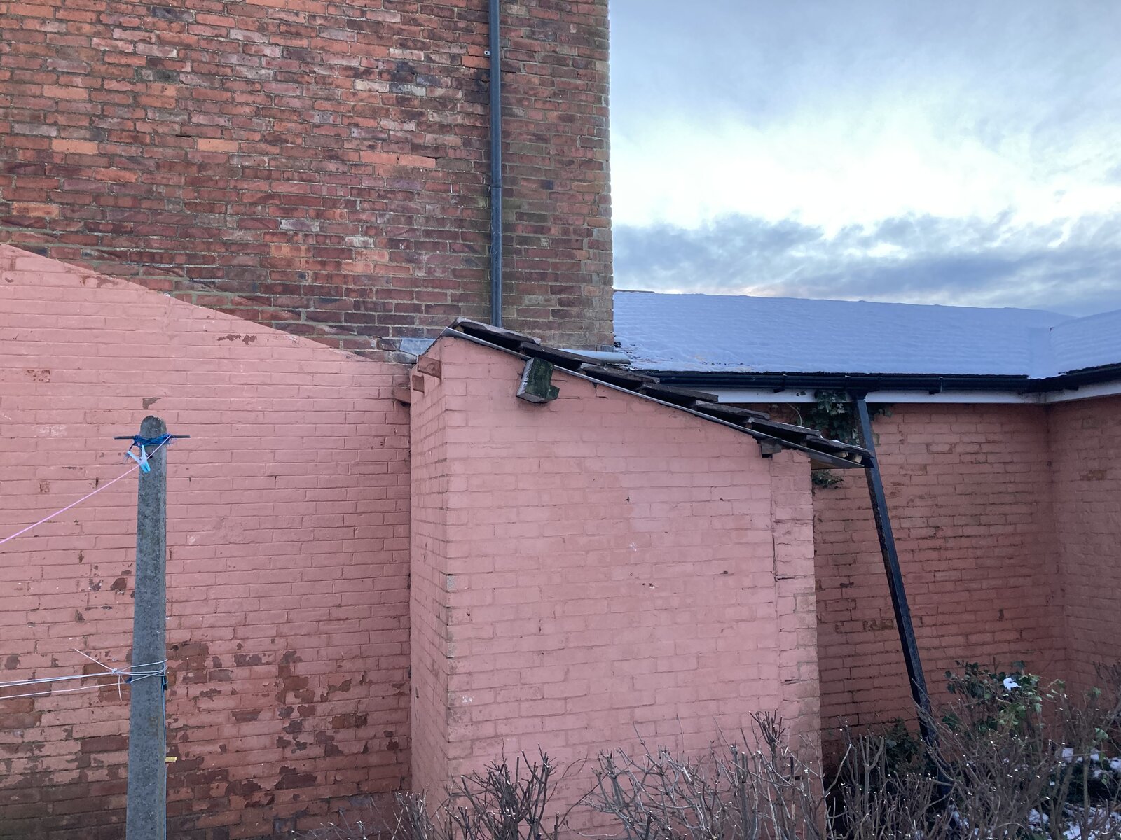

Hi folks,
What is the best way to finish the ridge of a mono tiled roof? Tiles are flat interlocking concrete.
I see mono ridge tiles exist but I can’t for the life of me find anyone who sells them in a real shop. None of the big DIY chains or builders merchants seem to sell them.
Photo attached of the roof in question. The ridge I refer to here, for the avoidance of doubt, is on the left of the photo.
Good luck with specialist roofing materials ATM mate it's hard enough getting concrete tiles lately.
Cant you angle a ridge to give you correct cover on the tile and work a support on the back maybe a temporary batten holding the back up
You mean standard ridge tiles? Aside from the aesthetics of it, I figured I could just mortar the gap between tiles and wall or maybe use dry ridge if I was going to do something non standard. Do you see anything wrong with either of those options?
You will still need a tile acting as a last point of cover it's a fiddly one making do with normal ridges but it can be done I've found.
If you've not worried about aesthetics what about a lead ridge flashing with appropriate support
I considered Lead but I can’t find anyone selling wooden roll batten either which I figured would give it the support it needs.
The tiles overlap at their sides (https://redland.co.uk/settings/resources/files/documents/ministonewold_product-datasheet.pdf) so the headlap is, by design, less than half of the tile. As such, I figured that a cover at the top wasn’t strictly required. Am I talking crap?
How about a dry ridge kit? The ridges can be secured then. Make up the ridge with some timber.
Just need to ensure there is cover and a drip on the wall side.
One more course of brick and then you could likely use an angled hip tile .. these will give more cover than a ridge. If you get the right pitch. Reclaim will have a few
