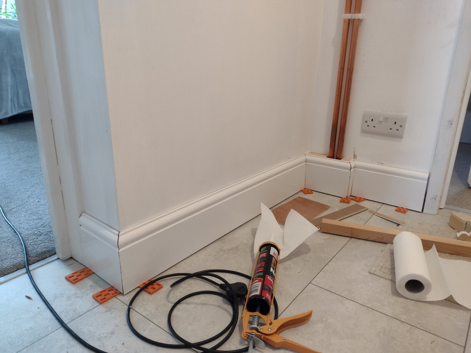

How to finish this skirting around pipes?
JP_
17 May 2012
11,456
1,047
I could leave it after painting, but wondering if a better way.
Leave as is if it ends there, otherwise take back to either side of pipes to get a clean run of skirting: paint pipes, people get over exercised about pipes on display, when often they’re less intrusive than boxing in
Blup
Yeah, not boxing in, we need the heat in the room.
I've stuffed insulation around them, so no drafts can get through from below, but still a hole on top. I think we can live with that.
Ideally you should have made up a one piece top for that boxed in skirting, accurately drilled two holes in it for the pipes, then carefully cut out the back using a jig saw so that you could fit the two pieces tightly around the pipes. You'd need to add some sort of support to hold the pieces, but I'd have expected to build a lightweight (2 x 1in lath?) frame beneath the boxing in any case, so it wouldn't be a problem.

Just doing a refurb on partner's flat and for the first time I've tried scribing rather than mitre-ing the internal corners on the skirting. Results are OK but in my view no better and no worse than mitre-ing (mitring?). Both still need a bit of caulk afterwards. Is that normal or am I just rubbish with a coping saw?

The purpose of the scribe is to minimise the joint opening up as the material acclimatises to the house - an internal mitre can open up, even with MDF (albeit mostly to a lesser extent than mitres in softwood). An inside corner mitre can open and close like an accordion, depending on the season, in some houses, meaning that caulk can't fix it.

I would have boxed across to door frame , neater than the chicane you have at the moment and doesn’t need to be that deep , just enough for pipes .

Yeah, I did have to think about how to fill this. Not much hope.
Sorry. Just wanted to share and not adding anything to thread.
Skirting looks tidy in above picture.
Yeah, was going to be a bit smaller, but then I found a couple of bits of wood I could use so that's the size!
