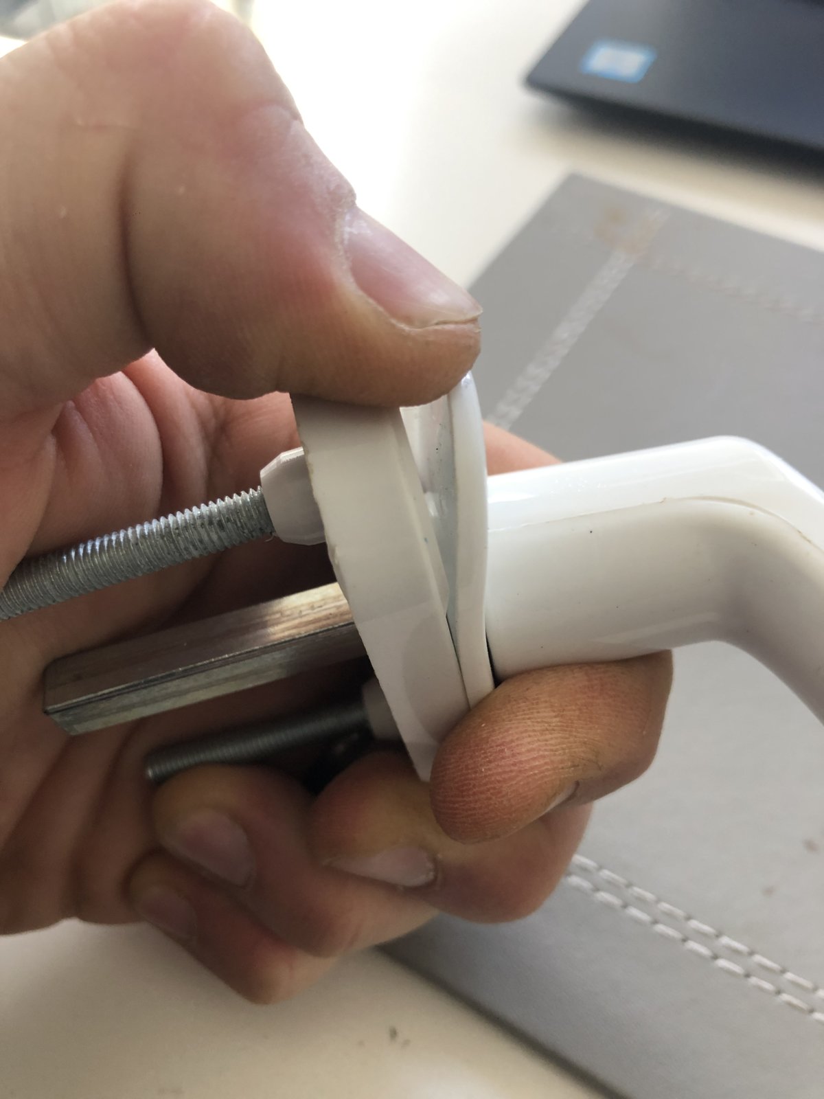

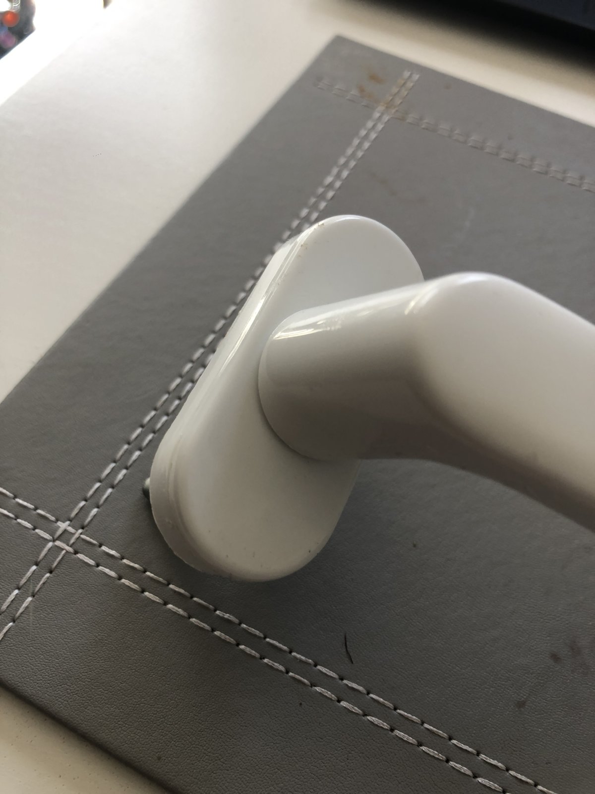

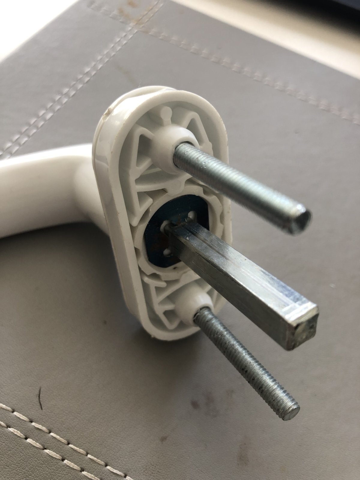

Could someone please give me a suggestion of how to get this handle apart so I can fit it to my window?
Am I missing something simple here?
Many thanks.

the bit you have lifted with your finger should twist through 90 degs ( around the spindle )
if thats a new handle, it may have a spindle that is too long -you may have to cut it down with a hacksaw
Just found that it rotates... didn’t even think to check! Thanks for the quick replies.
