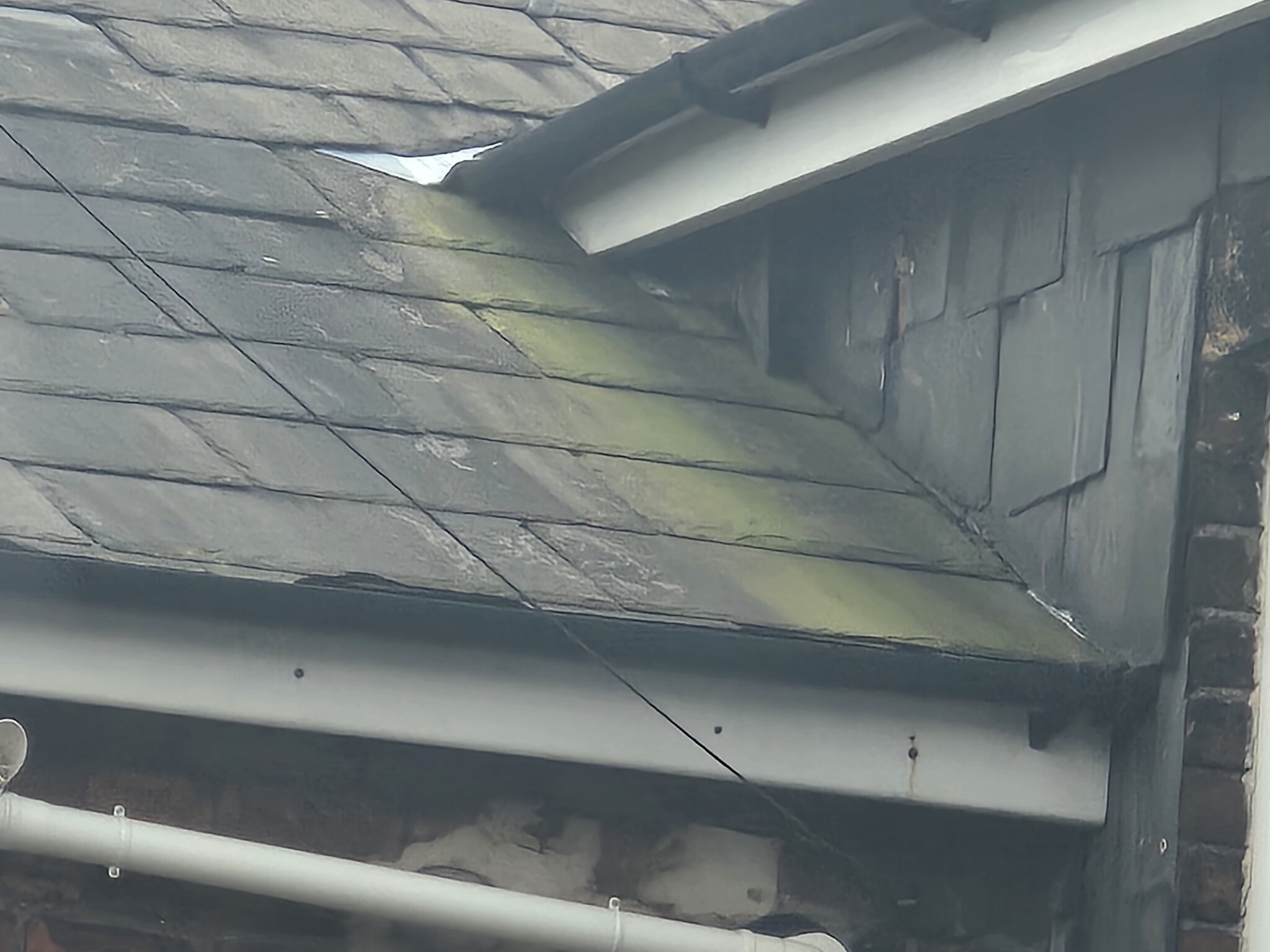

The rear wall of the main house suffers from damp and externally can see where the wall is wet all the time.
Water isn't running over the gutter but it has me suffering if the way the main roof gutter runs into the valley is causing water to stop into that wall somehow.
Does this seem feasible? If so how could I resolve this?
What is the pipe running into the wall? There is a broken eave slate, the valley configuration is standard and shouldn't be a problem.
Thanks for the reply.
The white pipe is the boiler vent.
The main roof gutter just ends at the valley, is that ok?
Does the bottom gutter look OK? I'm just trying to find the cause of damp on that back wall.
Wall is visibly moist, cold too the touch and damp. In upstairs room there has been black mould but has been regularly cleaned
There is a slate hanging out in the top left corner! definitely letting in water.
