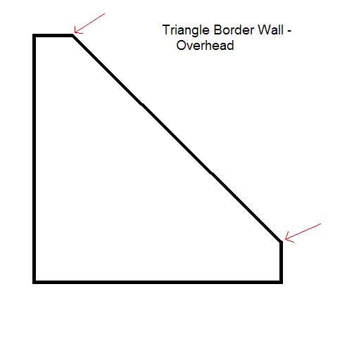

I'm planning on building a low wall for a vegetable bed. It will only be about 3 or 4 bricks high. I want it in a kind of triangle shape like this:
But I've no idea how the bricks would need to be laid at the angled corners (where the red arrows point). What are the options?
Would appreciate any help or pointers. Cheers,
Max

Cut bricks is an option or how about making a feature of the corners using blue (engineering) squints?
There are a few ways of doing the angle. Mitre the bricks is one method, or you can make a squint by cutting out a section of the brick and resin bonding the 2 pieces together. This is done by some brick manufacturers.
You can also let the bricks overhang at the angles.

Resin bonding is used to attach a good face to the cut brick - standard mortar is used to build the wall.

Glue, resin whatever. It's not designed for permanently damp and freezing conditions.
If you don't want to bond the corner, then you are better off having a straight joint with ties or mesh on the bed joints to hold it together.

One thing I should add if I haven't already, the wall will only be two bricks high at one end, and 3-4 bricks high at the other.

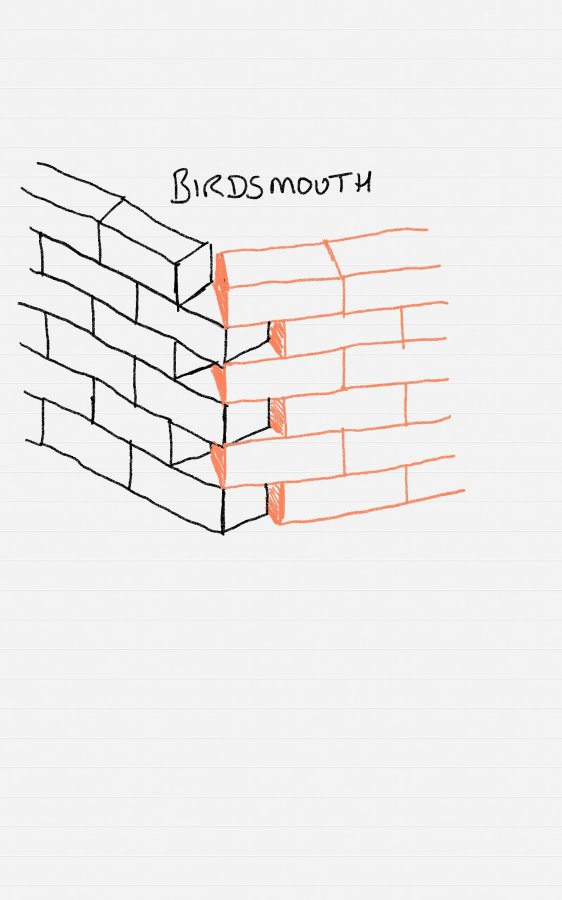

No expert, by a long way ...
Do like in Woody's sketch above, but cut off triangular corner pieces to fill the gaps. You'll have what looks like a continuous vertical joint, but behind that the bricks have triangular overlaps. Keep the joints (between the triangular bits and the opposite brick) tight, and it should look fairly neat - not quite link squints, but fairly neat.
