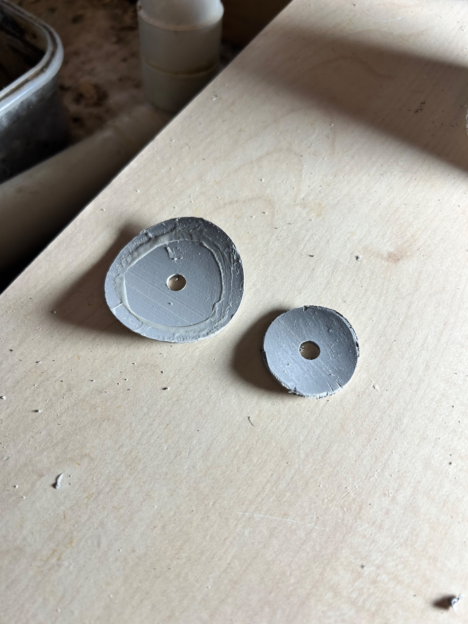

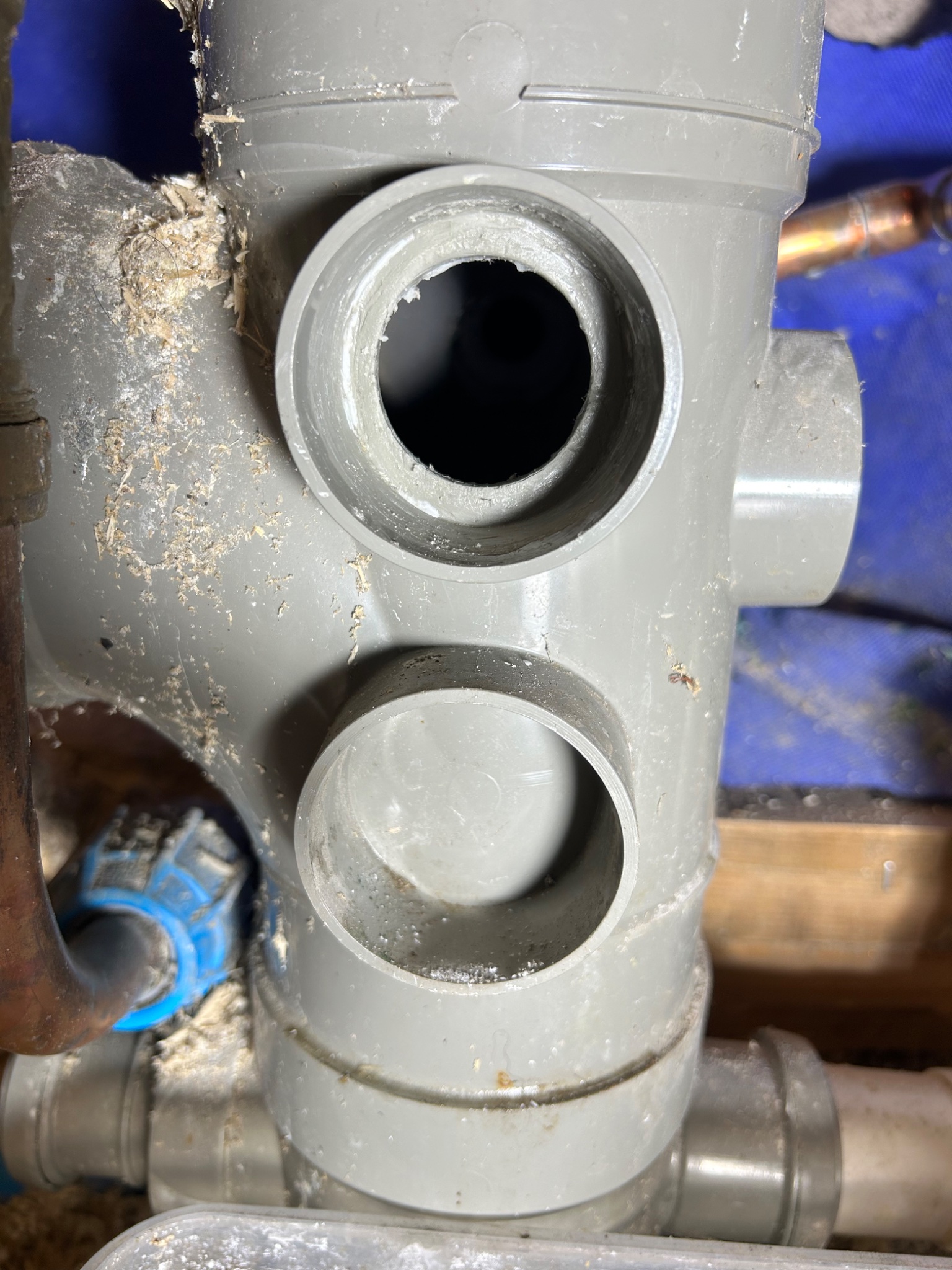

Hi
I’m trying to plug a soil pipe branch that’s no longer needed. The hole is about 38mm wide and I tried using a 51mm hole saw to cut and glue old plastic pipe onto it but it didn’t stick (using solvent weld). The plug/boss inside diameter is 52mm, o.d. 58mm, and branch is made by Terrain.
Any thoughts how to seal hole?
Cheers
That flexible end cap looks perfect. Hopefully local pm stocks something similar as that link charges £10 delivery.
Planning to box pipe and found Terrain boss adapter sticks out 40-50mm so not best option in this case.
