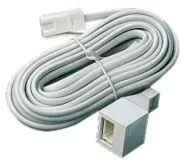

Thanks for the replies guys. While he went to the toilet I moved his chair to what I thought was a better position for watching tv but when he came back he refused to sit on it because it was Colin’s chair. There is no Colin and I had to put the chair back because my friend was clearly upset. As soon as he sat down he switched the socket off and we lost the internet. Moved the router to another socket using the full length of the telephone cable but again lost the internet. Moved the router and the telephone to a bedroom telephone socket but again no internet. Seems to work only with phone socket in the lounge. Have found a temporary, but very inconvenient solution. Have disconnected the router and using the existing coax socket and cable behind the tv get a fair number of channels. Now the only plug beside his chair is that powering his reading lamp. Thank you for all of the suggestions even though some are not really safe for a PWD.

Could it be possible to replace the router with a dummy one (broken, second hand, etc.) and simply move the original? Sounds like the other sockets are extension sockets which aren't set up correctly.
If so, a fix is to ensure the 2 wires from the terminals on the back of the faceplate go to 2 and 5 in the extension socket. You must then use a filter.

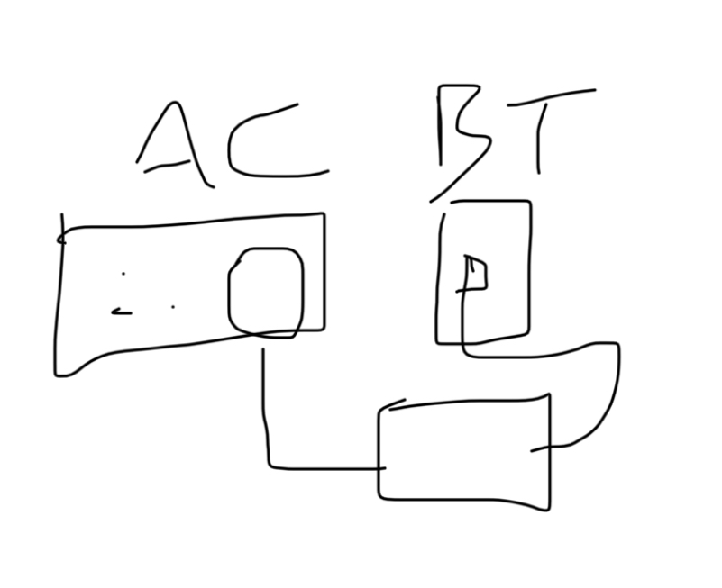

Didn't understand this one.. are you saying that you had this:
This being the router plugged into AC socket by the chair
And then you had this:
Which is unplugging the wall wart from the problem socket, and moving it, and only it, to some other socket and plugging it in?
Unless the second socket is inoperative this will not cause internet to fail. Routers don't care what AC socket they're plugged into so long as it provides power
There's some slight chance that disturbing/pulling on the phone wire introduced a poor connection but jiggling it should improve it unless it's broken inside. Obtaining another/longer phone cable should be suitably remedial if you determine this has occurred
Engineer called and asked why the router etc wasn’t plugged into the master socket which we didnt know existed. He hound it behind the tv, moved the router over and problem solved. The downside to all this is that in the space of 2 days my friend has lost the ability to use not only the remote control but also the telephone. Thank you again to all those who tried to help.
