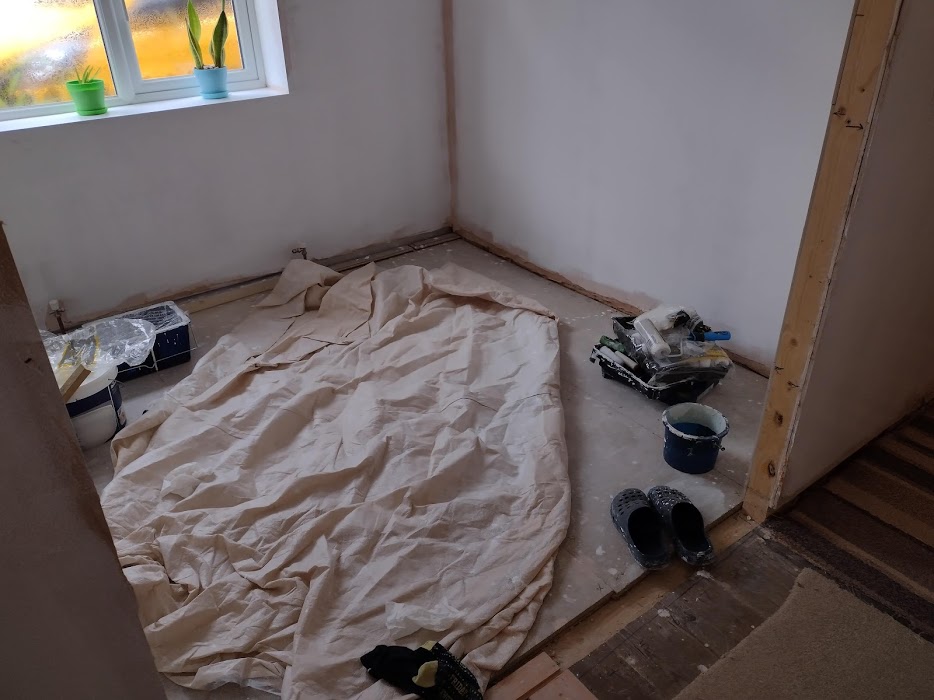

As soon as I've finished painting I will put laminate floor boards down (they are in the car already!). Should I start at the door entrance (different flooring will be in the corridor) with a cut down board at the wall, or start at the wall and work to the door? I will be filling that gap with some more floorboards beforehand.

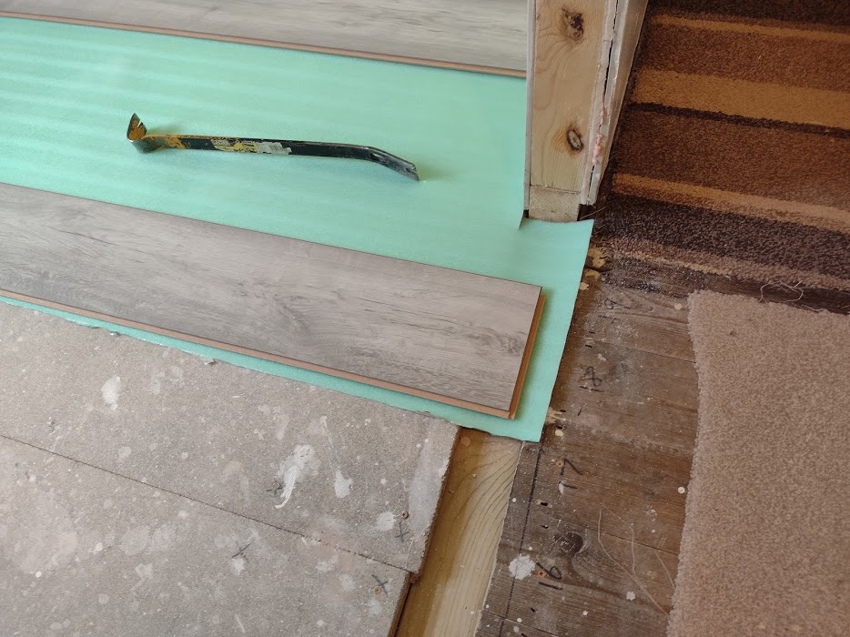

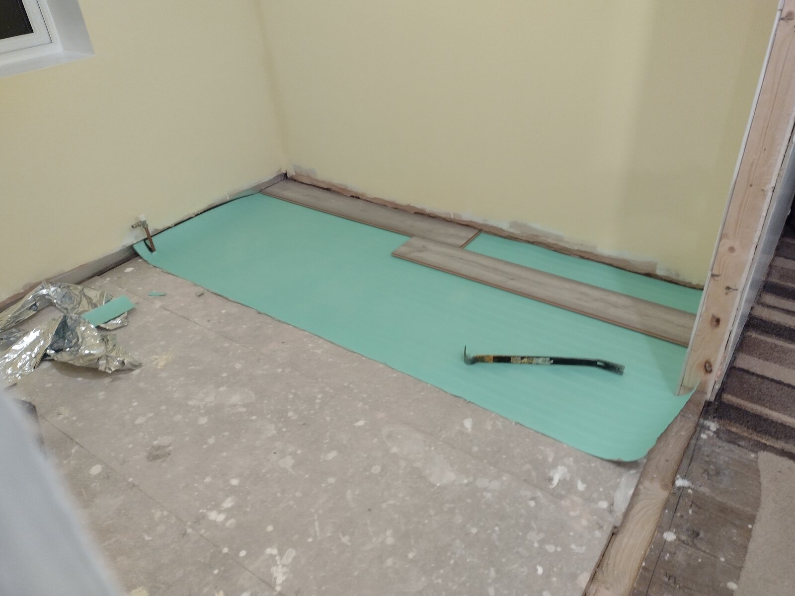

Got this far ... Boards are 130cm by 19cm, room is 230cm by 290cm still not sure which way to do this!
I’d personally lay them the way you show IF you have anything other than boards in the hall. I would lay the hall ones in the longest orientation. If you had boards in the hall, they wouldn’t look right going crossways. Oh, and stagger the joints - don’t repeat the pattern you have now.
