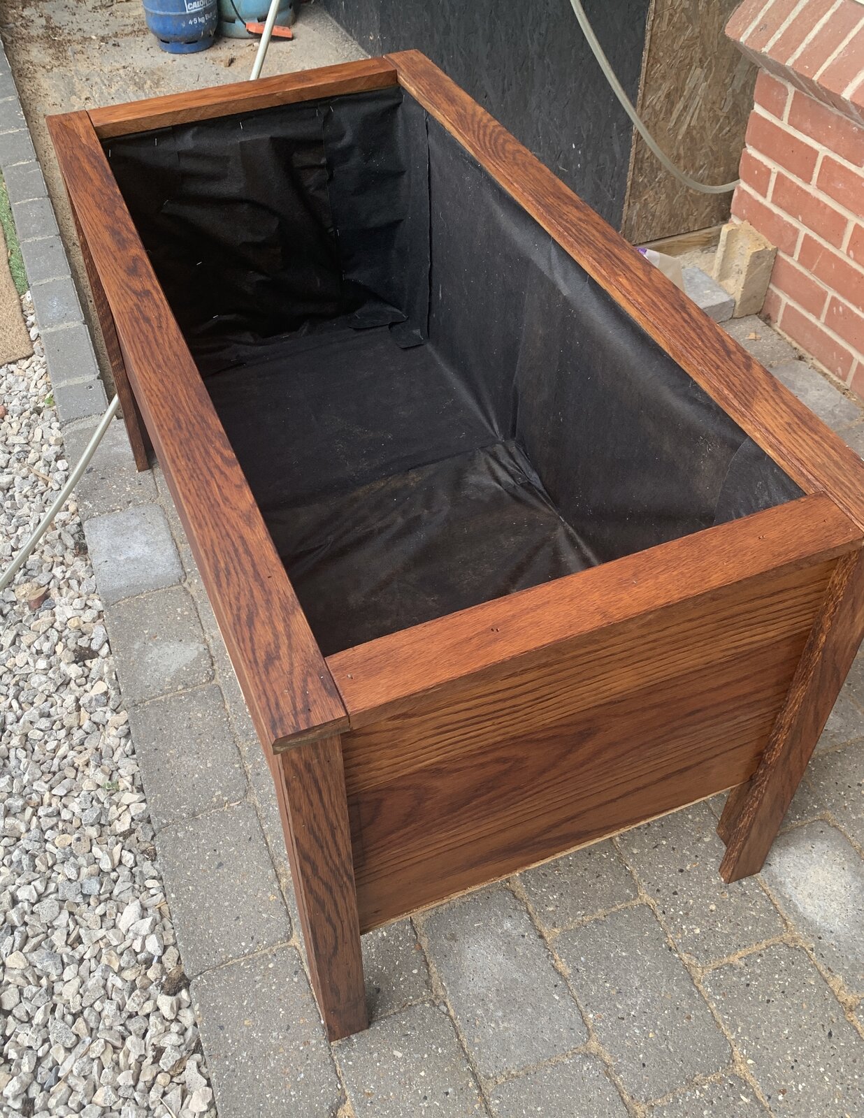

Have a 30year old basic table saw (no height or angle adjustment ) cost me less than £30.
Used it to cut down solid oak floorboards for a planter for one of my daughters, it coped easily . You don’t need an expensive machine , the blade quality is most important element .
