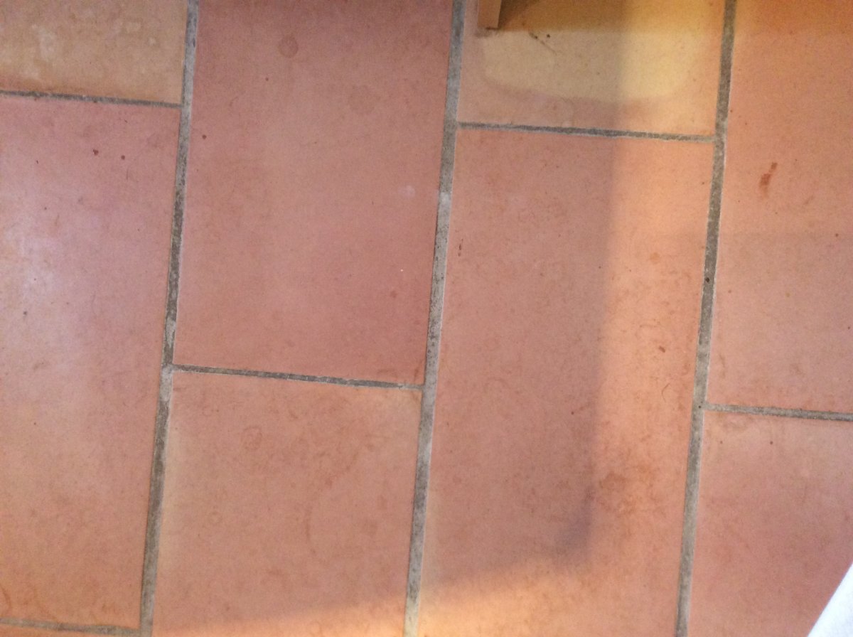

After removing flood damaged carpets in 3 bedrooms (in France) we discovered terracotta tiles which were covered in dried-on carpet glue.
My wife prefers the tiles, can you suggest a product to remove the glue from the tiles (about 40sq m)?

What it all comes down to is the type and condition of the glue. If it is like EvoStick and still rubbery then any heat gun will do. No need to spend big money. If it has gone hard and isn't at all flexible then probably better off with a good scraper with replaceable blades. They have a foot long handle and an angled head.
Thanks again Joe, can I use steel blades? or do they scratch the terracotta tiles?

I have attached images of the tiles.
With and without glue.
Is it possible to tell if they are sealed?

Depends on the glue , dissolving the glue with heat or chemicals can make the job harder leaving a sticky mess, a wood scraper will not harm the tiles, sprinkling talc on tacky areas help keep the glue in one lump.A time consuming job whatever method is used.
