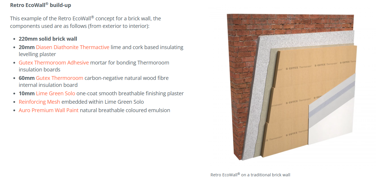

We're in the process of adding internal wood fiber insulation to our property, to make the walls breathable again. We removed all the plaster from the walls and are planning to plaster it back with insulating lime plaster to 30-40 mm depth and then wood fiber on top and lime green solo plaster on top.
We're planning on using this system from Ecological Building Systems

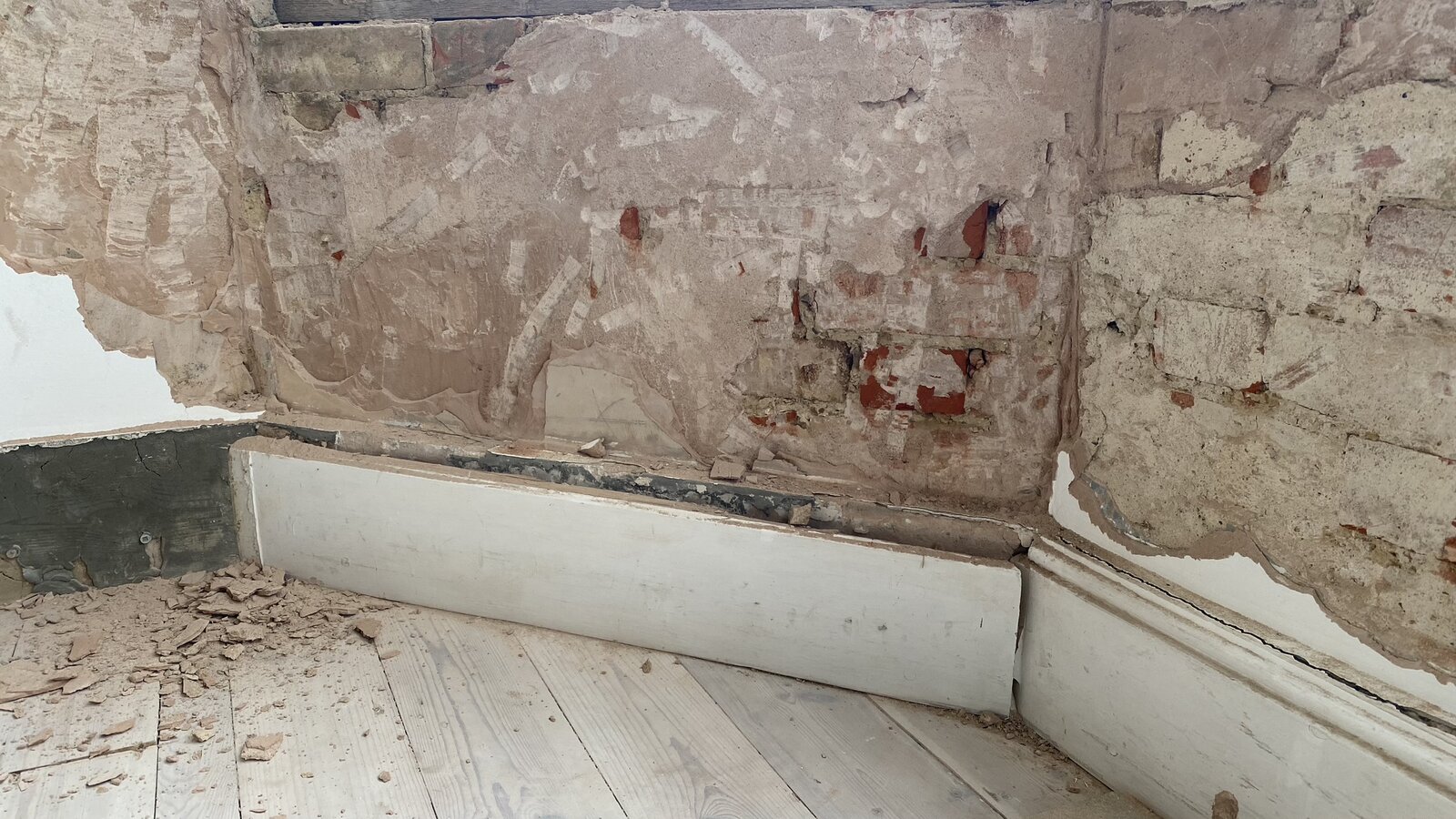

but we're running into problems where the gypsum plaster has been stuck directly to the bricks (see picture below) and is not completely coming off and is leaving a layer of gypsum on the bricks. Does anyone have a solution on taking gypsum off completely from the bricks without damaging the bricks?
I'm out of ideas and only solution is to sand it down to the bricks.

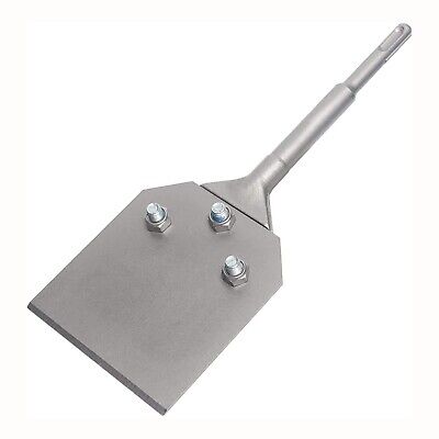

Needle scaler or a small breaker with a scraper blade. I have seen chemical poultices used to remove multiple layers of lime wash from stone carvings, so whilst expensive it might work if you mechanically remove enough lime plaster. TBH internal skin brickwork in old buildings is often very poor quality (it was going to be plastered so why do your best work?), so be prepared for disappointment
Edit: scraper here. Also on Amazon

I’ve got hold of a Sds drill and using the hammer function with a chisel bit to take off the gypsum but I cannot take it all off as I mentioned as it’s just making a powder from the gypsum plaster

There is a considerable difference between using a thick, blunt, forged SDS chisel and using a thin scraper blade, which is more like a spade or a very large wood chisel. The spade mentioned will indeed take loose lime plasterwork off a wall, but if it is still well adhered you may well find that the spade doesn't work - the scraper does work in that case. This is thecsort of job where one tool alone may not deliver a solution
