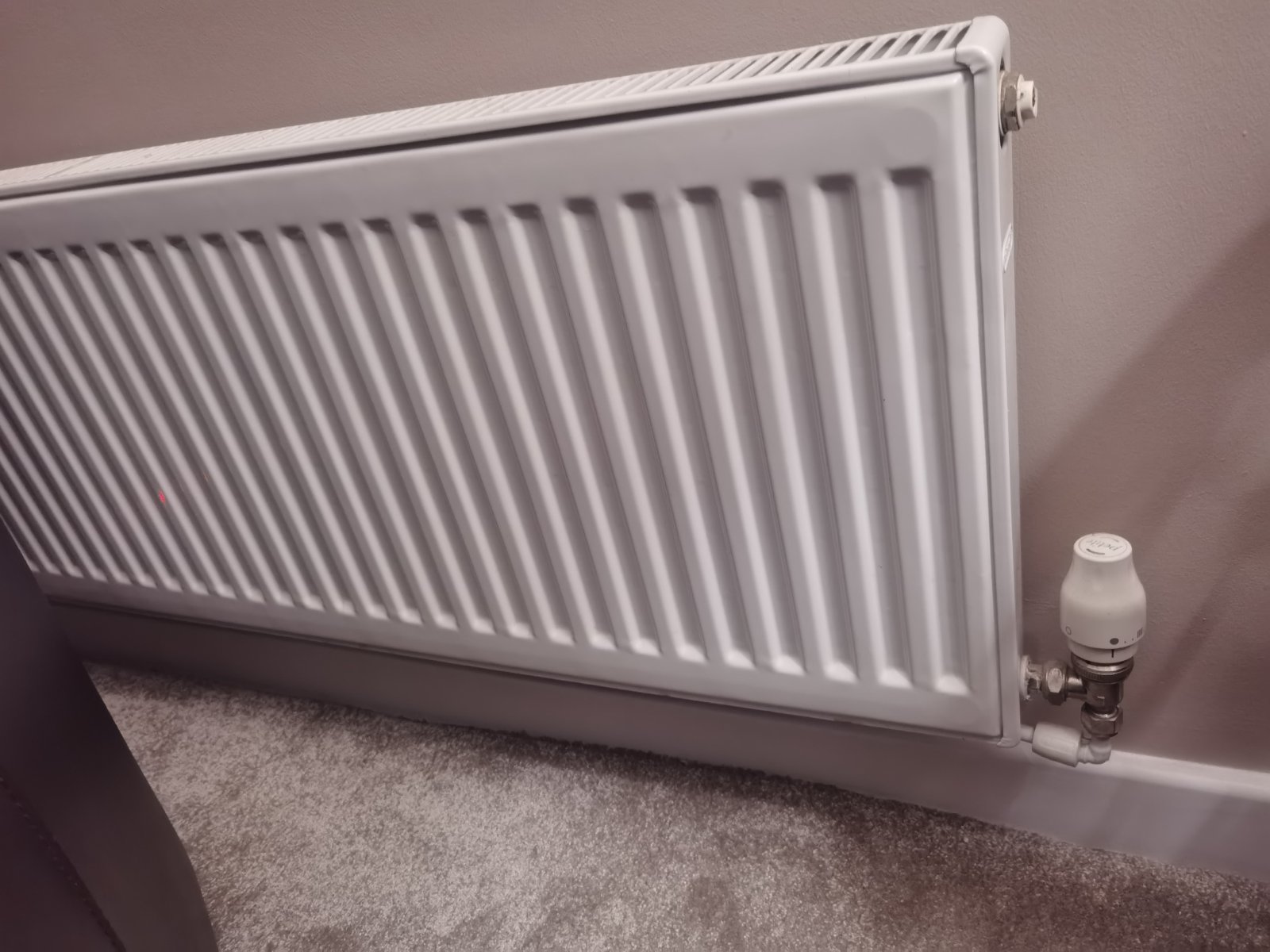

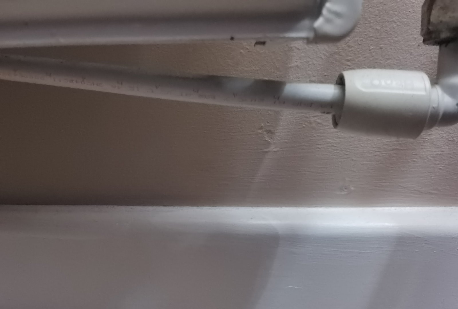

We're having a log burner installed in a month or so and we need to remove the radiator. How easy would this be? It looks like it's speed fit piping.
Close the valves at either end, you can then take the radiator off, after draining it. Removing the stubs of pipework, will need the system draining. Why not leave in place, working - you may not always have the stove lit?
The stove is going in the corner, the idea is to use the stove to save some money on the heating,so didn't think we'd need it and well it's in the way.
