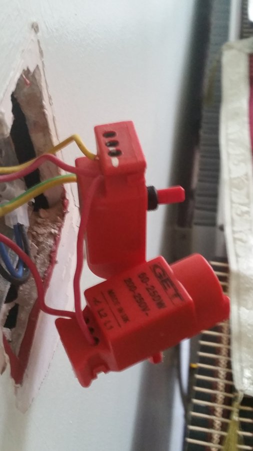

Am very confused about the wiring. Blue and black connected together - and what is the yellow - not earth I think.....
Not sure how to connect an ordinary double switch. Can anyone help please?
The yellow and red from the squiggly line terminal go into the two L1's on the new switch, and then the reds that are joined together in L1 on your current switch go into the commons on the new switch
Sorry - the picture is the old dimmer switch and I want to replace it with an ordinary double switch.

What you have is a green and yellow cable/cables which are the earth, these are connected to the earth terminal of the new switch plate or the backbox if the plate does not require earthing.
The Black and Blue cables are a looped in neutral and the stay as they are.
The red in L1 are your permanent live or common or maybe L on a standard rocker switch, the red cable link between them offers a perm live to the second gang switch still com (common) or L.
The one left over red and yellow are the switch lives that are terminated at L1 or L2 of the new switch, one on one gang and the other on the second gang.
The yellow is connected to the L1 terminal - not the squiggly one. The squiggle one had the reds going in and out.So, in that picture the very top terminal of the three shown is L1.
Perm live to com/L of new switch.
Spare/switch lives red and Yellow to L1 of each switch
Do you have a voltage indicator to ID perm voltage.
Can you tell me from the photo which wire is the perm?
I managed it. And yes I will get the voltage indicator - or can I use my little screwdriver with a light in it?
