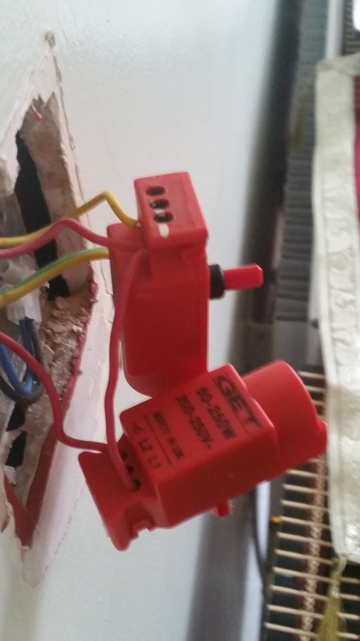

How to replace a double dimmer switch with a double one way switch
Can you tell me from the photo which wire is the perm?
The ones with the reds in that are linked across the two dimmers.
I managed it. And yes I will get the voltage indicator - or can I use my little screwdriver with a light in it?
Thank you anyway for all your help.
Denis
