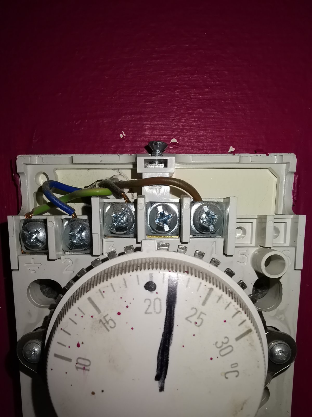

Sorry to jump on this thread but I need help replacing a room stat.
The boiler is an old oil fired worcester danesmoor 20/25 with a honeywell roomstat, I'd like to change it for a salus rt510 or something similar, the current roomstat has an earth, a live, a negative and a black wire (not sure if this is a switched live) I wired it all up yesterday and it powered up but had no control of the boiler, if the black wire is a switched live how do I return the signal back to the boiler. Any help would be great.

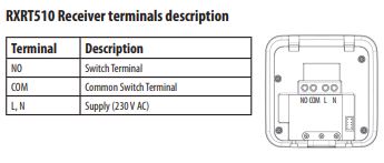

Now you have a separate thread going, I will see if I can assist. If your Salus receiver looks like below, and the original thermostat was switching 230V to the boiler....
...then:
The Live and Neutral go to L and N respectively
The boiler switched live goes to NO
Then you add a link between the L and COM terminals so that they are joined together
If anything is different or you are unsure, post back. The model number of the original Honeywell thermostat and where each of the wires went would allow positive confirmation.
Hi Stem
Do I just disregard the earth or attach to a fixing.
Regards
Steven

Thanks for the photo. I can confirm that:
Brown wire in 1 is live
Blue wire in 2 is neutral
Black wire in 3 is switched live
So you are OK to proceed as per my earlier post.
I usually put the earth in a separate screw terminal and tuck it safely out of the way so that it doesn't inadvertently contact anything.
The new thermostat is a programmable thermostat, which means that it incorporates both time and temperature control. Your old thermostat doesn't have time control, so will probably be connected to a programmer / time-switch elsewhere. If it is, the heating control at the existing programmer will need to be set to be permanently 'on' 24/7. that way it will allow the Salus to control the time & temperature of the system and not interfere with it.

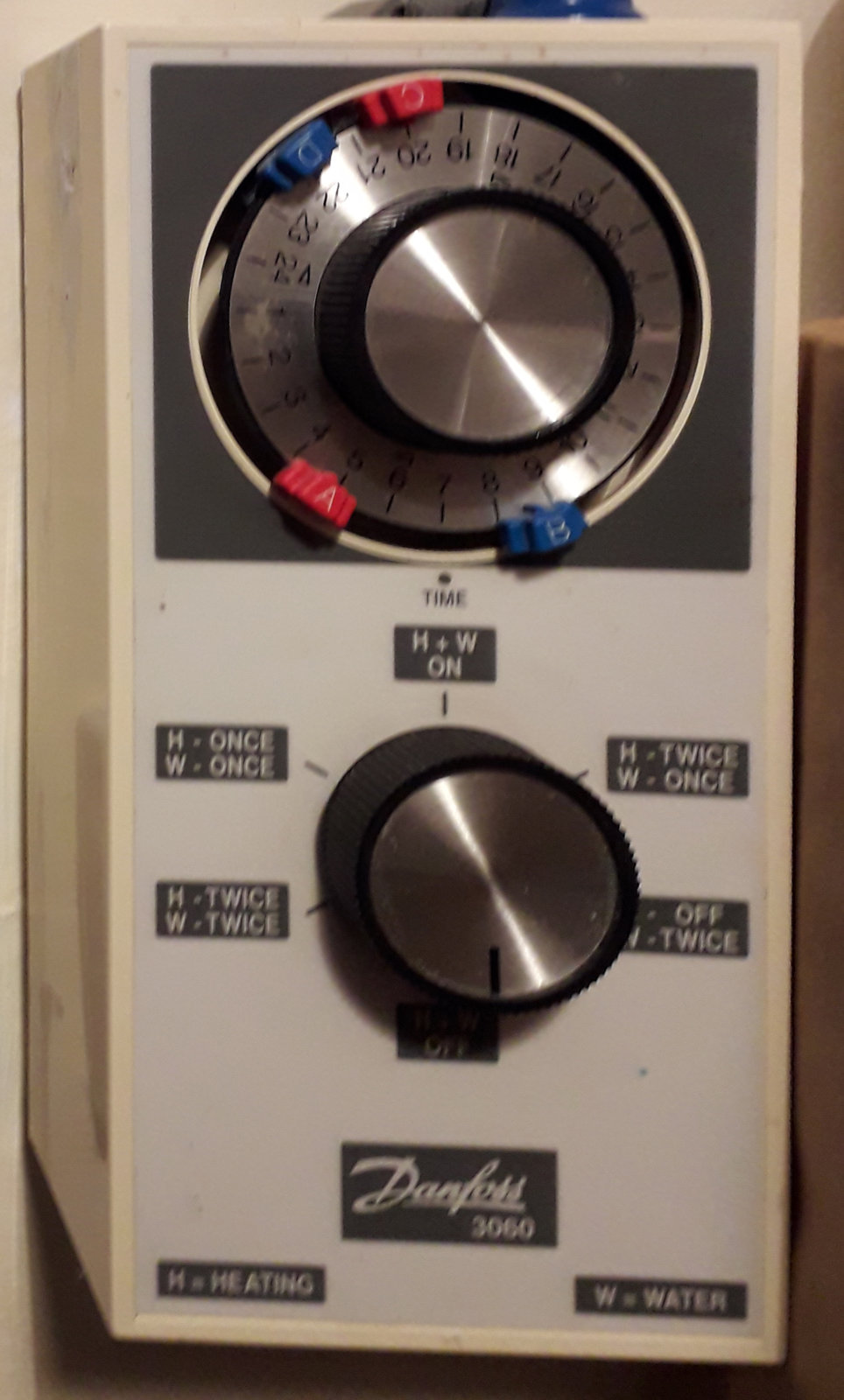

Danfoss3060programmer.jpg My boiler nearly the same as yours the original programmer had an option for DHW without CH but not CH without DHW. I was advised when I swapped the programmer that since the old oil boiler has no cool down time, it was better not to put any motorised valve on the DHW, I may have been advised wrong? However the new system is the same, can't have CH without DHW, and in winter I turn off the DHW timed heat as it does not need it.

View attachment 180806 My boiler nearly the same as yours the original programmer had an option for DHW without CH but not CH without DHW. I was advised when I swapped the programmer that since the old oil boiler has no cool down time, it was better not to put any motorised valve on the DHW, I may have been advised wrong? However the new system is the same, can't have CH without DHW, and in winter I turn off the DHW timed heat as it does not need it.
