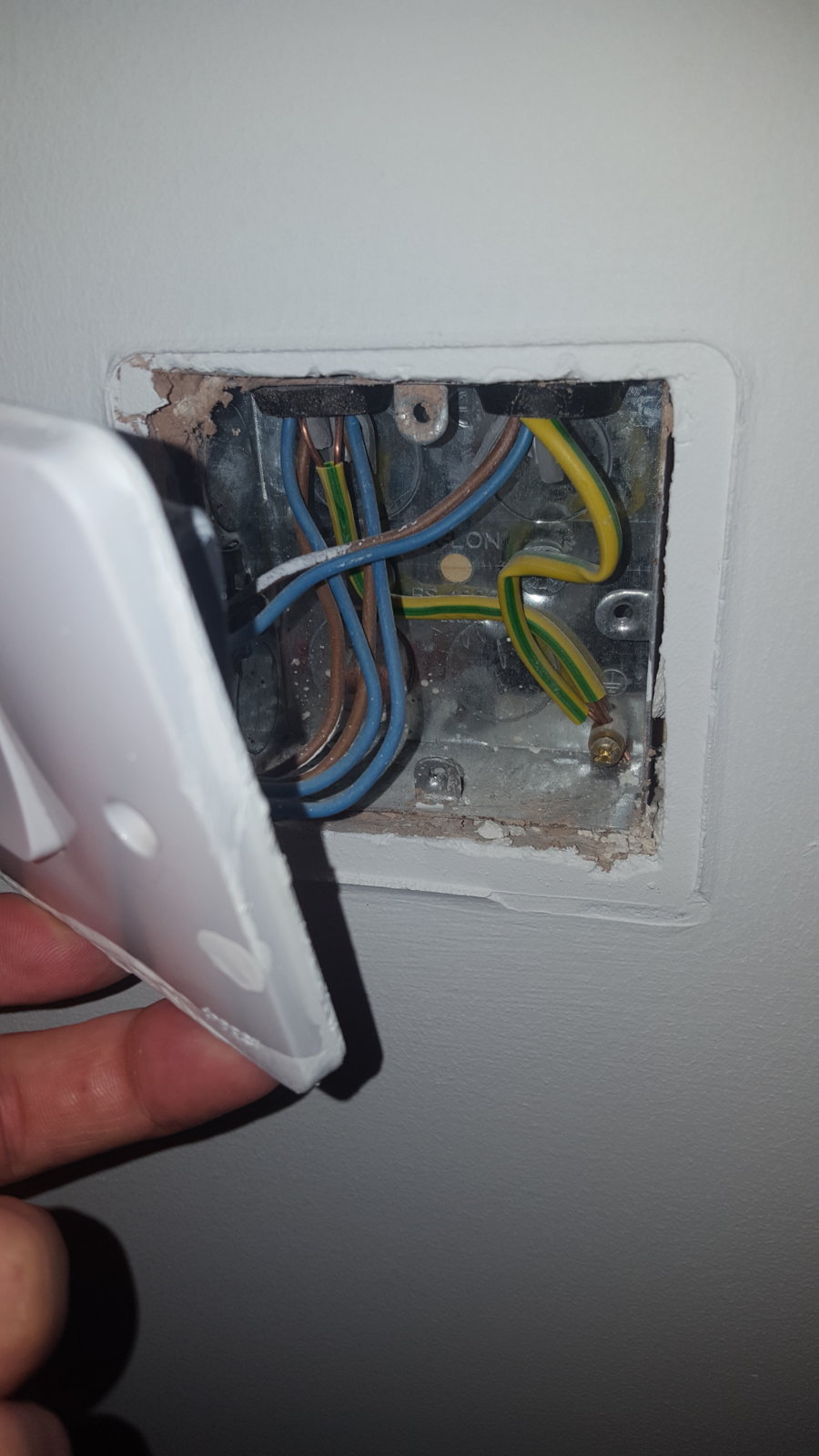

Hi just not great at electrics and would like some advice how to replace this light switch with this chrome switch
h
Firstly, do you have earth wires with a green/yellow sleeve on inside the box in the wall? (Another piccy maybe?)
You have bought the wrong switch.
You need a switched fused spur with or without neon, and just copy old to new connections.
If the new spur is metal it will need to be earthed.
No.

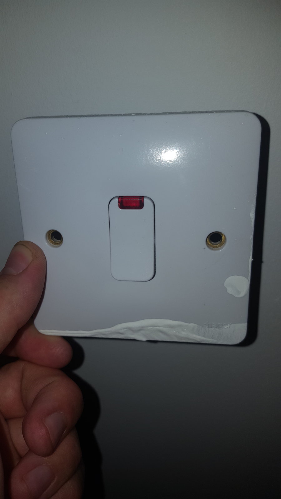

What he has now is a 20A DP switch, not a fused switch. I am therefore assuming it is on a 6A lighting circuit, and, whilst the new switch is not 'the same', it will be fine to use, as long as the earths are present(as you say).
Because it didnt have the fuse symbol on front i assumed it was a normal switch, its earthed inside as shown

What he has now is a 20A DP switch, not a fused switch. .
Yes, you are correct, but either way the connections are the same.

And what about the Neutrals?

Tommy,
You need to join all the blues together in a single connector block, this just gets tucked inside the back box.
The two browns which are together now, move them both to COM on the new switch.
The lone brown, put that in L1.
Move the earths from the back box and connect them all to the earth on the new switch.
