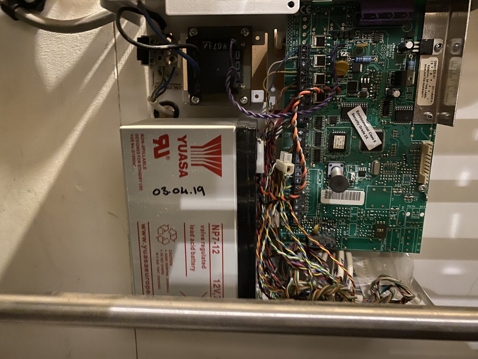

Hello
I replaced my burglar alarm 12v battery which has died.
I am now getting this lid temper warning because I opened the box to replace the battery, which doesn’t allow me to set the alarm and call installer. I don’t have the engineer code, tried few defaults but nothing worked.
The company which has our engineer code wants 210£ to come and set it.
Is there a way for me to do that without having to call them on ?

Post picture of control panel is there a fuse isolator at the side of it
I tried the default one yes, doesn't work, and the company who holds it wants 210£ to have it removed, not giving them that pleasure.
The control panel has a fuse box next to it which I believe is alarm related but then again I'm no expert.
Is that important to the procedure above ?
Pull fuse out , disconnect battery …short the two pins with screwdriver keep it shorted push the fuse back in , keep it shorted for 10 seconds, it should be 1234

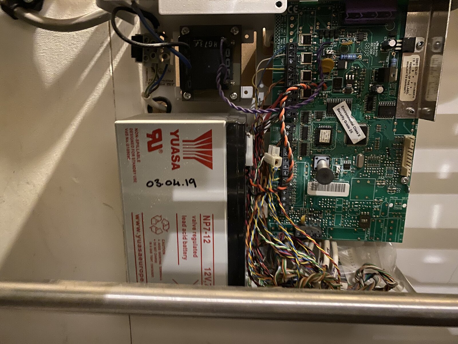

Here’s a picture of the board if it helps. The fuse box is next to it, not in the picture
I tried the procedure today, it doesn’t work.
I tried keeping two screwdrivers on both pins pairs. Any chance I need to use something else to short circuit them ?

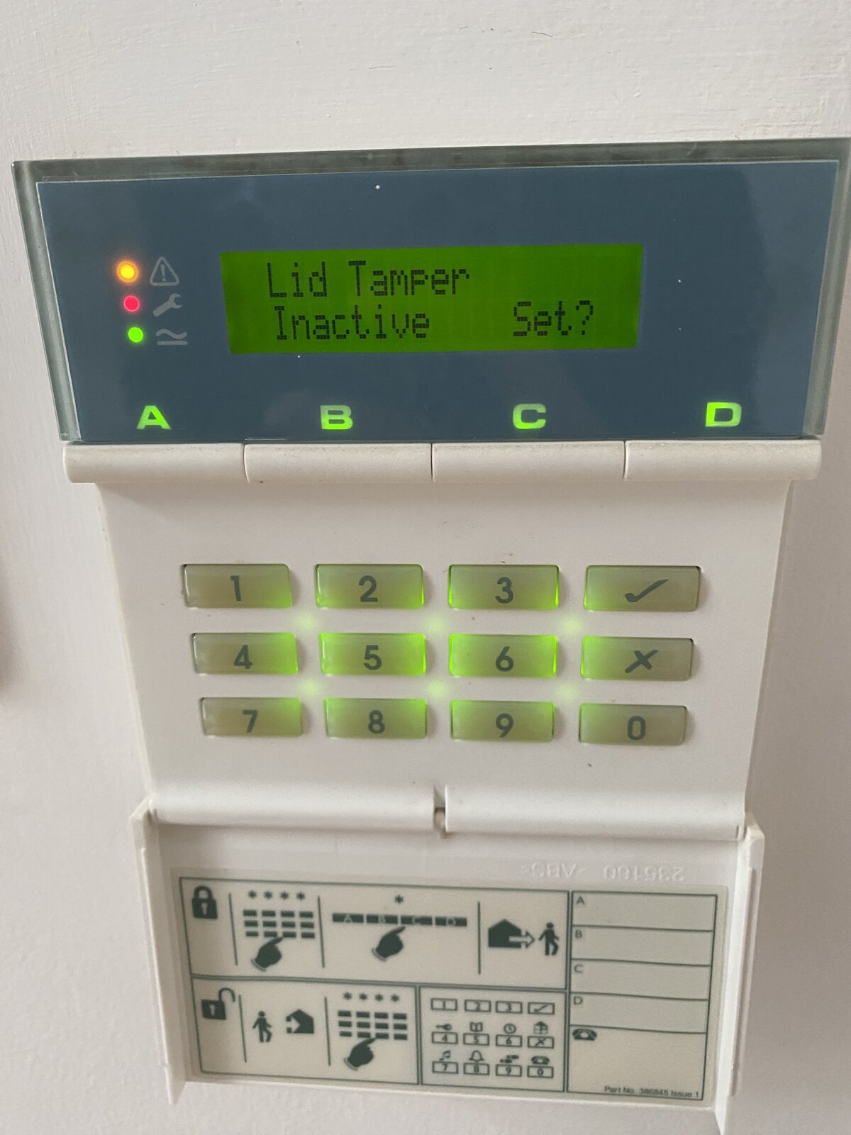

Think I’ve managed now I’m in installer mode with the default code ! How do I apply the temper changes and exit tjis mode ?
By the way, how do I now change the engineer code from its default ?
