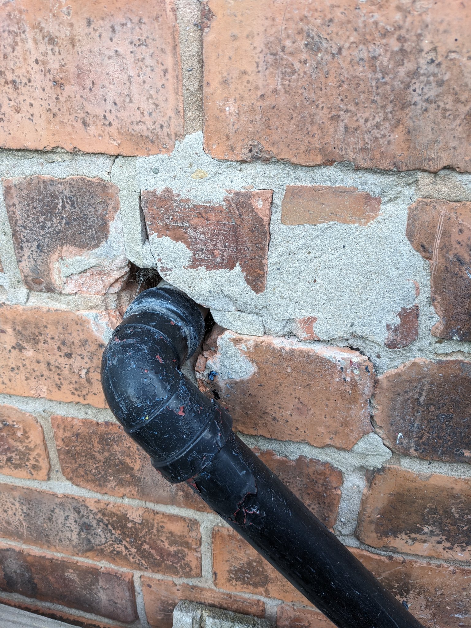

Basically what it says on the tin. The drainage pipe for my washing machine is sitting loosely in a hole in the kitchen wall (see picture). This feels like it's risking damp getting in and causing mould.
My question is, what's best to seal it with? Expanding foam? Some sort of sealing/grout? Concrete?
Any advice is appreciated!

When I repair brickwork like that I cover the bricks and only the bricks with duck tape.
Now you can get busy filling with sand and cement using the correct colour sand and mix to fill.
Give it a hour or more to set or even the next day and remove duck tape and brickwork is spotless and clean.
Just makes it easy.
You could replace the bricks above pipe and tidy that nicely very easily.

I would remove the 2 half bricks and replace with a whole brick with a corner cut off for the pipe.Have a look for a product called Milliput it comes in colours that you can blend to match the brick for the damaged brick

If you're drilling a hole like this keep all the drill dust. If you use a core drill there wont be much dust, and it'll be mixed with mortar dust. Separate the solid bits of brick in the core from the mortar - discard the latter. Crush the brick up, eg using a lump hammer as an anvil and hit/ crush with another hammer That's easier than it sounds. Make a neat job of filling so the brick shapes are cleary defined from the mortar, then press the crushed brick dust into the mix you filled just the broken bricks with when it's getting dry.
From a bit of a distance you don't see that the bricks were filled. Have used similar when repairing tuck pointing.
It is too late for you, but if you can find a brick which is a similar coulour to your originals, drill that - it's better than nothing.
There ARE black rubber collar things you can use (google) but they only look ok on a neat bit of installation, I think. If you've got a mess like you have, they only draw attention to it.
Thanks for the advice everyone! One of those tubes of ready mixed cement sounds good; I'll give it a go.
