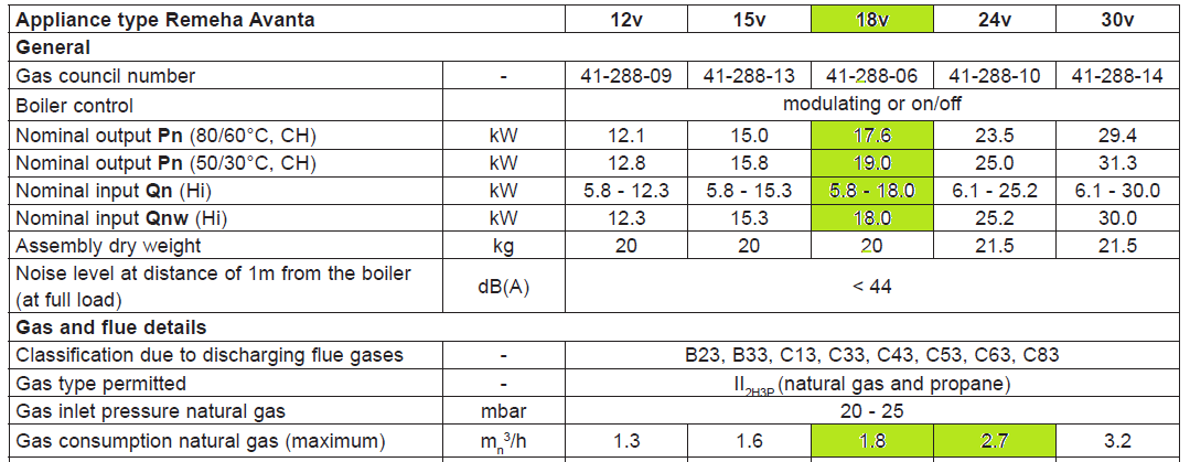

Take another look DH...the max gas consumption stated in the manual is 1.9m3/hr.
1.9/0.094=20.2kw/hr..:)
Oh dear.
Oh dear, indeed! I suggest you have another look at the manual - here's the relevant info:
Oh dear.
Oh dear, indeed! You have been looking at the wrong manual - I have an OV boiler, not a system. Here is the relevant info from the Installation Manual:
(Don't know how the 2.7 got highlighted)
