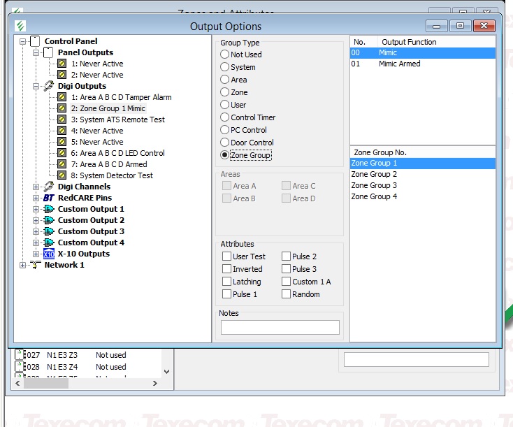

Dear sir ,
How to set digioutput from control panel premier elite 48 with texecom speech dialler please? I connect (set -ve)
digi 2 to trigger 2 (of speech dialler) and set group type AREA + areas A +output function FIRE ALARM
digi 3 to trigger 3 (of speech dialler) and set group type AREA + areas A +output function ALARM
digi 4 to trigger 4 (of speech dialler) and set group type AREA + areas A +output function GUARD ACCESS ALARM (PIR)
but when i test with PIR and the system alarm , speech dialler don't dial to my phone . ON test speeck dialler alone it 's OK
what is my wrong setting , Could you please suggest me?
Digi outputs not set right , if you are using the digi outputs ! Eg digi output 3 for alarm to input 3 on speech Dailer ....needs to be area A and alarm not ATS in your screen shot
