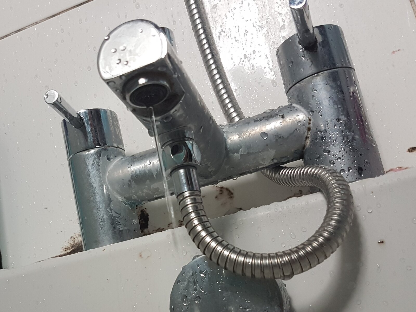

hi all,
I have a leaking bathroom tap, heres a pic, including where its leaking from as you can see drip.
Anyone any idea how I can fix this?
Thanks.

those on/off levers are quarter-turn, I presume?
Then they have ceramic disc cartridges in them (not tap washers). With luck, it will be possible to find one that fits. If it is an unbranded import, maybe not.
There is a good range at Lunns.
https://shop.lunns.net/tap-spares-8-c.asp
You might be lucky and find your local DIY shed has ones that fit. You'll need to take out the old, measure, and count the splines.

Get a plumber to install a new stopcock in your house and repair the tap at the same time, there is no way to fix your tap without turning the water off.

"I wouldn’t waste time or money trying to repair it, I think it would be more cost effective to replace the whole mixer tap."
But he said he may have to remove bath panel? Is this correct? And no way to do it without removing bath panel?
If your not too worried about how your taps look a tap reviver kit would sort out the drip without having to remove the bath panel, you will still need to have a stopcock fitted.
