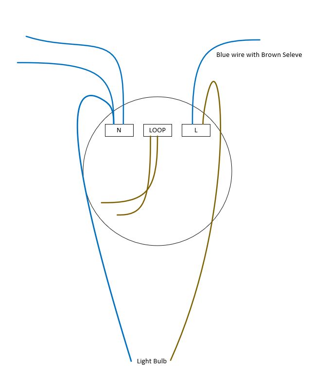

Hi
So i've investigated my lighting upstairs - basically it appears to be a loop at the switch installation - which means bar one ceiling rose the rest all only have one cable which runs to the switch and the other to the bulb holder.
At the switch there are 2 live wires in com and 1 brown wire in 1 way and the blues wires are just terminated - off course there are earths but lets not worry about them
I also know which is my last light switch and also one ceiling rose appears to have the 1st feed from the consumer unit as it has an additional wire and is right above where consumer unit is downstairs so would make sense too
Thats the background - now my question is where should i look to get the power for putting a switch and light in the loft
1) Will be too hard to run cable to switch and back into loft to keep switch loop
2) Can i take it from the ceiling rose which has the additional wire so i just add my neutral, live and earth and sort of create a split of the loop - [See wiring in picture]
3) Can i take the power from the other ceiling rose - i feel if i do this, if the light i take cable from is off the loft light won't work unless i put this light on too
4) do i trace the loop wire from switches somehow - not sure how - and put in a junction box and split
For me it seems like 2 or 4 is best option with 2 being possibly the easiest

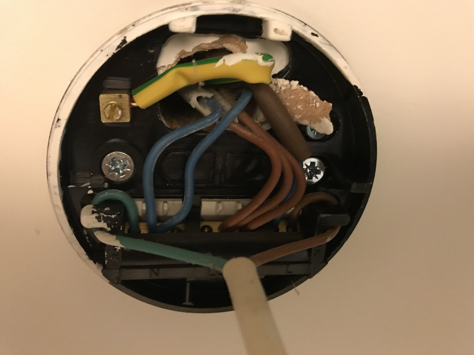

If there is a permanent live at ceiling rose ( option 2 ) then take a feed from there( together with a neutral and earth obviously). You need to know if the "extra" wire there is actually a permanent live ,what does it connect to at the rose ,can you show pics ??

Image included i did do a diagram above but noticed actually there is an additional live and neutral - i'm not sure how i'd tell if it's permanent live but out of the lights on the upper floor this is the only one wired like this

That rose looks a good place too.

The rose in your pic has permanent live ,neutral and earth. So you can pic up your supply there. The three brown conductors in the centre terminal block ,one of which is live supply in.

Terry - would i just drop cable and you can see a spare neutral and live slot in the ceiling rose - just wire from there and off course only one place for earth - run that to a switch or pull cord and from there to the light ? - Just trying to get it all worked out before i get into loft
Run a twin and earth cable into the rose ,connect earth conductor to the existing earth's ,neutral to the neutrals ,and live to the "loop"terminal that has the 3 brown lives. Take the other end to a switch ,and from switch to the light fitting in loft.
Just in case you don't know ,only the live conductor would connect to the switches terminals on a standard one way light switch.
