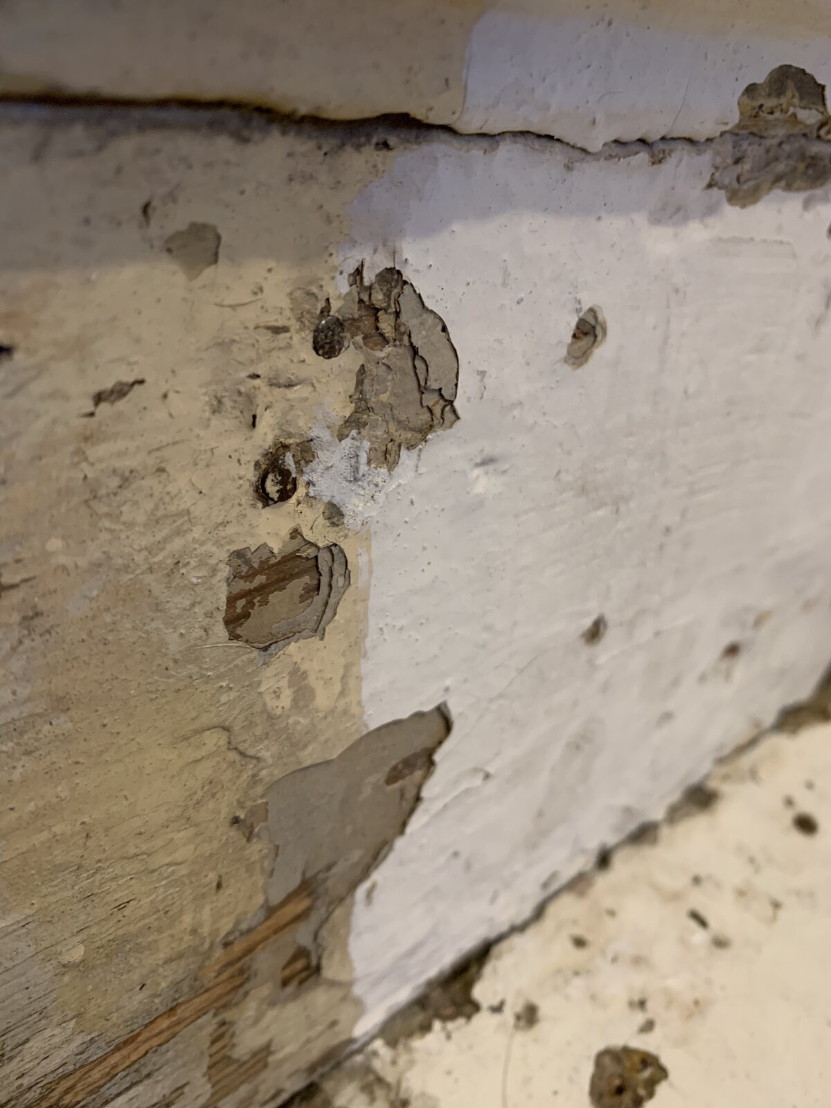

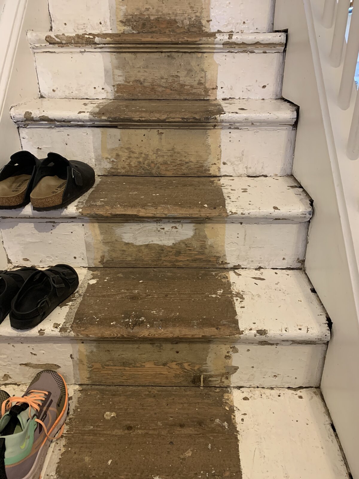

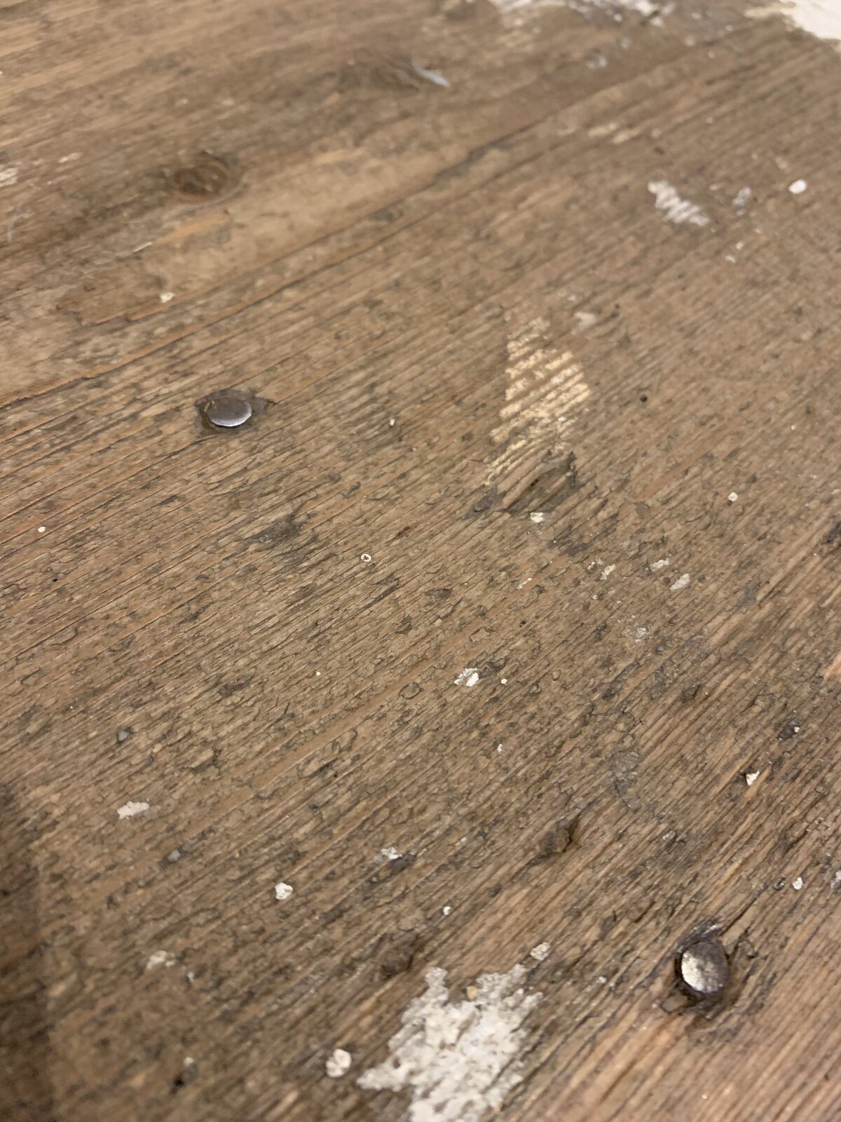

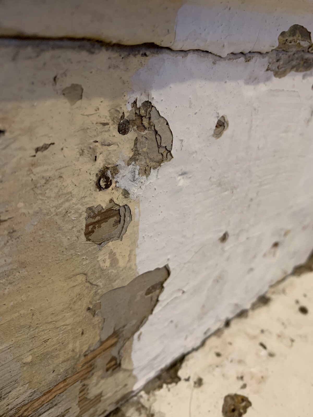

Hello
Old Victorian house - different layers and patches of paint. Looking to get it back to plain wood.
Anyone had experience with a stripper product called ‘Kling strip’?
Reluctant to sand cos of lead paint.
Any advice on best approach appreciated

The older version of Nitromors used to be good, but the new formulation is rubbish. Fortunately you can still buy caustuc soda - needs to be used with care, though (old clothes, rubber gloves, goggles hood ventilation, always add the caustic to water NEVER the other way round, etc). Even with a good stripper there will be a LOT of scraping and sanding to do (wear a P3 mask and put a HEPA or P3 filter vacuum on the sander)
Like Job says the old Nitromors is a lot better than the new version. But the new version will work.
I've not tried caustic soda.
There is another product you could try called 'PeelAway' which I've seen being used, but not used personally.
I can vouch for the Nitromors but it will need many applications and a fair amount of time and patience.
The end result will be nice. I can see why you want to see the grain of the wood. It's beautiful.
p.s not tried Kling Strip but the reviews suggest it's good enough to have a try.
wear PPE and open a window. Allow to act then scrape the goo into a foil container.
