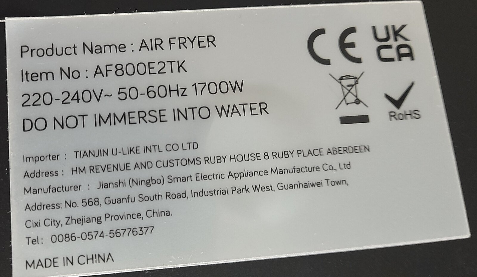

Air Fryer label.jpg The label, 1753546671465.jpeg what it looks like, I have tried to find instructions, wife lost them, likely from Temu works well, but selecting left, right or both get it wrong again and again. Any ideas?

I found my error was not pressing finish, so press 1 and set temperature and time, then press 2 and set temperature and time, then finish, then the run button. If one side only set, one display shows temperature the other time, if two set, both displays alternate between temperature and time.
I know to test by opening draws now, but setting it to do chips, only to find chips were in draw 2, but it heated draw 1, is not funny.
Does the tray number light up to indicate which tray is active?
No, the only way I can be sure, is to open the draw a bit, and if active the fan stops. The unit does work well, now I have got rid of my wife's silly rubber liners, which stopped the special sculptured base from doing its job to direct the heat around the food, I am slowly learning how to use it, but would have been a lot easier with the instructions.
