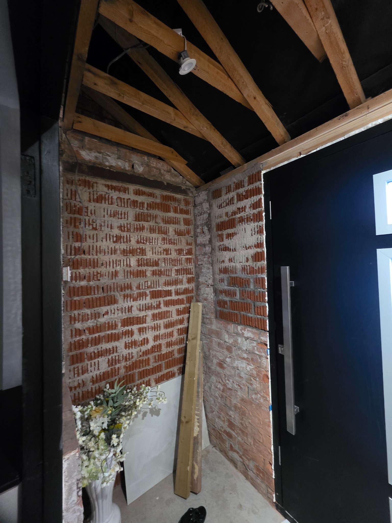

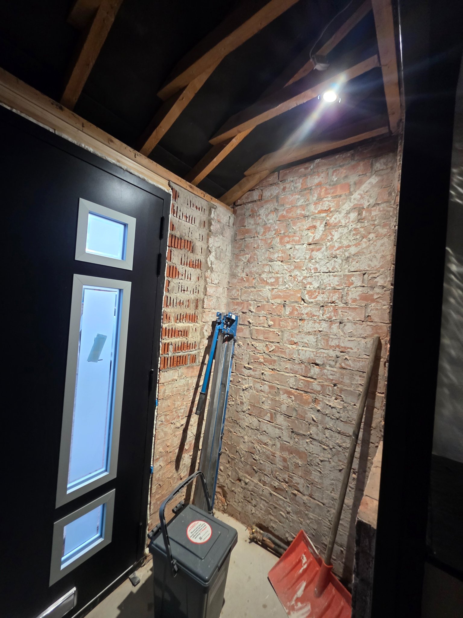

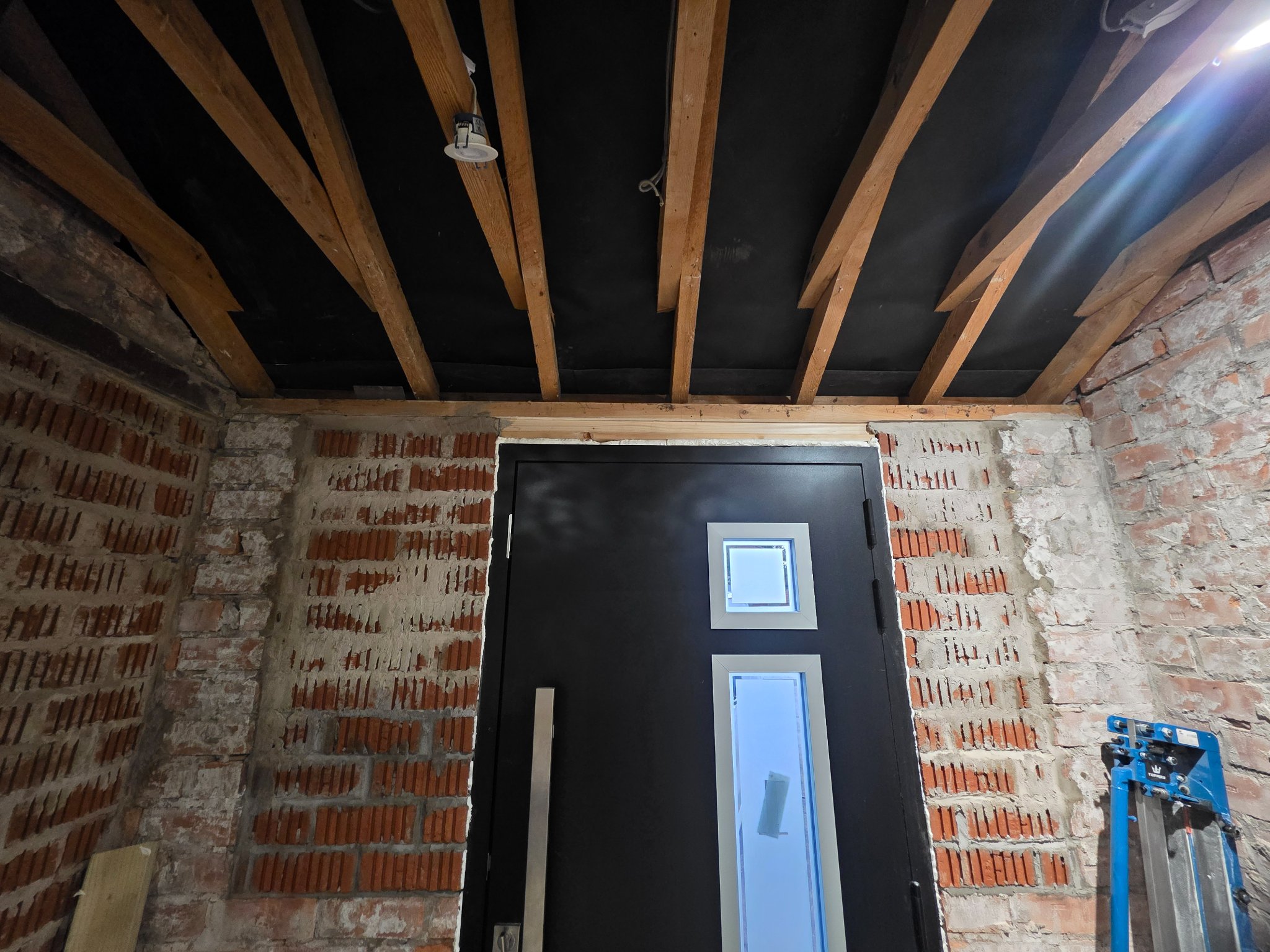

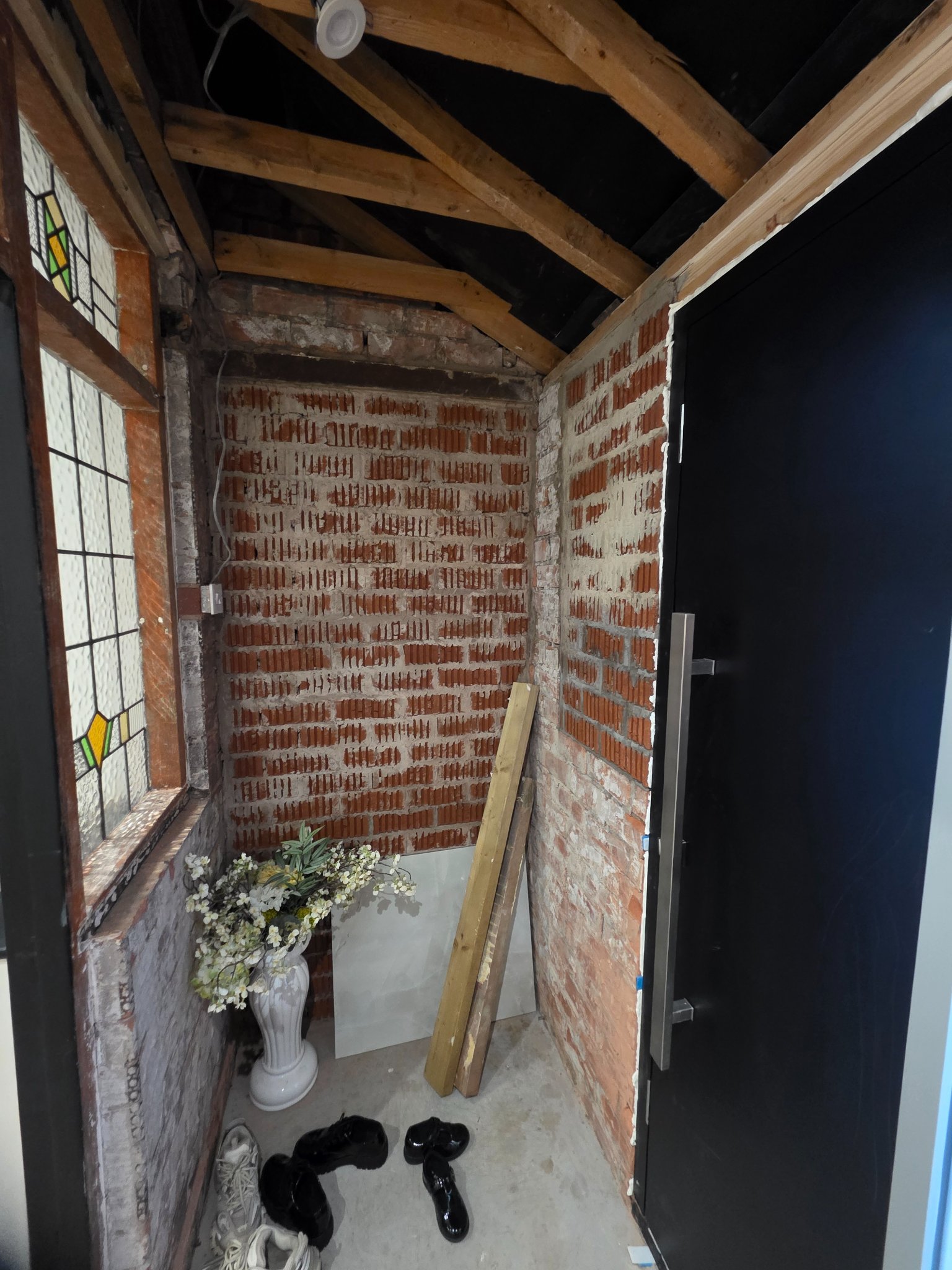

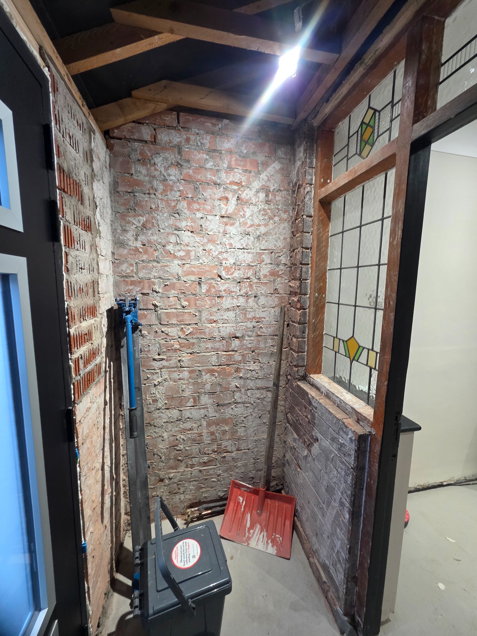

Hello everyone. After some advice on a single skin brick porch 3 external walls.
What are the options to waterproof and insulate. There is no dpc fitted when previous owner had it built. There serious issue with penetrating damp on the walls. It is concrete base.
I Will be tiling the floor and wanting to fit a vertical radiator on 1 of the wall.
Should I use a liquid dpm on floor and walls, or tanking slurry. battern the walls, celotex insulation then plasterboard ?
Whats your thoughts?

Follow this guy.
I've done it myself a few time's.
The other way is to screw timber frame to wall.
Kingspan in the timber frame.
Kingspan will act at a vapour barrier so no need for membrane.
Plasterboard over.
Thank I thought so. Just use treated timber or belts n braces or sandwich dpc between battern and wall
I just used treated timber.
I didn't bother with membrane.
It is dry and not wet enough to cause timber rot. Well for the next 100 plus years.
I'd just stick insulated plasterboard on wall with foam though. That's easier
