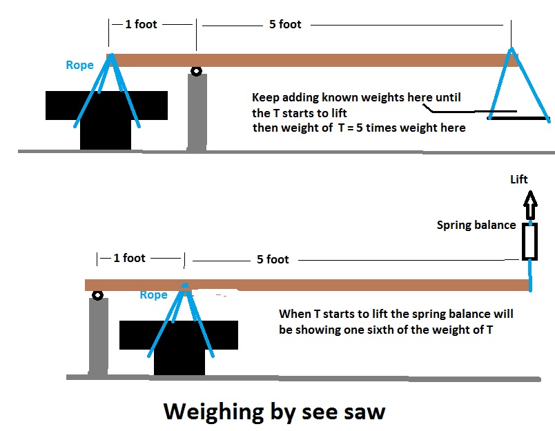

One of these might work if you really must weigh it.
The second method is the better one if you a suitable spring balance
