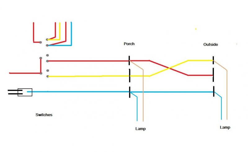

How to wire a ceiling rose - four core cable
At the first light, connect both reds to 'Live', both blues to 'N', both yellows to 'Loop' and cpcs to earth.
Given that we have only two blues at the switch and one of them appears to be to the Neutral terminal block and the other to the L1/L2 at the switch - wont we be putting both a neutral and a live/switch live in the Neutral block of the ceiling rose?

Since the switches have not been touched, I presume I just need to work out the feeds and connections at the ceiling rose. Is that possible from the information provided?
It's possible given a multimeter and a knowledge of how circuits, and lighting circuits in particular, work, for you to do all that.

It turns out that I was doing things right in the first place but it was only when I was sure about that that I was able to sort things out.
I finally resolved things by establishing that the porch circuit was working fine and that there was an issue on the feed to the outside light (on the yellow wire from switch 1 to the ceiling rose)
Once I knew that I was able to resolve the problem by changing the red feed into the circuit as suggested previously and everything then worked as it should.
I've no idea why I needed to change things at the switch since they'd not been touched but I got there in the end.
Thanks for your help and your patience
