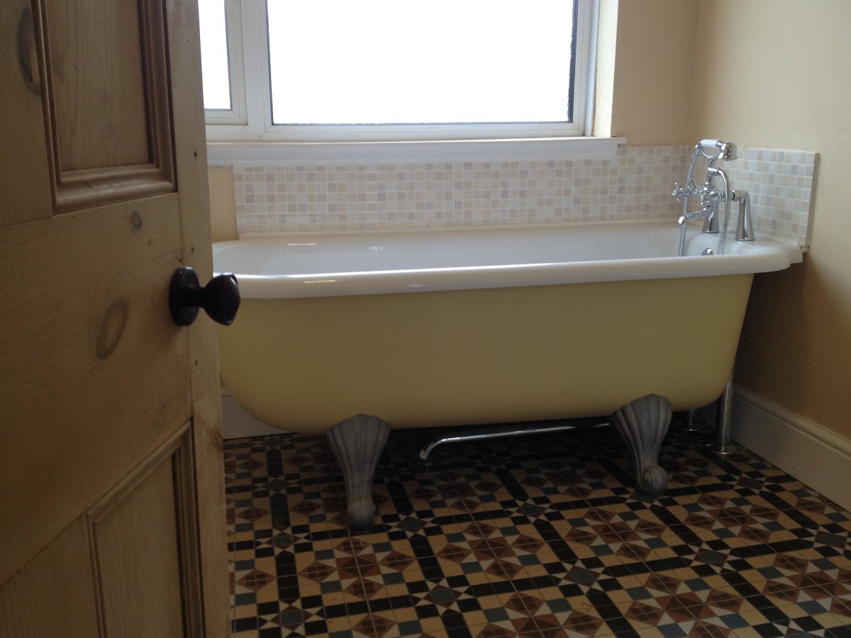

Received the Tre mercanti P trap today (from a different supplier) and the neck on the trap is longer and therefore has solved that particular problem!
The one thing that I have noticed that there is a removable (unscrewable) 'collar' on the Tre mercanti and it looks like the original P trap had a removable one as well (see photo). I don't know if I had just changed the collar for a longer one, that would have solved my problem?
Now onto my next problem (the chrome waste pipe measures about 35mm, but the P trap is for a 40mm).........

I hope that waste pipe doesn't terminate into soil and vent stack..:)
