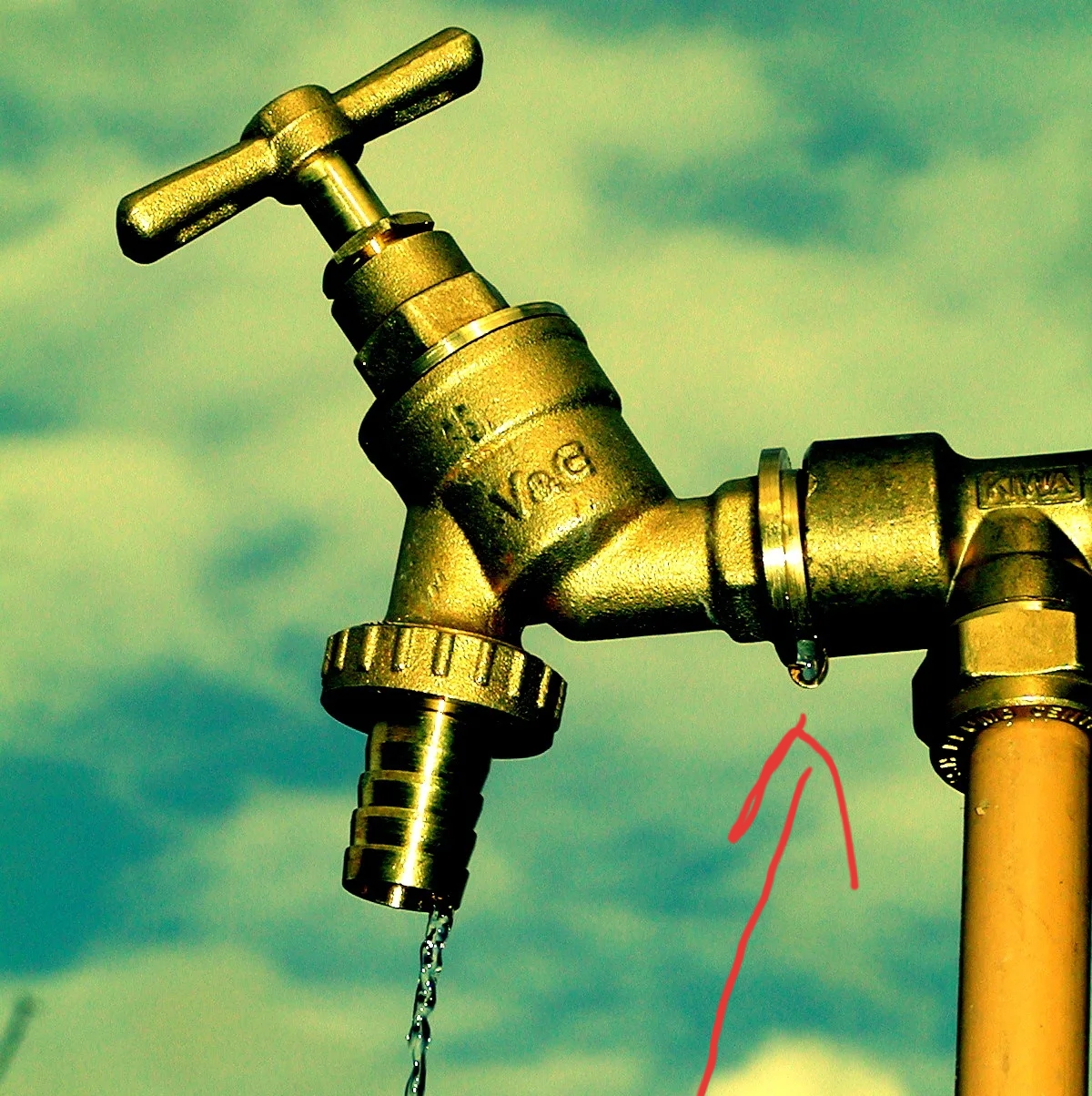

20210703_103556.jpg Sorry for the basic question, but I'm having a senile moment.
How's the washer that goes between garden tap and wallplate called?
1. If there were a washer there, it would be a fibre washer.
2. Its likely that the thread on the back of the tap will bottom in the wall plate elbow before any washer goes on.
3. The normal way of sealing an outside tap to a back plate elbow is with one of:
3a. PTFE tape. You'd need to experiment with the number of turns necessary to create a seal and still leave the tap spout in the correct position. I'd start at 10 turns and go up from there. You can't turn the fitting back if it goes too far and expect it not to leak.
3b. Loctite 55. This is a sealing cord. Very similar to PTFE, except its wound one across the threads, which should be slightly roughed up with a file. Can be backed off up to 1/2 turn without leaking.
3c. Loctite 577 (expensive) or Flomasta Pipe Seal (Screwfix 4373J). Both are thread sealants. Clean components, run a bead right round the second and third threads in, assemble in correct orientation , wait 1/2 hour, job done.
That's a google image just to understand the position of the washer.
I looked at mine, next door and my mum's and all have a black rubber washer there, so I assumed there should be one.
