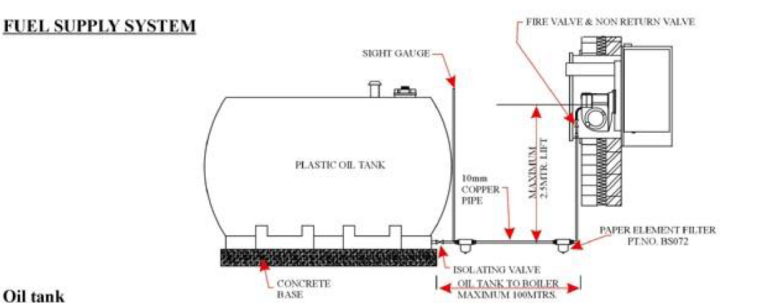

Here's your spec, if the "fire valve & non return valve" are one, which they appear to be, then presume it is installed vertically as shown?, if the NRV isnt 100% tight then would imagine that the oil in the pipe below it could empty out down to the level in the oil tank and even though the pump can lift 2.5M then it would have to fill or at least partly fill this line again, by which time the burner may have tripped out even though it does a ~ 12 sec purge and then allows 5sec to flame detection. Maybe a very lightly loaded spring typoe NRV installed at the tank outlet may help?. If the boiler runs OK during the day but is inclined to trip in the morning after say 8hrs off then more time for the oil to drain back.

yes it is vertical, top of tank to bottom of boiler is about 1/2m, present oil level to bottom of boiler is about 1.5m
The oil is pulled through immediately so must presume the NRV is working - it is a new Valspar one but is displaying the same as the old one did

next thing to try is coupling the clear pipe directly to the incoming oil pipe bypassing the fire and NR valve to see if the bubbles still happen.....
cant really see the point of the fire valve anyway as, should a fire happen and the pipe melts the oil will simply drain back to the tank....I can fully understand it's purpose if the tank was higher than the boiler.......but it isnt

Is the oil level in your tank when filled above the pump suction and if so how far does it have to drop before its below the pump.
