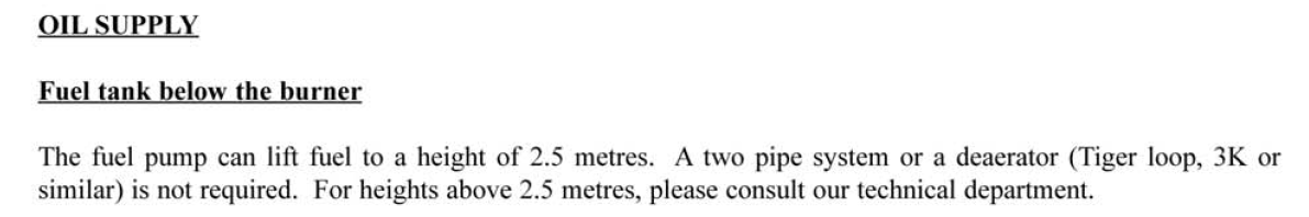

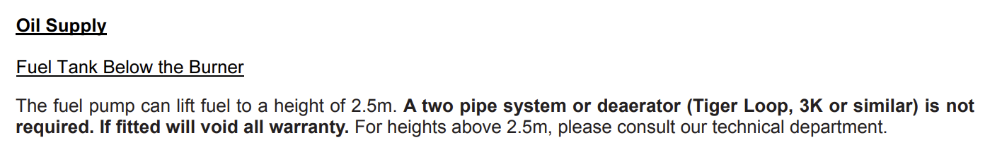

I don't know why your engineer and others say that a Tiger Loop is not recommended, the MIs I looked at just said it's not required?, because it's a deaerator I can't see why it isn't highly desirable to install one where the tank is below the burner, anyway, all's well that ends well.

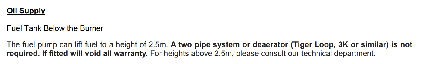

the manufacturer instruction specifically states that tiger loopMUST NOT be fitted and doing so will invalidate warranty!
I am wondering if they are referring to a two pipe system ?

Wonder why installing a T.loop during warranty invalidates it.
