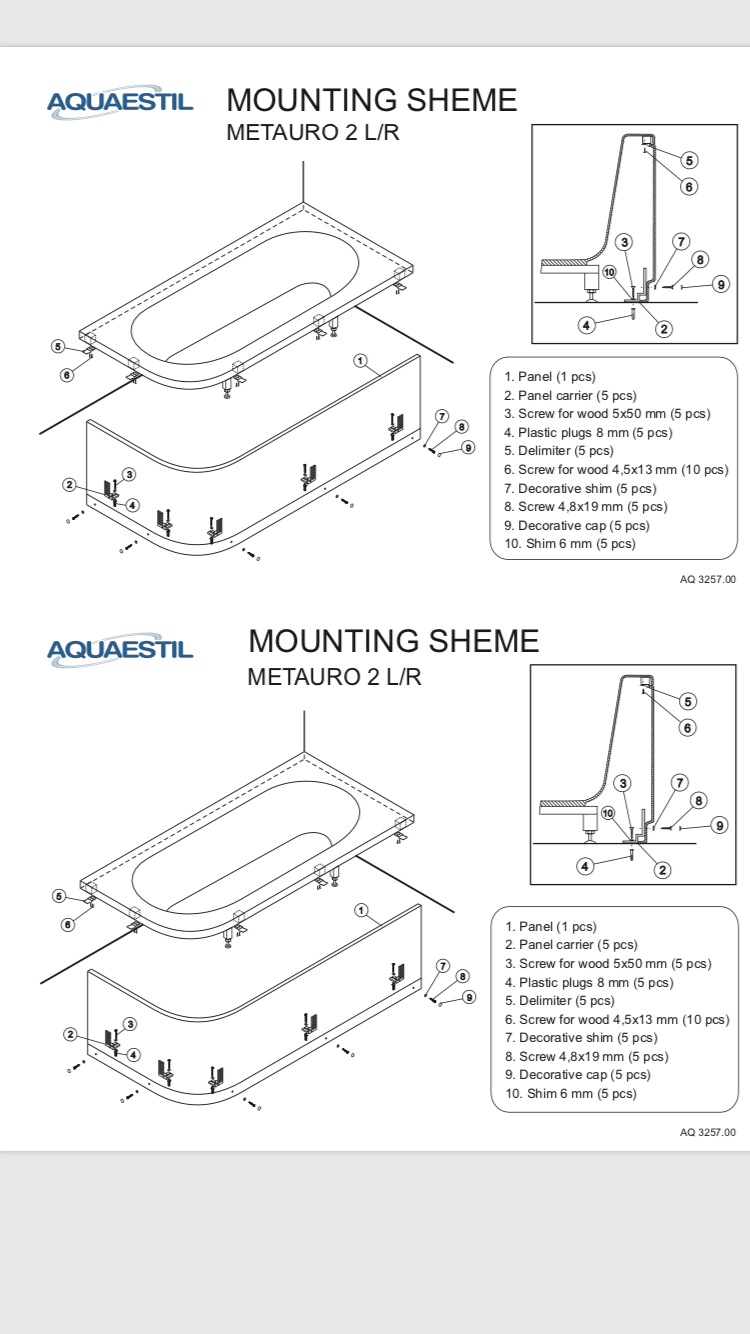

HTF do you fit this bath panel??
27 Jul 2019
It’s an aquaestil metauro
These are the instructions:

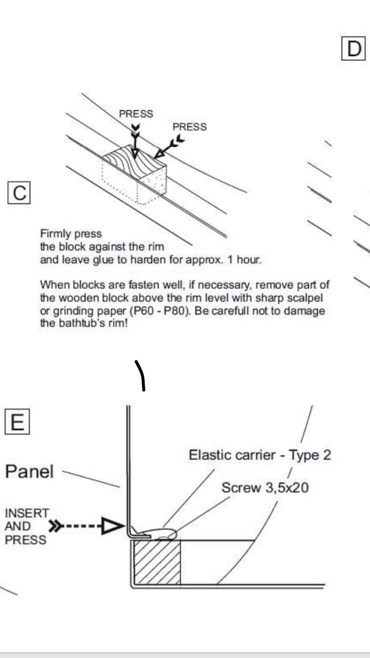

How would I go about aligning the floor brackets correctly?
Then how on earth can I screw the panel into them?
It’s taken 18 months (literally) figure out how to attach the wooden blocks that hold the top of the panel in place
I’ve never seen instructions as useless as these

It's not clear but....
Presumably you need to fit several wooden blocks in place on the floor, and under the rim of the bath, in just the right place for the panel to butt up and be in the correct location?
In the past, I did something similar by getting some scrap wood, making it into blocks, and cutting a slot in the top. When screwed to the floor they could move forwards and back but not side to side. Tightening the screw will allow you to test fit the panel and adjust the forwards/backwards (start with it forwards) .
Once the test blocks are in place you can mark the floor to indicate the front line of the block and replace them with the proper blocks, by joining the marks on the floor to make a full line.
Then possibly the same idea at the top, you could use a straight edge and spirit level to find the position of the top block - double sided tape or a hot glue gun as a temporary fixer to esatablish correct positions
