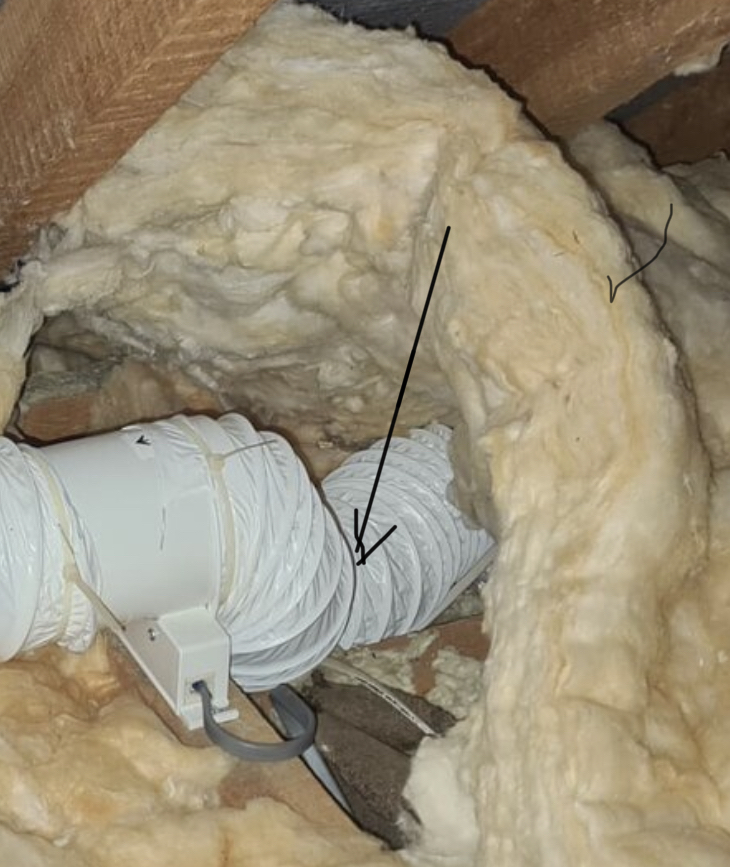

Huge condensation in the bathroom, what to look..? Any tips..?

1. Checked fan, which works fine makes noise when bath light is on and goes off 2-3 minutes after switching off light
Problem 1 it should run for 20 minutes after the light is turned off, better would be one also triggered to run when the humidity is high.

A couple of additional questions ...
1... Is the room kept fairly warm when used? The colder the walls /ceiling / windows etc., the more will moist water condense on it.
2... You mention a window. Does it open and, if so, have you tried opening it whilst someone is having a shower etc.?
Somewhat related to the second question above, flameport's point (3) is important. In my experience, complaints about bathroom extractor fans 'not working adequately' quite often relate to poor ventilation (inadequate opportunity for air to get into the room. If their is no vent/airbrick and/or a substantial gap under the door, it would probably be worth trying leaving the door slightly open when the room was being used (for shower etc.).

1. Ye it is , other day after my teens long shower (its actually a shower in a large bath, not shower cubicle) it was like a steam room ..
2. Window opens to road, so not possible to keep it open
The shower curtain has a chimney effect circulating the moisture around the room. Having either no curtain, or a door which seals either top or bottom with stop the air circulating around the room, so the moisture is retained within the cubical.
I had same problem with a shower in the bath, it circulates the moisture, but with the wet room with no curtain no problem, and in this house with cubical door sealing at bottom no problem.
Right, I thought longer shower curtain will keep stream inside the bath area where all sides are tiled. Are you saying it is better if I keep shower curtain bit lower so that larger gap at the top..? Is that going to reduce condensation ..? Thanks

The duct in your photo seems to show a kink in the duct.
You need as straight as possible duct run. I would change duct to solid rather than expanding type. The internal ridges will slow air flow.
As @flameport days, that cheap weedy fan needs changing for something that works. Those toys are hopeless.
Here’s my recommendation
I am going try to straighten the duct first. I checked duct, no cut anywhere. So planned to keep the same way if possible. Thanks

Ensure that there is a way that air can get into the bath room to replace the air that the fan has extracted. With out that the most powereful fan will be ineffective at removing the humid air.
The replacement air should be from inside the house. Air from outside could be cold enough to cause the humid air in the bathroom to condense to liquid on surfaces,
A gap under the bathroom door is one way to achieve this. Another way is a louvred panel in the door.
I doubt I could make this change..Max could do is keep door opened after shower. Thanks
