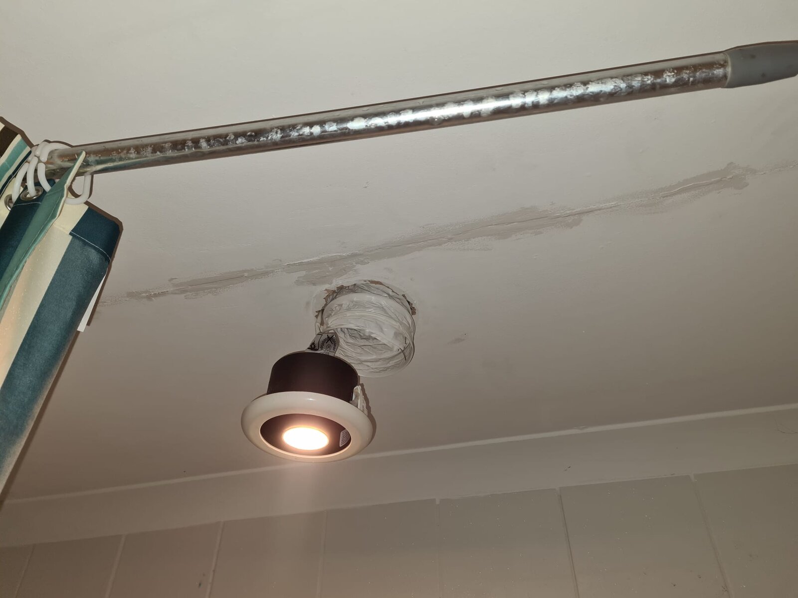

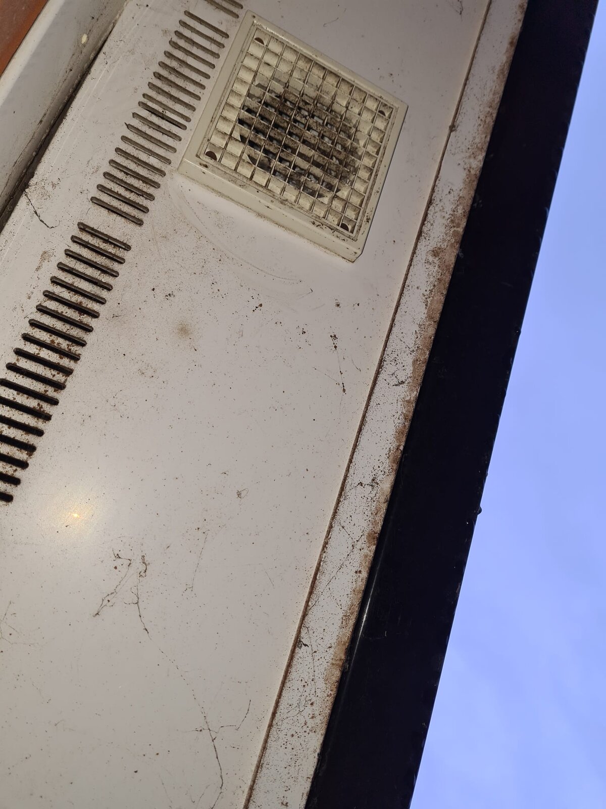

I noticed huge condensation on one of the bathrooms (used by my teenager!). Water actually not just makes wall wet it actually comes as drops near windows and walls. I did all basic checks listed below, all looking good ..
1. Checked fan, which works fine makes noise when bath light is on and goes off 2-3 minutes after switching off light
2. Checked fan while steamy inside and noticed visible hot air exit from fan
3. Checked ducting and seems to be intact, now planned to use tape to ensure duct end covers well with light end
What I could not check are..
1. If fan end is dirty and stop exit or steam (as no access), but from distance I can see hot air exiting
2. Couldn't check for any holes in duct from light end to fan end?

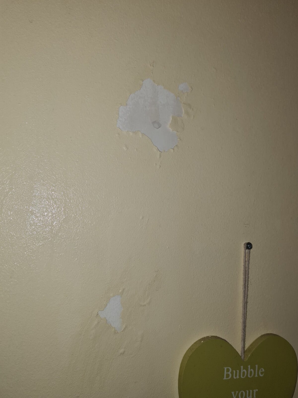

Other doubt I have is about the bathroom paint, its not seems to absorb any water..Is that expected..? Paint seems to be peeling off due to condensation in the bathroom. Not sure if previous owner used wrong paint..?
See some photos..
My other bath is similar aged and similar construction no problem at all. everything is this toilet may be 10 year old.
Any suggestions..? tips..? Thanks
That's how the world works with water vapour and cooler parts.

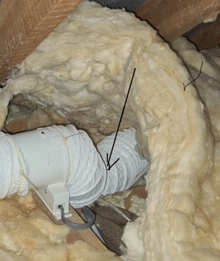

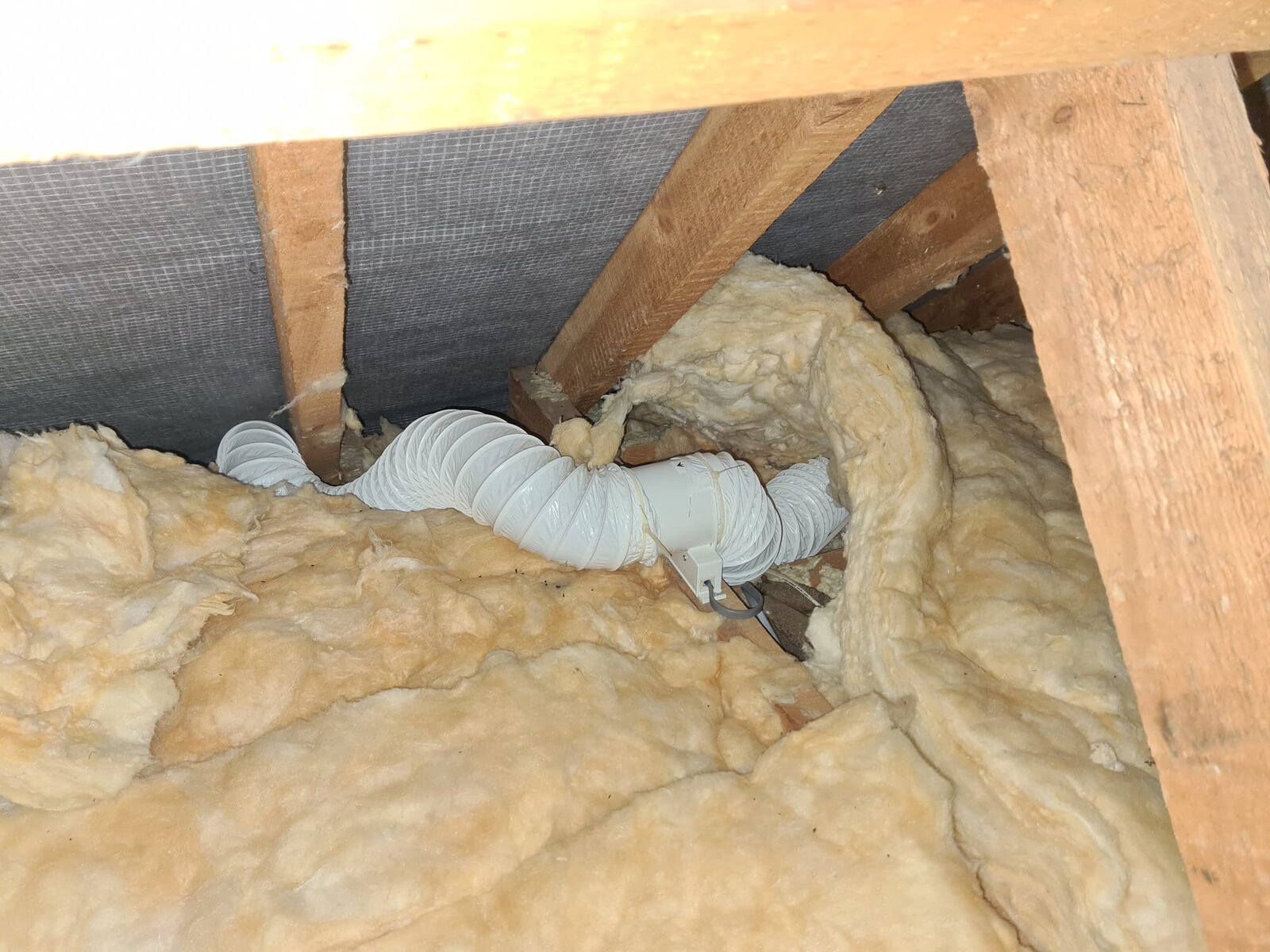

Your have a poor quality fan. A typical cheap builders fan has a throughout nominally around 80 cubic metres per hour. You can easily get three times that. It looks to me like you have a 100mm flexible duct above the ceiling.
Can you photograph the duct and the wiring in the loft?
For the moment, leave the fan running continuously. Cost of electricity is negligible.
Loft pic added , its kit with fan in the middle duct to both ends, one end of duct to bath/shower around light other end to outside. see pic from loft. I can see a white box near fan. How do I change timer..? Thanks

so more power, and longer run time, will both clear more of the damp air out
i don't recognise the one you've got
just leave the light switch on permanently until you can fix or replace it
the way it is installed, it will be easy to fit a better fan
but look for any markings to identify the old one so we can be sure of finding something more powerful.
1 - that fan is the most feeble and underpowered item available and it's probably clogged with gunk as well.
2 - a much more powerful replacement should be obtained and mounted on the beam above, which will significantly reduce the noise it makes.
3 - you must also ensure there is somewhere for air to enter the bathroom such as under the door or via another vent, otherwise no fan will do anything.
Possible replacement: https://www.toolstation.com/airvent-100mm-mixed-flow-inline-extractor-fan/p70282
