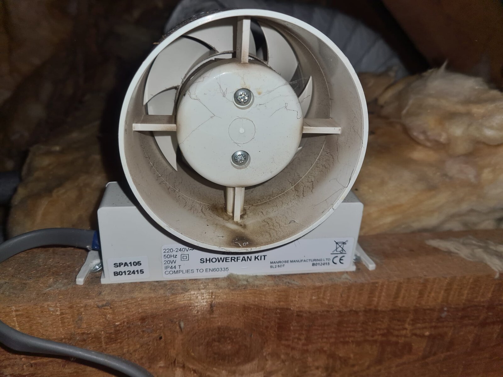

1 - that fan is the most feeble and underpowered item available and it's probably clogged with gunk as well.
2 - a much more powerful replacement should be obtained and mounted on the beam above, which will significantly reduce the noise it makes.
3 - you must also ensure there is somewhere for air to enter the bathroom such as under the door or via another vent, otherwise no fan will do anything.

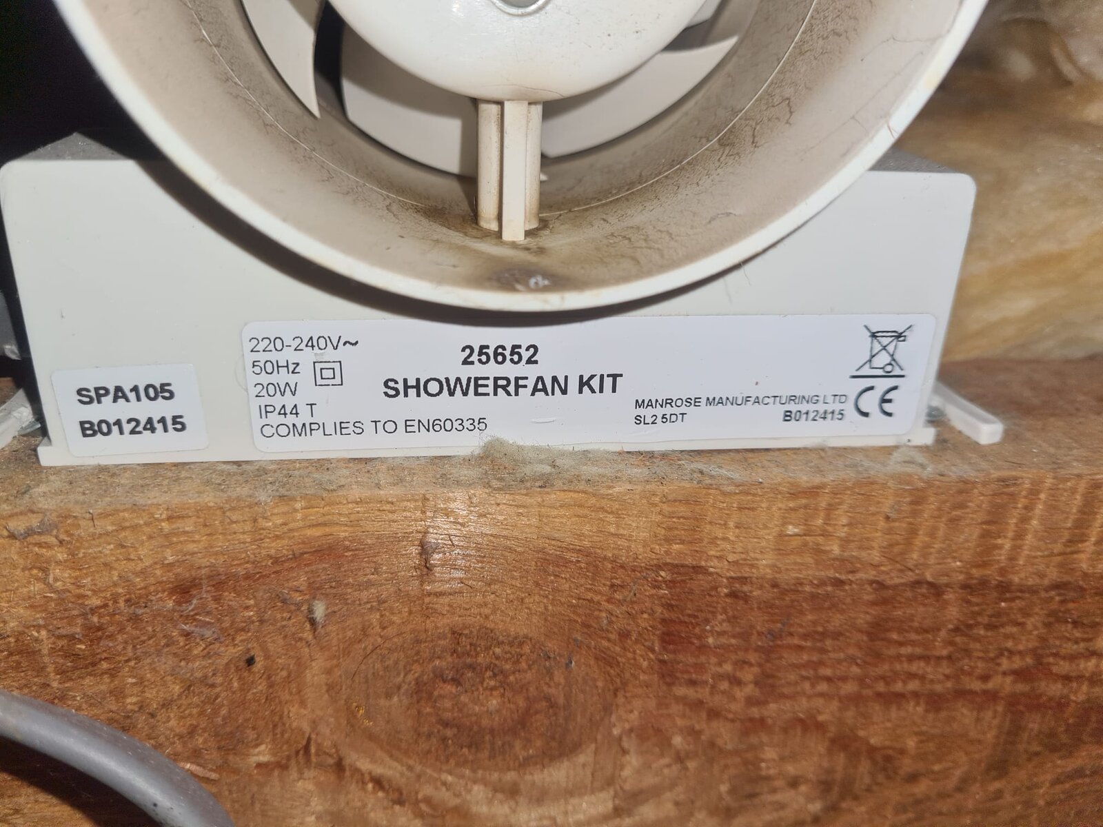

Some more pics of fan after opening it as below. still an't see or know any option to adjust time..
Manrose shower fan kit 25652

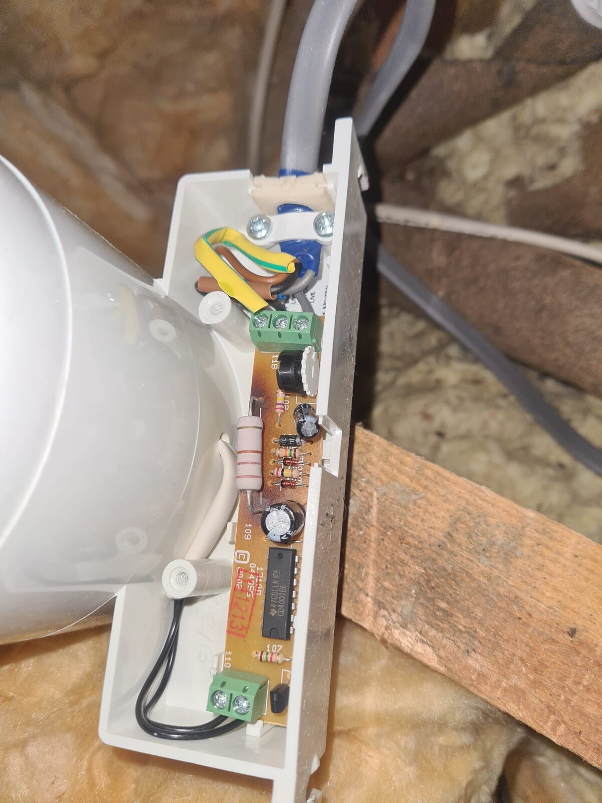

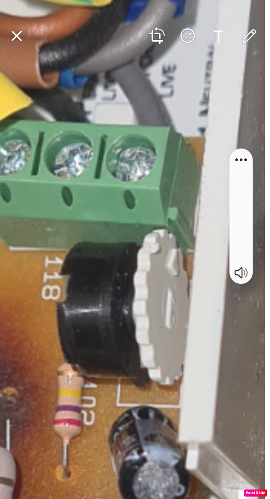

I managed open the fan unit, Black round thing near green connectors is that by any chance timer adjustment>.??
