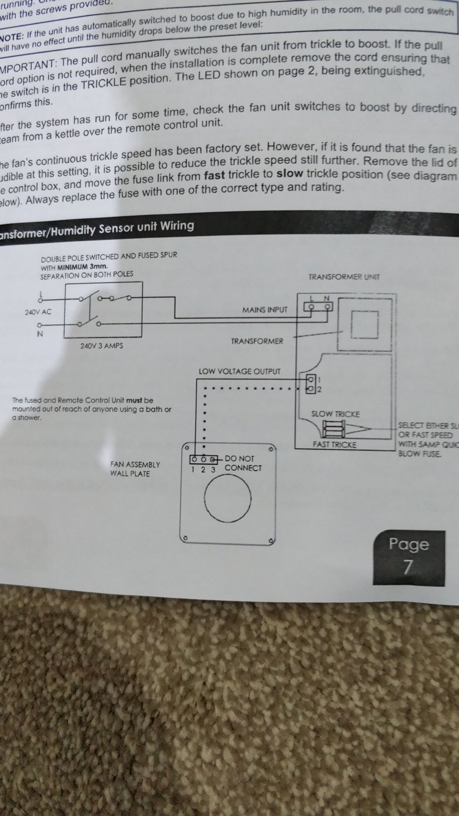

I am try to set up my humidity control in Bathroom
The mains is done from Transformer to socket
I am bit confused with the attached image of fan to Transformer.
It says needs to be low voltage, can I use normal electric cable?
I can see 1 goes to 1 and 2to 2. My confusion is what's the dotted lines for wire 2? Can I use blue wire as 1 and brown as 2?

It would seem in USA they call 12 volt low voltage, it would seem instructions are designed for USA so where it says low voltage read extra low voltage, you can use any colour you want, OK in theory should be over sleeved Violet I think to show extra low voltage, (24 volt) but in real terms it does not matter. So dotted line any colour you like.
