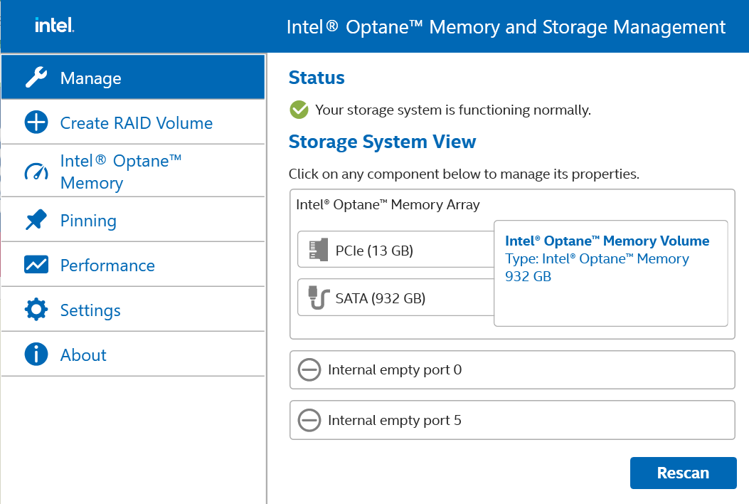

First off, give us a screenshot of the device manager, with the "disk drives" node expanded

Back home now, and.....
HP Pavillion Notebook 4XY78EA#ABU Ser # 5CD90169FZ
System Family / Range:103C_5335KV HP Pavilion
Device name Latest-Laptop
Processor Intel(R) Core(TM) i5-8300H CPU @ 2.30GHz 2.30 GHz
Installed RAM 8.00 GB (7.81 GB usable)
Device ID B638DDBB-D6D9-42C7-9B61-97220108D086
Product ID 00325-81283-40228-AAOEM
System type 64-bit operating system, x64-based processor
Pen and touch No pen or touch input is available for this display
Intel Optane + 932Gb
So a PCI-E card with a nominal 13GB of this fast, non-volatile Optane memory (a specialised SSD) to serve up the most used files dragged off the 1TB (932GB formatted) sata spinny disk. Intel have stopped making Optane as it became uneconomic (I read).
Someone may know more about all this than me... and what is worth doing/not doing and how; as it appears to me that the Optane PCI-E and SATA HDD are currently set up to work together as a single storage volume.

Right, some progress made, and it's not nearly as straight forward because of the Optane memory/SSD, as simply going from HDD, to an SSD.... Though I have so far, just ordered the large SSD, to replace, and fit in place of the Optane PCB.
1. Use Optane RST software, to disable the Optane. Reboot
2. Go into BIOS settings, for the Optane, and disable it there.
3. install SSD pcb, in place of Optane pcb.
4. Boot up
5. Use Macrium Reflect, to clone from HDD, to the new SSD
The final stage, which I have yet to work out how to do - set it to boot from the SSD, as priority.
Wish me luck ;)

My main problem is, selecting what I should clone from the below...
I'm guessing the 16Gb Optane #2, will disappear, once I go through the process of disabling it, but what is the 100Mb #1?
I also wonder what the 687Mb #4 is, might that be for Restore?
I tried to follow my interpretation of the instructions, after my SSD arrived this morning.
Optane disabled, via the Optane windows utility.
I then went into the BIOS settings, and all mentions of the Optane had gone from there, so no chance to disable in there.
Fitted the SSD in place of the Optane, rebooted fine, though desperately slow booting from the HDD.
The SSD failed to show in Explorer, just the HDD, so a bit of panic, until I got the bright idea to run Macrium Reflect, whereupon it showed up. At the moment MR is cloning the HDD, to the SSD.
