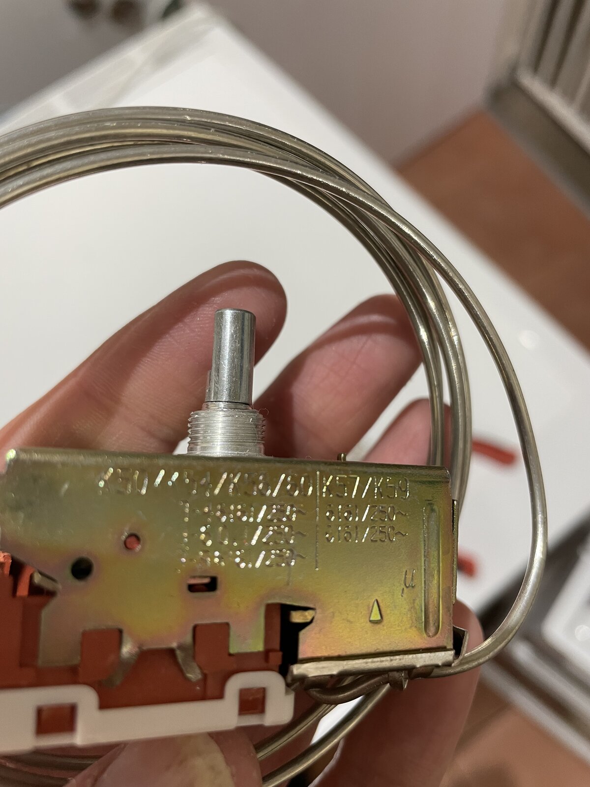

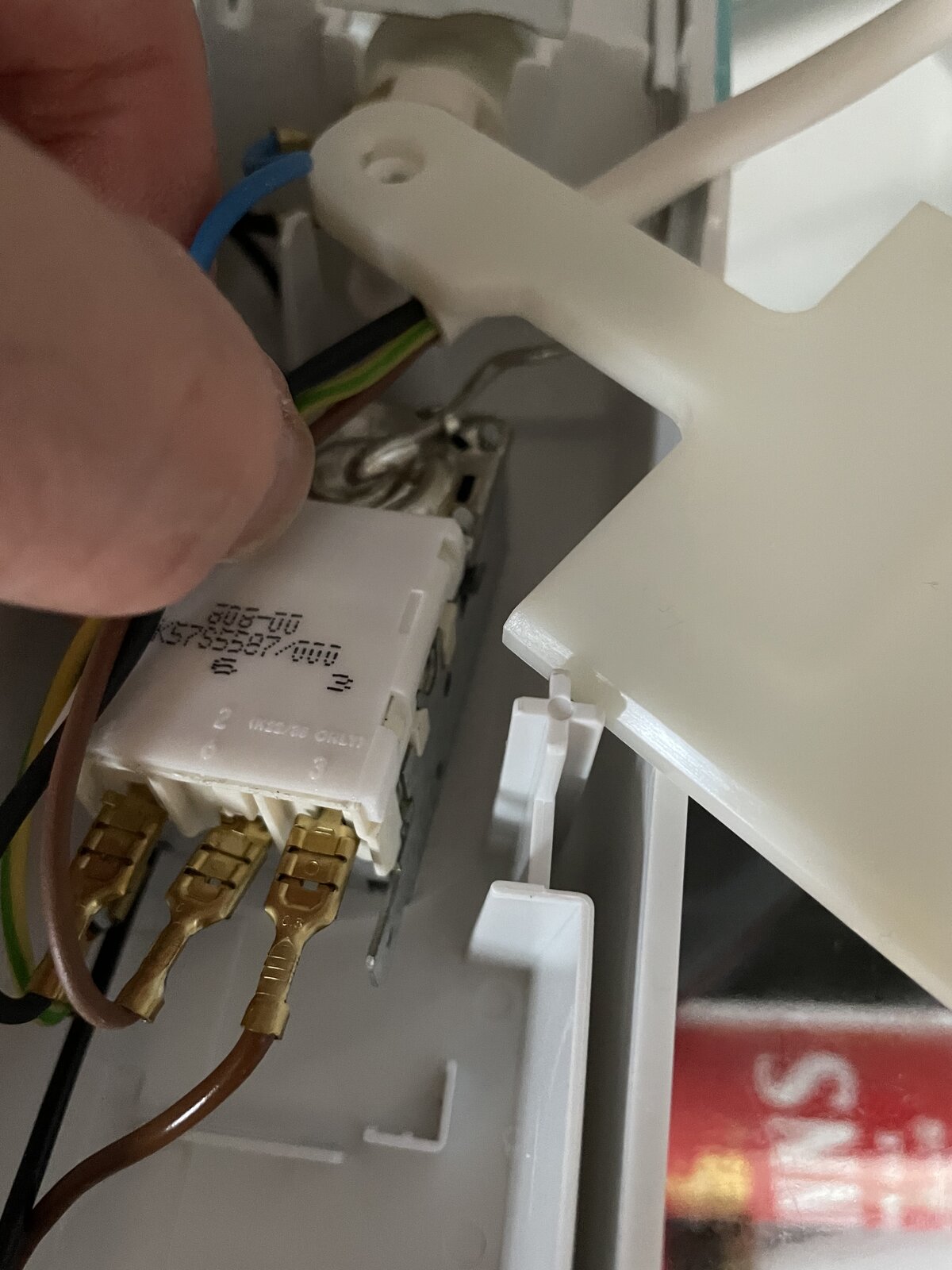

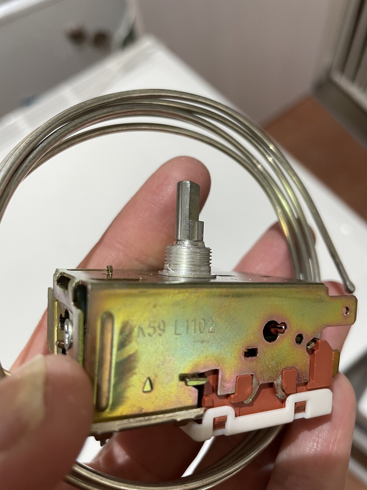

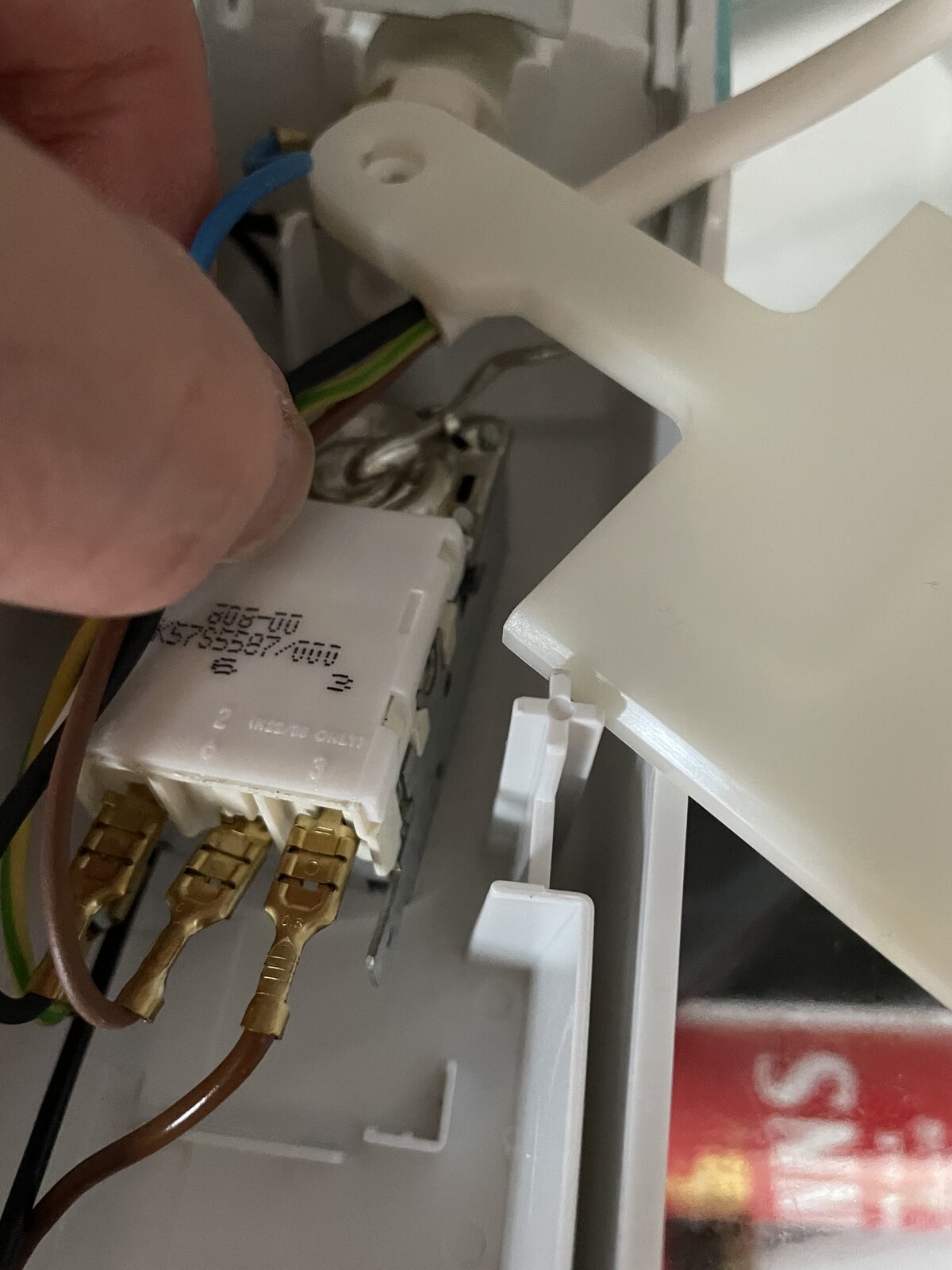

You could open up the temperature control. Although electronic, it may function as an on/off switch, in which case you could meter the connections, and bridge them.
As above just bridge the terminals to force the compressor to kick in. If it starts running, the thermistor, which is cheap, probably needs replacing.
Pull the fridge into the middle of the room. Remove the cover where the temperature dial and light are (whilst the machine is turned off). Remove the spade terminals for the thermistor, bridge it with a scrap of wire. Stand back and listen to see if the compressor (the bit below the black tub thing) kicks in.
If it does, turn the power off, remove the bridge and buy a new thermistor.
My understanding is that it is the most common reason for a fridge not working.
If the compressor doesn't kick in, then yeah, bin the fridge.
To clarify, the compressor will only kick in if the thermistor tells it to. If the thermistor is dead, it will not tell the compressor to kick in.
I don't intend to sound condescending, but... seriously, check the thermistor. It is singularly, the cheapest component to replace.

So I’ve managed to get inside the unit (had to wait for delivery of the right Torx screwdriver). Which two connectors do I need to bridge to test the part (see pic 1).

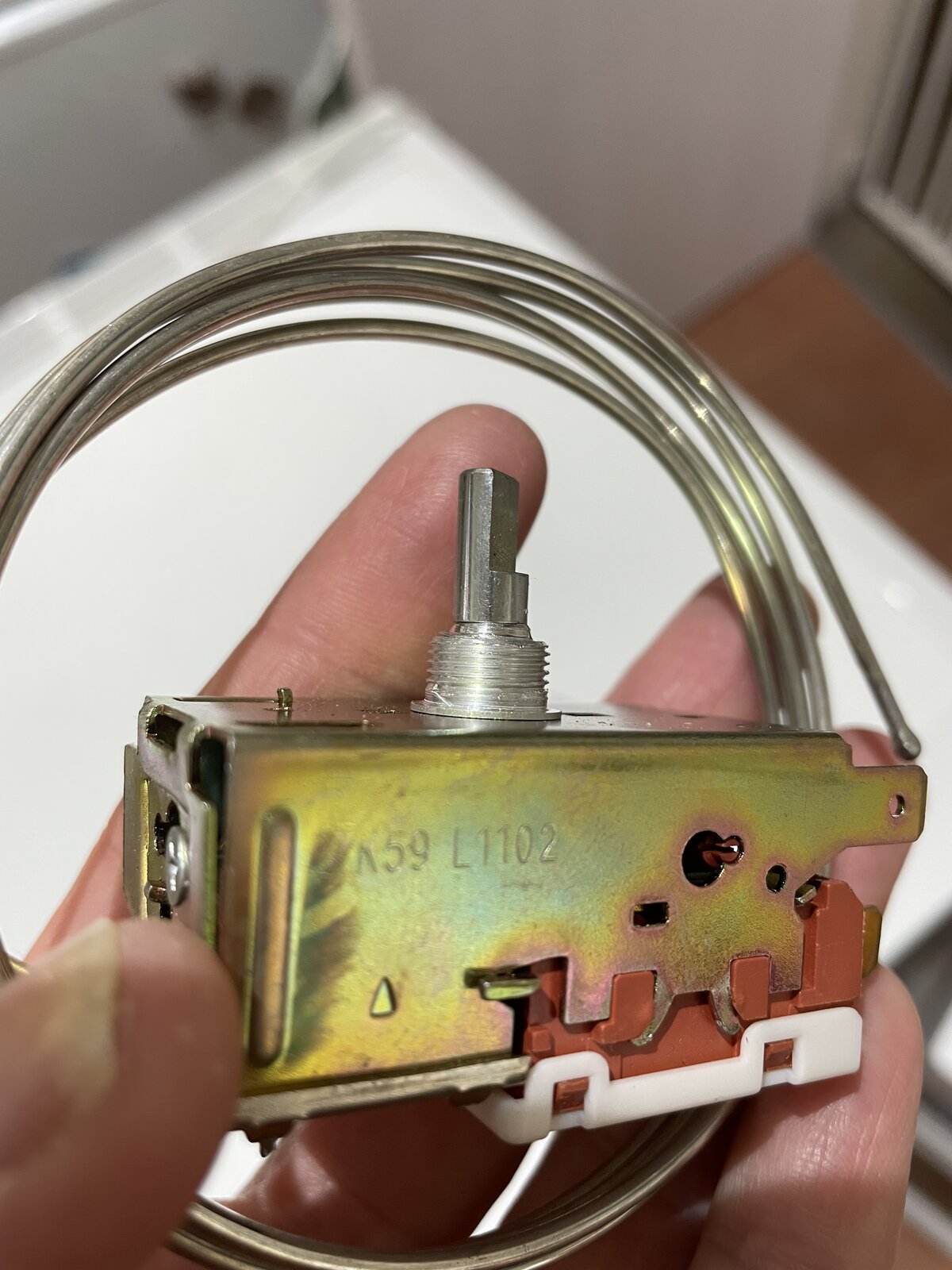

Also I jumped the gun and bought a part online before seeing the part number inside. I bought a K59 and the original says K57, but the on the side of the part I bought it does also list K57. I don’t know if this means it’s also compatible with K57. Does anyone know if it is?
