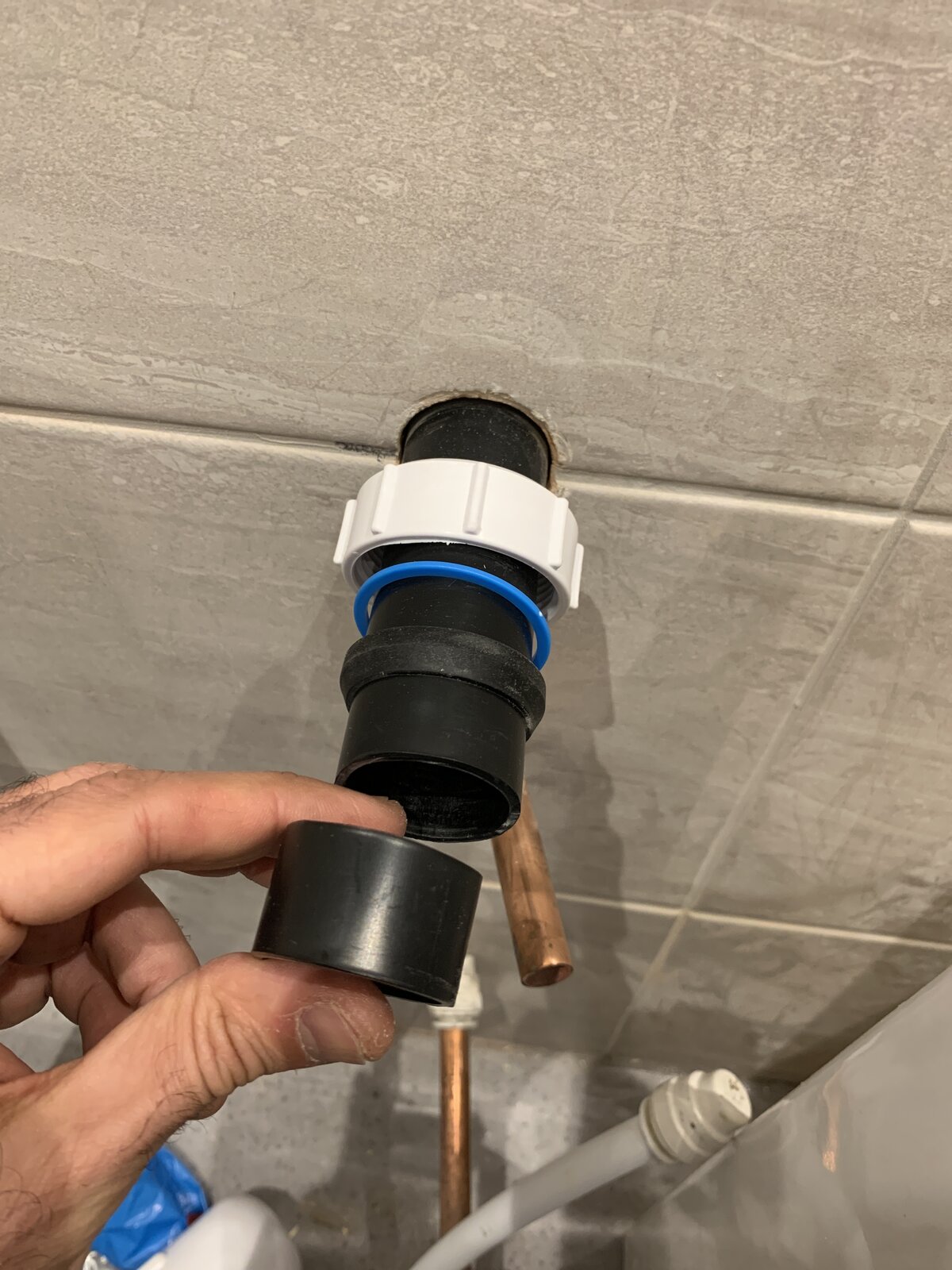

I seem to have cut the 32mm basin waste pipe too short. Is there anything I can do to extend it by 22mm?

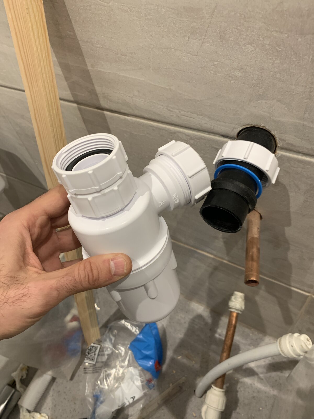

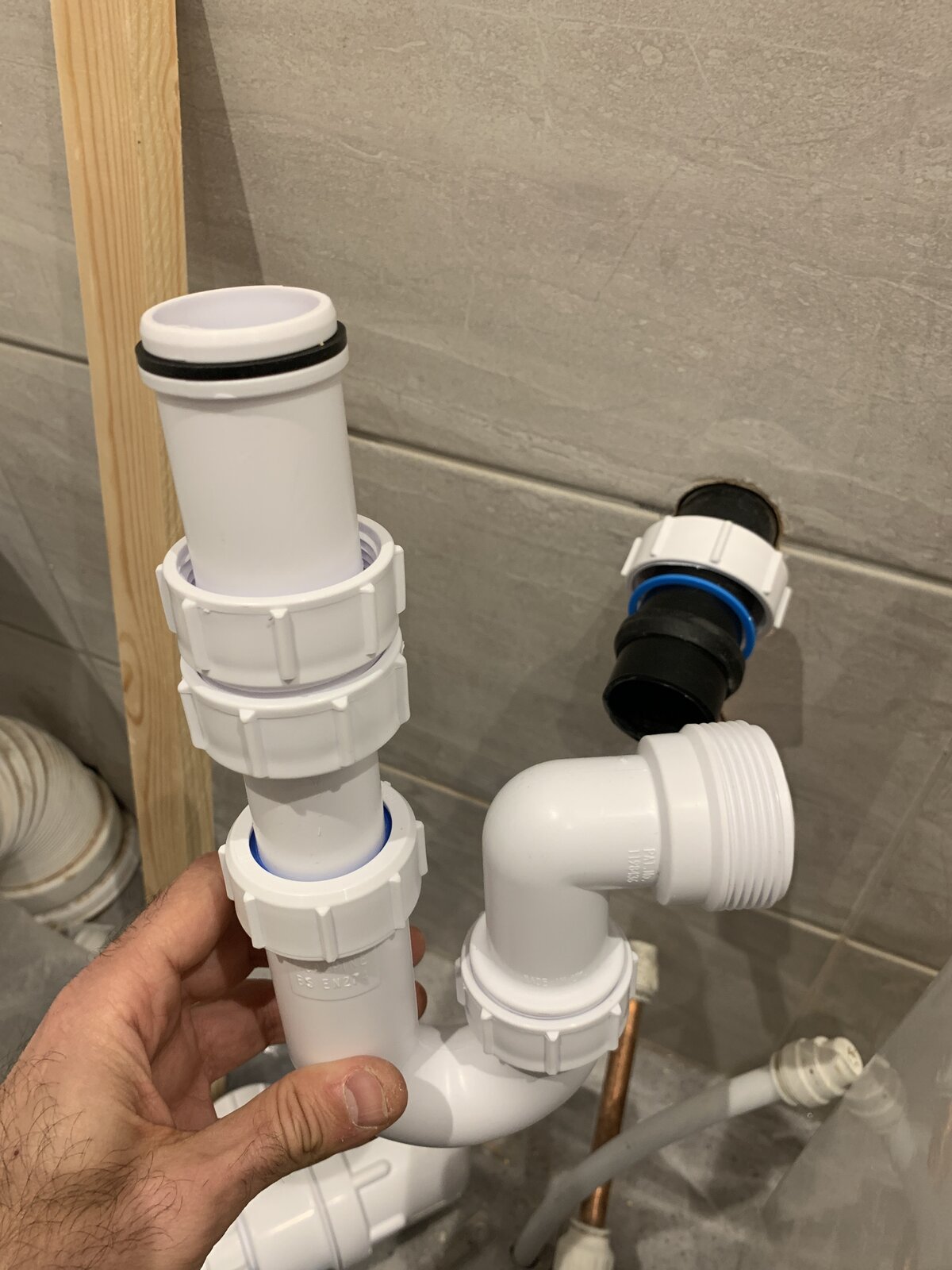

I tried two different traps and they do not fit now I used a p-trap with an extension but the extension now is too long.
The bottle trap was ok before I cut the pipe by a bit but now the in and out depth is out.
How do you extend the pipe by only a bit.

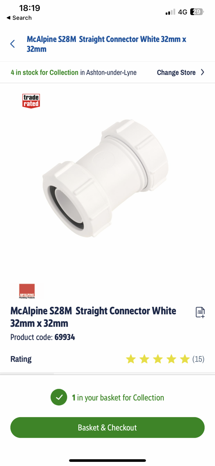

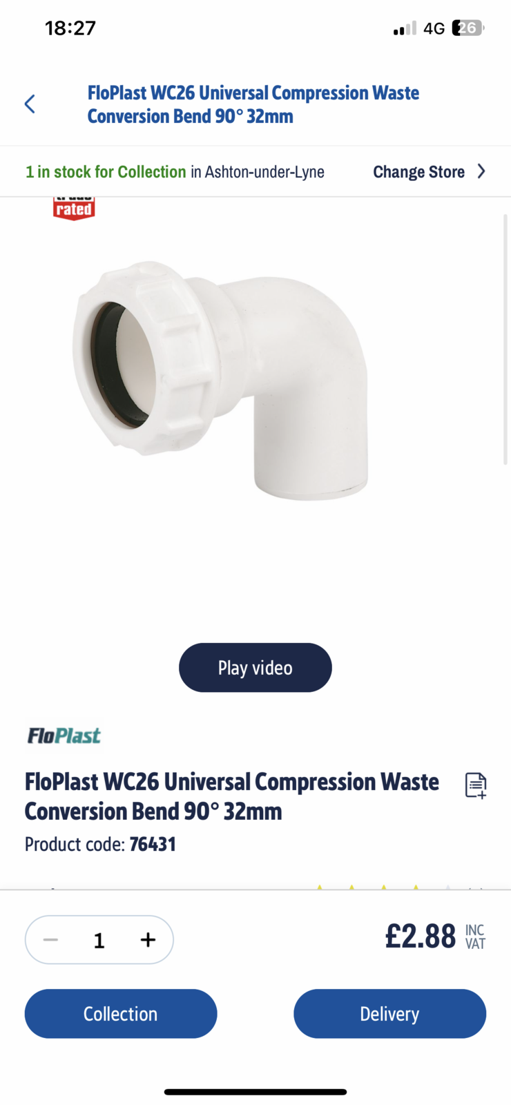

I guess I can cut the pipe shorter and use one of these But does anyone do a compression 32mm to a blank 32mm pipe coupling ? So compression on one side and pipe looking on the other. Something like the Floplast but no bent , straight instead.

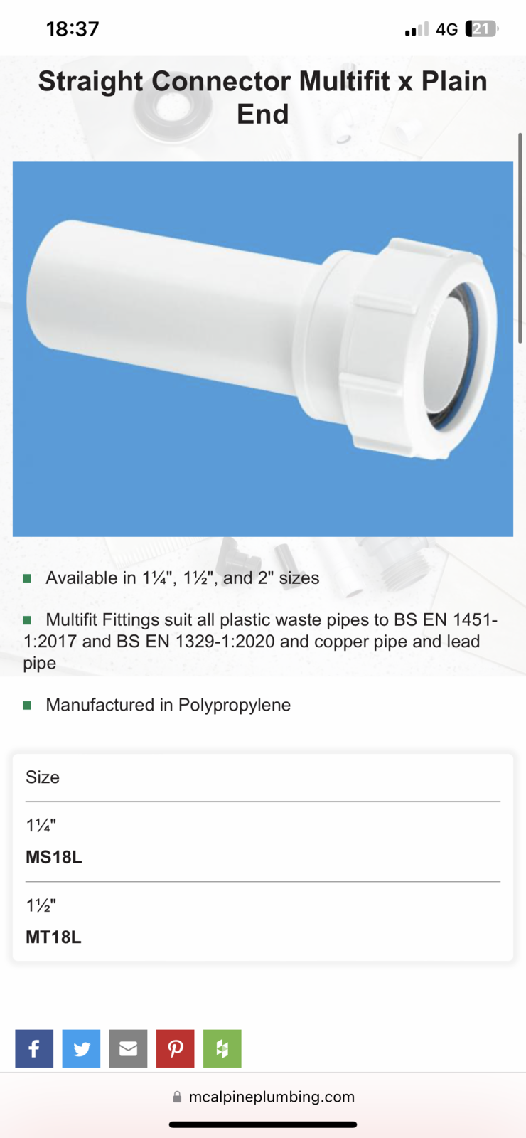

That's awkward, I presume you can't just replace short piece?
Is there room to insert a coupler, and a short piece of pipe?
Maybe try and search for a M/F coupler equal sizes fit trap onto male end.
Thank you both, you got me in the right direction I think I might try this one :
