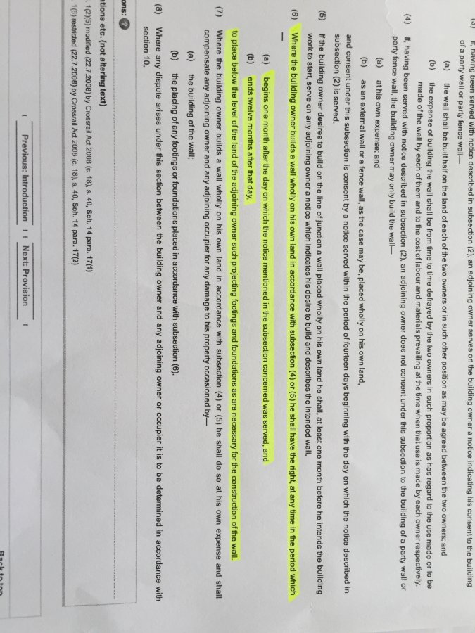

Just for the sake of clarity you can only go ahead with work if you have served notice and the neighbour has written back and agreed. If you hear nothing from them after 14 days they have dissented and then you have to get surveyors and do the award. He can't stop the work but he can appoint a surveyor to look after his interests.
For the purposes of the discussion between me and Woody, No. Under Section 1, Line of Junction and foundation on neighbour's land, you serve the notice and proceed, neighbour cannot object or dissent. For all other PWA works, Yes you are correct.

There is no provision under section 1 for the adjoining owner to dissent (except 1(2) obviously, building on the boundary) so how can you have a "deemed dispute".
What are they disputing?
I haven't read the Act itself so am only going off the explanatory booklet.
Curiously there is nothing mentioned in it about the situation that is very common, when someone wants to put a wall a few cm inside the boundary but foundations will go over the boundary. I think this is the situation you hare talking about hopefully.
I still don't understand why you can't dissent in that case though because the whole purpose of the act was to encourage the right to dissent so that should a dispute occur costs for both parties are kept down.
Also if there is no agreement from the neighbour why isn't it a trespass???
That goes back to my original point. I was taught many many years ago that there is legislation somewhere that gives a homeowner the right to place concrete foundations across a boundary. Hence the PWA allows it and specifically prevents the adjoining owner from objecting.

I'm in the middle of gathering information on this and this is all I can find in the regulations. It seems to controdict itself, on one hand I have the right, on the other a dispute is determined via section 10.
