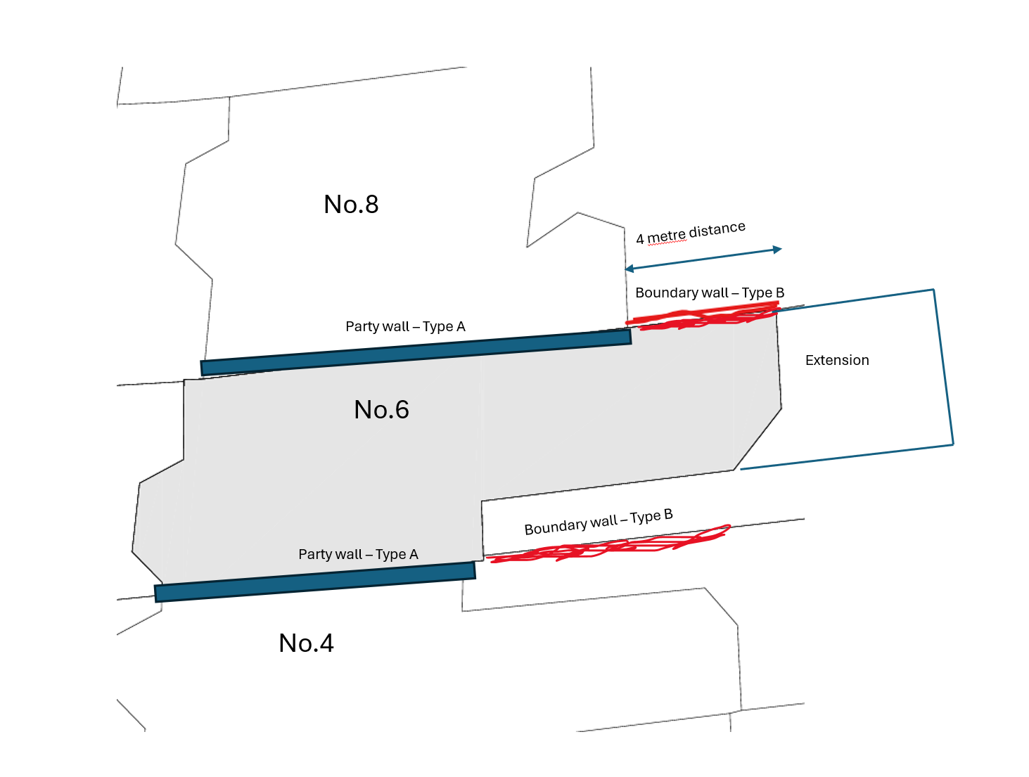

The idea that he wants to designate the wall as a party wall for the duration of the works is complete nonsense. It can only be a Type A party wall and only if it sits astride the boundary. The position of the boundary can usually be determined by the physical characteristics of the building such as was it built as a continuation of the party wall separating the two buildings or was one property added later, existing boundary features such as fences and the title plan with the deeds. The drawing provided shows the existing wall sitting inside the boundary not astride it although this may be misleading but the fact that the new extension has been set back suggests that the boundary may run along the middle of the existing wall.

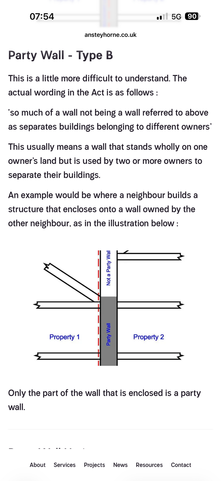

That's not how it works. The Party Wall Award is driven by the Building Owners surveyor, the adjoining owner's surveyor usually just has a watching brief to check and agree what the building owners surveyor is doing. Earlier you said that you had your own surveyor or are you in fact both using the same surveyor as an "agreed surveyor"? I did think it was odd that the adjoining owners surveyor was doing the condition survey, that is most irregular unless you or your surveyor specifically agreed to it.The neighbour on the bottom image is having a PWA drawn up by a second surveyor. That’s fine. But that surveyor has given advice to the other neighbour saying the wall is a type A not type B wall. And said that even awarding the PWA doesn’t mean change the determination. But it is or isn’t a party wall, it cannot be transient.
This is what Blup has said and is my point also. Want an award, update the paperwork.Its either a party wall or it is isn't, the surveyor can temporarily contract the parties out by agreement
